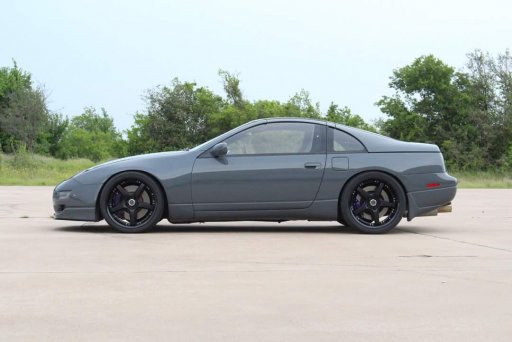

    I will admit that I don't have as much experience in the offroading/overlanding world as I would like to. I have come from another world, as my previous build was a 1990 300ZX with an LS3 swap, an ultimate street and track build (picture attached). However the new rig will be much better suited to having fun in the PNW and beyond. I look forward to gaining experience and learning as time goes on.

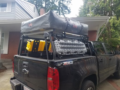

    Purchased (some pieces not installed):
    - Method Grids Black (6)
    - Falken AT3W 35x12.5x17 (6)
    - Baja Kits +2 Prerunner Kit this kit includes our boxed upper and lower arms, custom heat treated axles, grade 9 hardware kit, extended brake lines and steering extension
    - Baja Kits Frame Side Bypass Mount
    - Custom King 2.5 Coilovers
    - Custom King 2.5 Bypass
    - Baja Kits Spring Under Kit
    - Deaver Springs
    - Baja Kits Bump stop Kit
    - King 2.5 Bump stops
    - King 2.5 rear shock
    - King 2 Tube Bypass
    - Fiberwerx front and rear fenders with bumper caps
    - All In Trucks Tune and dsp4 switch
    - ProFab intake and intercooler pipes
    - FloPro Aluminized Exhaust
    - Leitner rack
    - Leitner MaxTrax mount
    - Leitner MaxTrax pins
    - (2) MaxTrax pair grey
    - (2) Leitner Rotopax mounting plate
    - (3) Diesel 2 gal Rotopax
    - Water 2 gal Rotopax
    - (2) Rotopax extensions
    - (2) Rotopax lock mount
    - Leitner HiLift bracket
    - HiLift Jack Extreme
    - Leitner RTT mounts
    - (4) Leitner light mounts (for bar or pods)
    - Fire extinguisher
    - Camp Chef 2 Burner Camp stove with bag and hose adapter
    - 2 Gallon propane tank
    - (4) Camping chairs
    - Folding table
    - Lighter

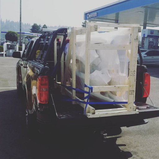

    20604667_1837502166265126_6736105627260977040_n.jpg 20543941_1837565249592151_8915652237687234520_o.jpg I received my Fiberwerx front fenders, bumper caps and rear fenders in today

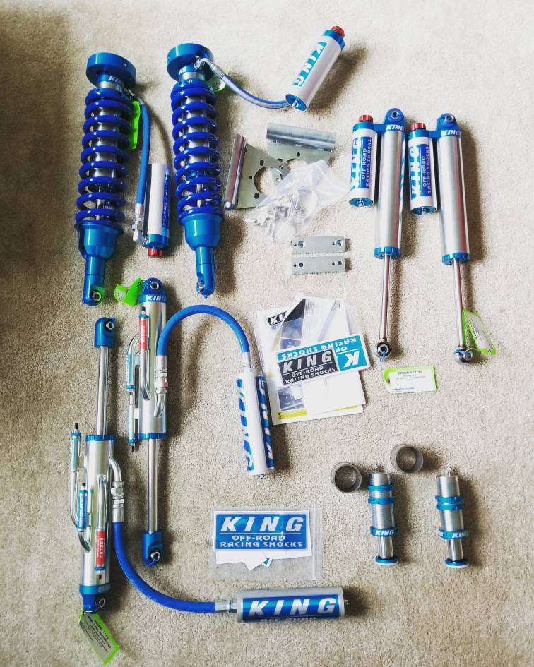

    Got my Kings in today. Just need the front bypass mounts, rear spring under kit and bump stop mount.

    Hey I stoked to see where you're build goes but I'm afraid that you're not going to have enough rear shock if you plan on running any high speed stuff. Based on the above setup your front is going to way out perform the rear which is going to cause it to donkey kick quite dramatically which can be dangerous.
  12. Sonny Marton
    Sonny Marton Rank II
    Location:
    Greater Seattle/PNW
    Map
    It will be a spring under setup in the rear so I will have a little more travel than stock, just waiting on the Deaver stuff to get here. Eventually I'll go to a bed cage, as I thought the same thing about the rear kick.

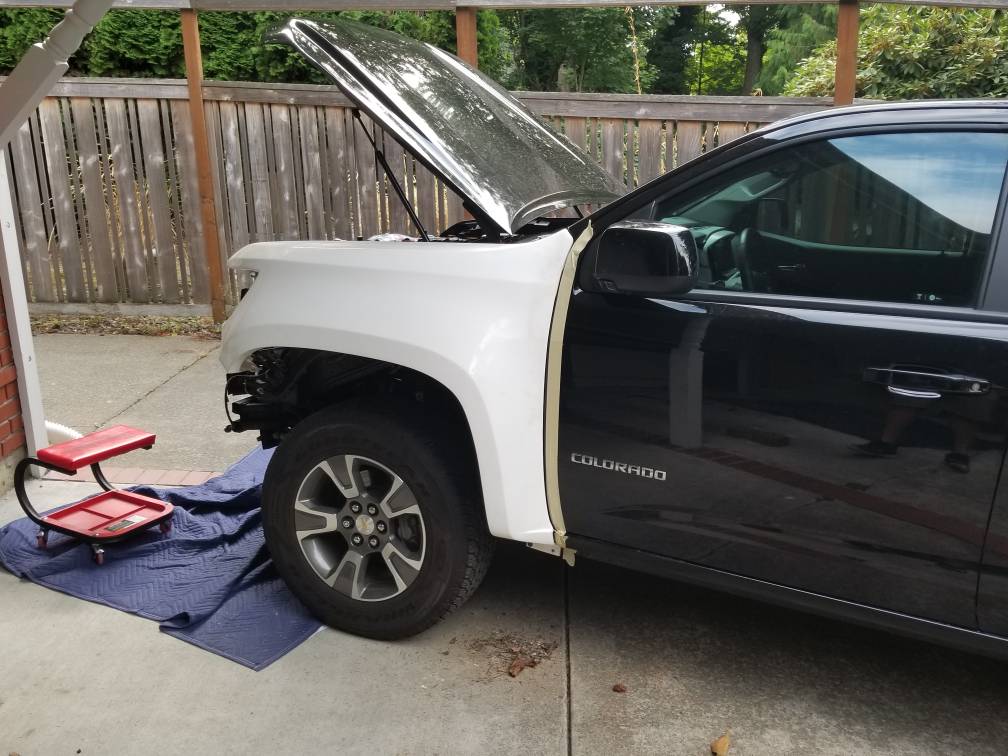

    Fenders are on but need to do final fitment. Hope to get the front suspension installed tomorrow.
