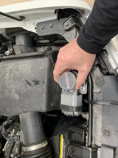

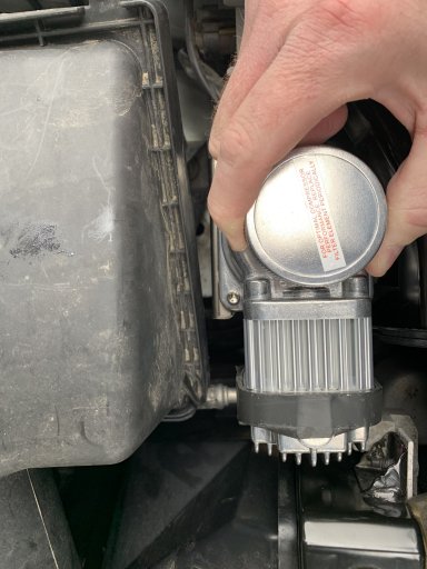

I decided to hard-mount my Viair 400P compressor instead of leaving it portable. The question I have is, how much space do I need to leave around the compressor for heat? I asked Viair, and they just said “keep compressor away from anything that should not get hot”. Gee, thanks Viair!
I want to mount it between my headlight and air box, which leaves about 1” of clearance around the compressor. Is this enough room to not melt my air box and headlight housing? I’d think so, but don’t want to learn the hard way!

I think that's actually a valid suggestion from ViAir; far too many scenarios and environments and air-flow possibilities for them to say simply 3" from all surfaces, for example.
Experience with my ViAir and ARB compressors is that where you show it in your images should be fine. Those fins are on the compressor to help heat dissipate and keep the hotter surface from being in direct contact with another surfaces.
Install it there, leave the hood up, and run it a good bit and see what the temps are on adjacent surfaces. By touch is usually sufficient. If concerned, use an infrared thermometer gun. I bought one a couple years back to use just for things like this and have found it really handy to have. I keep it with me in the van when traveling. They range in price from $18-19 up to $80 or more. If considering one, be sure it is more for industrial/automotive/etc not just reading foreheads.
I'd keep your hood open when running it if at all concerned or if it seems to run too hot for your comfort.
Good luck with it. Let us know what you find so others can use the info, too.

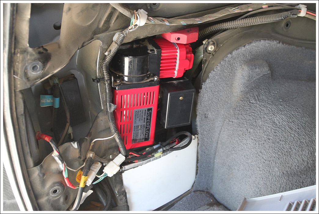

I can't speak to the Viair, but I've had a MV50 "wedged" into the back of my 4Runner for about 10 years and have had no problems with heat.
To reduce noise I added some Rammat (like Dynomat) to the exterior panel. This also reduces heat transfer.
And I added a thin piece of closed cell foam to the compressor head to reduce vibrations. This has not melted, even after heavy use.

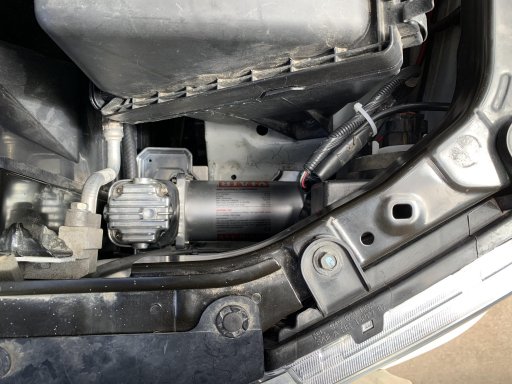

I started mounting it last night. Since I won’t be needing the on/off switch that comes mounted on the 400P, I took that end cap off and it reduced the length by 2”, so now it will fit in that spot it it’s proper orientation. I had to take the airbox, headlight and inner fender well off, then loosen the front bumper to gain access to everything, but it’s coming along. I’ll post a pic later. Thanks for the advice!

My Viair is mounted in the rear quarter panel similar to @slomatt . The difference being, I have more room around it for cooling. I have a wire loom about two inch's from the compressor and heat shielded the wiring just because. The compressor gets hot but doesn't seem to run hotter than normal. It's been there for close to four years with no issues yet. I chose not to mount it in the engine compartment due to dust and moisture.
