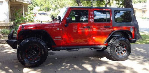

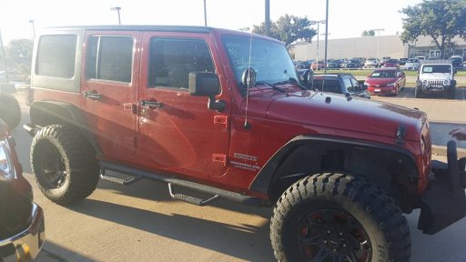

This is how she looked when I first saw her (photo from the dealership after our test drive):
It already had bumpers and side steps, a small lift (spacers), flat fenders, updgraded tailgate support, 5 aluminum wheels, and a couple of lights.
I signed the paperwork and picked her up after they had a chance to detail her. This is probably the last time she will look this nice:

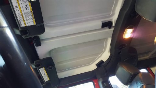

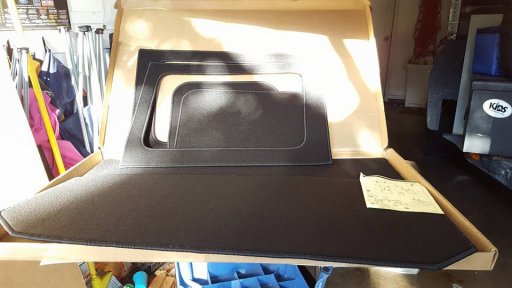

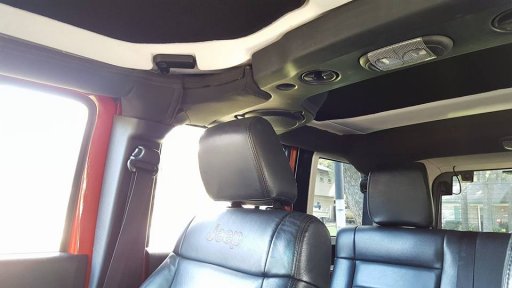

Because I bought this in the summer, I immediatly noticed the effect of the sun beating down on the hard top and the heat that radiated from it. There is also bit of cabin boom with all of the flat fiberglass surfaces, so I decided to add the Mopar headliner kit. Installation is pretty easy, just clean the surface and it sticks on with 3m tape.
The set comes with 6 pieces, two for the front 'Freedom' panels, one for the middle row, one for the rear roof, and both sides.
Unboxing and getting ready:
Couple of before shots:
Install is pretty easy, but you do have to remove the soundbar and get around the roll bars in the rear:
And finally, the results:

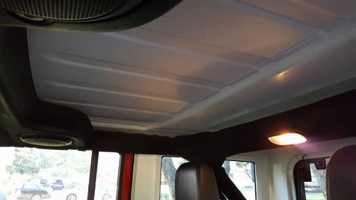

Last two 'after' pics:
Overall I am happy with the change. It has reduced cabin noise, helps with the direct sunlight radiating through the top, and even looks pretty good.

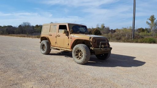

Within a couple weeks of buying her I took her out to a local offroad park to get her a little dirty and get comfortable handling her offroad.
Ok, mayby a couple of bombs though the mud puddles too.. :D
Keep in mind, this was an offroad park. I do follow tread lightly principles on public trails!

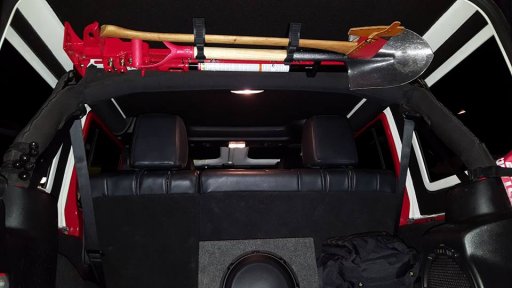

Above the action packers I installed a highlift carrier with accessory mount to hold an axe and shovel. I like that it keeps them inside, protected from the weather, and keeps the look a little more descreet.

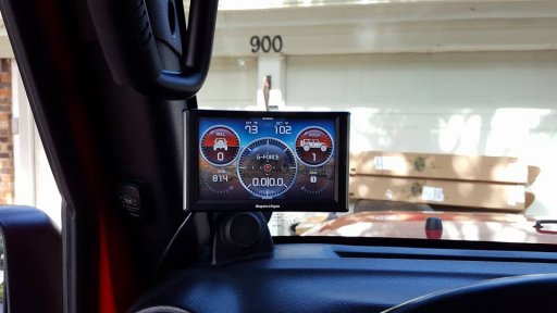

I also added a Traildash 2 tuner, which has a lot of awesome features other than just pepping up the engine tune:

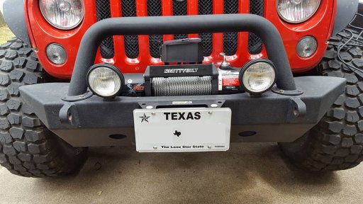

As posted in the 'What have you done with your rig' thread, the winch went on yesterday! It's a Smittybilt XRC 9500 lb. Not the top of the line but gets good reviews and was kind to my budget. :D
Clip on plate mount to keep it legal in Texas:
Reactions: dj_mccomas

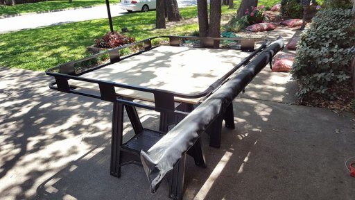

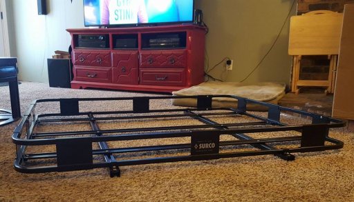

I bought a Surco Safari Roof rack from Quadratec, which I received Friday. They neglected to send the mounts for my hard top, so I'll have to wait for those. In the mean time I needed to make some adjustments for my use..
Here is the basket and cross bars assembled. This will cover the rear cargo area and second row of the Jeep (not full length). I did not get the optional 'flooring kit', which were more slats (for $200), but my wife come up with an idea for that.

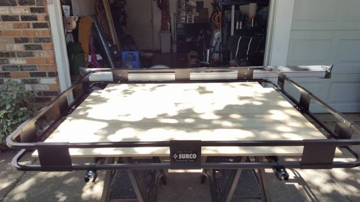

I've had a nice piece of birch plywood in the garage for a few years and my wife suggested I use that to make a 'floor' for the basket. Good idea!
So I measured it out to leave a gap around the edges (more tie down options) and cut it to size. I then measured out and drilled some mounting holes to attach it to the basket, transcribed that hole pattern to the basket slats, and drilled the slats out to match.
I also drilled out mounting holes for my CVT awning, which will go on the rack for trips but not around town.
The holes all line up perfectly, I just need to buy a few more nut and bolt sets, and some roll on bedliner paint to protect the plywood!

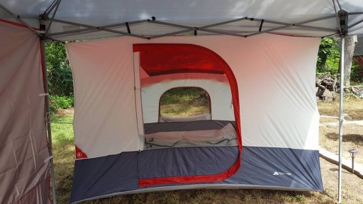

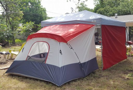

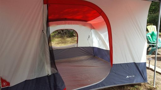

My wife and are now primarily hammock campers, but that is not always possible due to the availability of trees. We're going to SW Colorado in a few weeks and will need a backup tent. We have a RTT but I don't want to install it on the Jeep (it's on my trailer now). And we will not be bringing the trailer on this trip.
Walmart had these canopy add-on tents for $40 and they started my gears turning. We will already be bringing our canopy, regardless of if we hammock camp, because it often rains up there and that gives us the ability to still sit outside and enjoy the views. I picked one up yesterday, and tried it out in the back yard today.
Excuse the little messes in the yard, we're in the process of redoing the whole thing, and are not quite done.
The tent sets up easy. It has one pole, two stakes and otherwise is supported by the canopy. It's worth noting, I will need to stake down the canopy but didn't for this test. Staking it down will take care of the slight tweaking from the pressure of the tent.
The footprint of the tent is 9'x7', plenty of room for my wife and I.

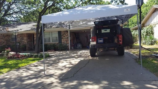

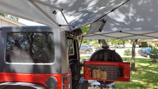

Then I started thinking about the height of the canopy and the Jeep, and wondered if I could back the Jeep up to the canopy in such a way that I could combine all of the covered space, and get the rear of the Jeep under the canopy so I can use the tailgate table and rear as the 'kitchen'. I sketched out a couple of ideas and came up with this.. Excuse the crudity, it's not to scale. :p
The top right is the Jeep, of course, and to it's left is my CVT awning. Below the Jeep is the 10x10 with the wall at the bottom, and the tent on the right. This makes a pretty cool little basecamp and by my calculations, give me a total of ~200 sq ft covered! This is meant as a basecamp set, so when we're ready to go explore for the day, we can just roll up the Jeep awning and drive away.
But I wasn't sure if it would fit with the Jeep, so I dragged the canopy out front to test it out.
