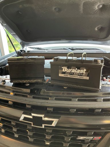

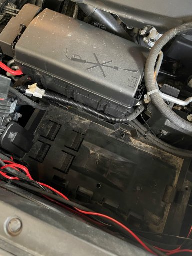

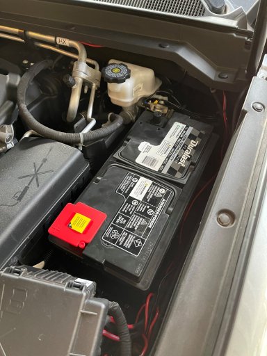

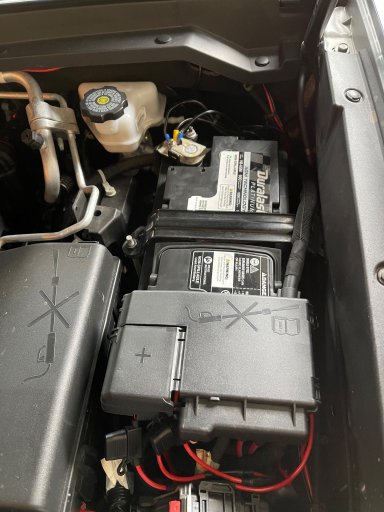

For my fellow Gen 2 Chevy Colorado Owners I wanted to share a low cost alternative to installing a dual battery system. Because the Colorado comes in both a diesel and a gas model, and GM likes to use the same parts as often as possible; the battery tray in the gas model is large enough to accommodate the massive H8 battery required for the diesel. This being the case you can run down to your local auto parts store and pick up an H8-AGM battery and just drop it in your rig with no fuss and zero modification. The H8-AGM I selected has 95 amp hrs, compared to the 70 amp hrs of the OEM battery. This is significantly more capacity over the OEM for 200 bucks and 5 min's of effort. While it is a heavy beast of a battery it is still lighter than 2 (or roughly the same weight at most) batteries and works like a charm. I have been running this setup for about 6 weeks now and no issues. It runs my fridge, tent lights, awning lights, etc. I have 100 watts of solar charging it when I can but even without it I have noticed a real positive gain on the volt meter thanks to this simple and (relatively) inexpensive upgrade.

I installed that same Duralast last spring. Been involved with a few online discussions about the so called charging profiles for gas vs diesel engine/battery (LA vs AGM). The automotive AGM is a lead acid battery with the acid solidified in the matting inside the battery.
I have yet to find any info FROM GM about the different charging profile. Many online sites talk about the different charging rates the AGM needs or it well fail, most these are for deep cycle or "house" batteries.
I have "smart" battery charger, a "smart" battery tester. The tester tells me I'm at 86-90% SOC (state of charge) and 90-92 SOH (state of health) in my normal daily driving, mostly short trips of 10 miles or less. My typical battery voltage after sitting overnight is in the 12.7-12.8 range, my cranking voltage is generally 11.2 V.
The Colorado is a smart charging system controlled by the BCM and ECM. It is normal to see 15.1V after startup, dropping to 14.8-14.2. If tyou drive long enough it drops to 13.8-13.4 and finally after a hour or so it drops to 12.8. There are 5 or more "modes" for charging, you can find this info online. We have a "battery sensor" on the Neg battery cable that monitors the battery and sends this info to the BCM.
I did notice that my displayed charging voltages are different with the AGM vs LA battery. If I put my AGM charger on the truck it takes about 3 hours for it to push that last 10% charge in to the battery. I haven't done a straight 3 hour drive since installing but I think that would bring me close to the 100% SOC.
Time well tell if these AGM's well survive in out trucks, several owners are on year 3.
