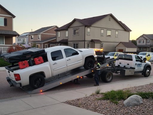

How many Chevy owners out there have had to deal with the Active Fuel Management systems lifter failure?
If what your saying is what I think your talking about, there are some You-Tube videos on that issue. It seems GM has upgraded their repair policy from fixing the lifter and related damage, to fixing that side of the engine bank (upgrading parts), to repairing all 8 cylinders (replacement parts-non damaged) while in for the initial repair. A wise derision considering how there is little to no warning a failure is about to happen. Expensive on the front side, but cheaper than full engine replacement. With the cost on new vehicles, having a engine waiting to grenade, while practically just off the dealers lot is just sad.:coldsweat: I saw a video of a truck with less than 5000 miles on it drop a lifter, and what it did to the cylinder and piston. Knowing the debris floating around causing possible future damage is just unacceptable. Imagine the cost of repair when it goes out of warranty:anguished:.

Yea, it's just crazy. So obviously mine is out of warranty. One of the places I'm looking at getting an engine from sells a rebuild with the AFM delete already done. It's about $900 more than an OEM rebuilt motor but you never have to worry about dealing with it again. I'm leaning heavily that direction. I know I could possibly get by with just replacing the lifters granted it didn't jack up more inside of the motor, for a lot less money but I would never trust it out on the trail ever again. I'm usually one rig and have my family with me and that would just stress me out, constantly.

Damage is done guys. I have a new engine ordered already with the AFM delete already done to it! I'm excited. Even tho it's costing me a ton of money I think this is my best course of action.
