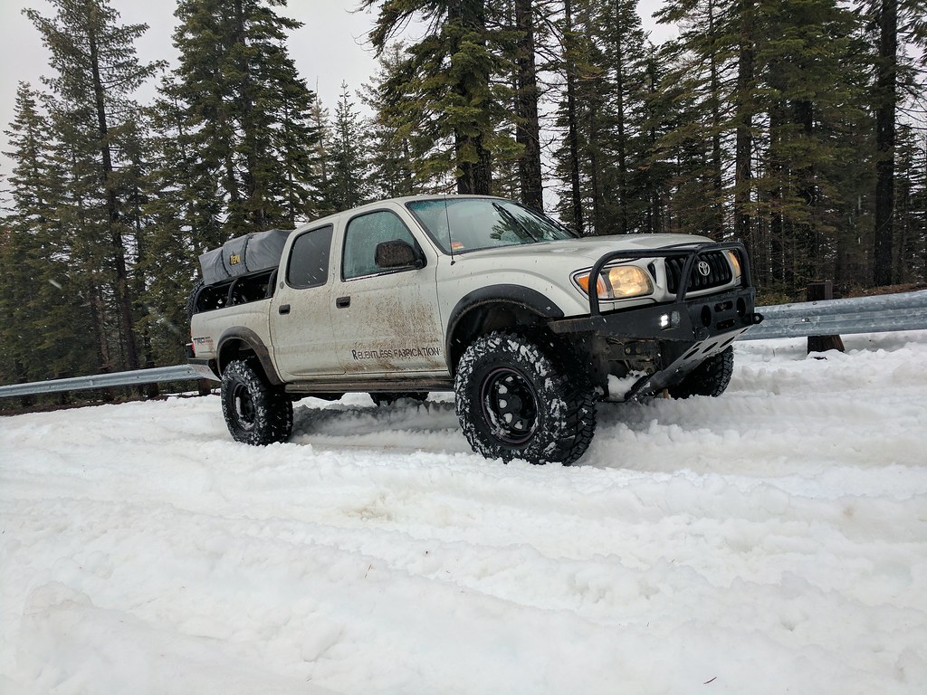

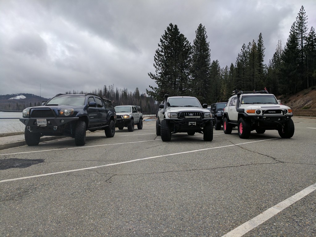

Picture from:08/11/2018

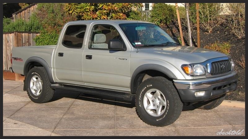

And this is where it all started. Completely stock, very clean and 222,XXX miles on it.
Photo from January 5th, 2014.

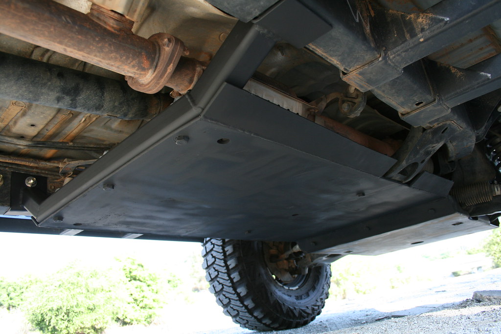

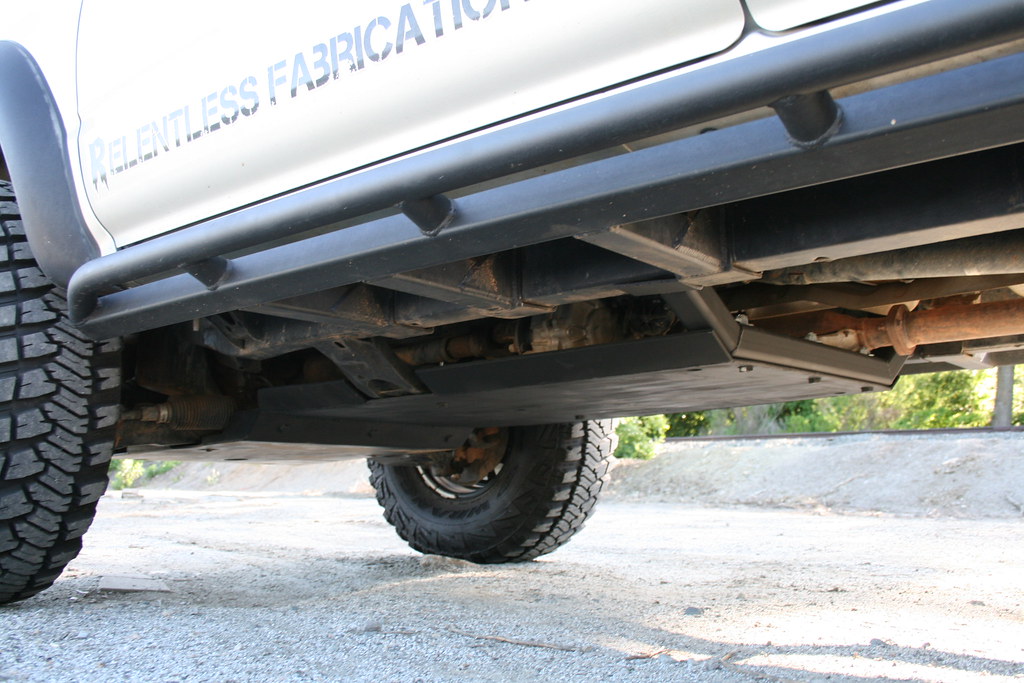

Last couple weekends have been consisting of building a belly skid for the truck.
IMG_2159
by Cory Bechtold, on Flickr
IMG_2160
IMG_2161
Belly skid is built out 1/4" steel and the cross member is 2"x2"x3/16" with some 3/16" plate that bolts to the frame. In theory, it shouldn't break or bend, but I'll put the skid through its paces this summer when the real fun wheeling starts.

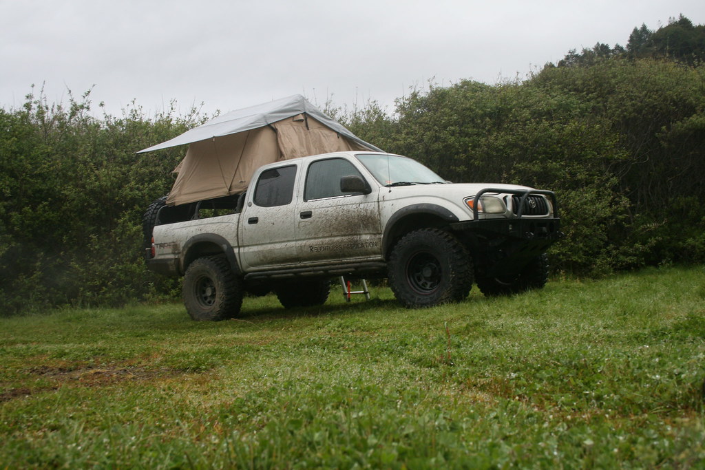

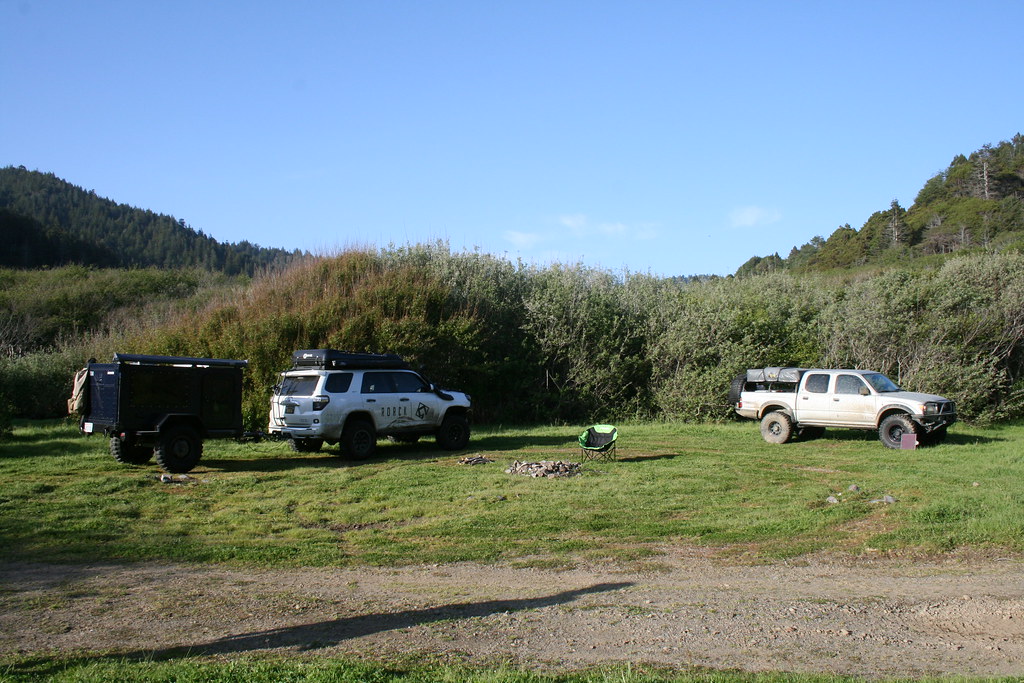

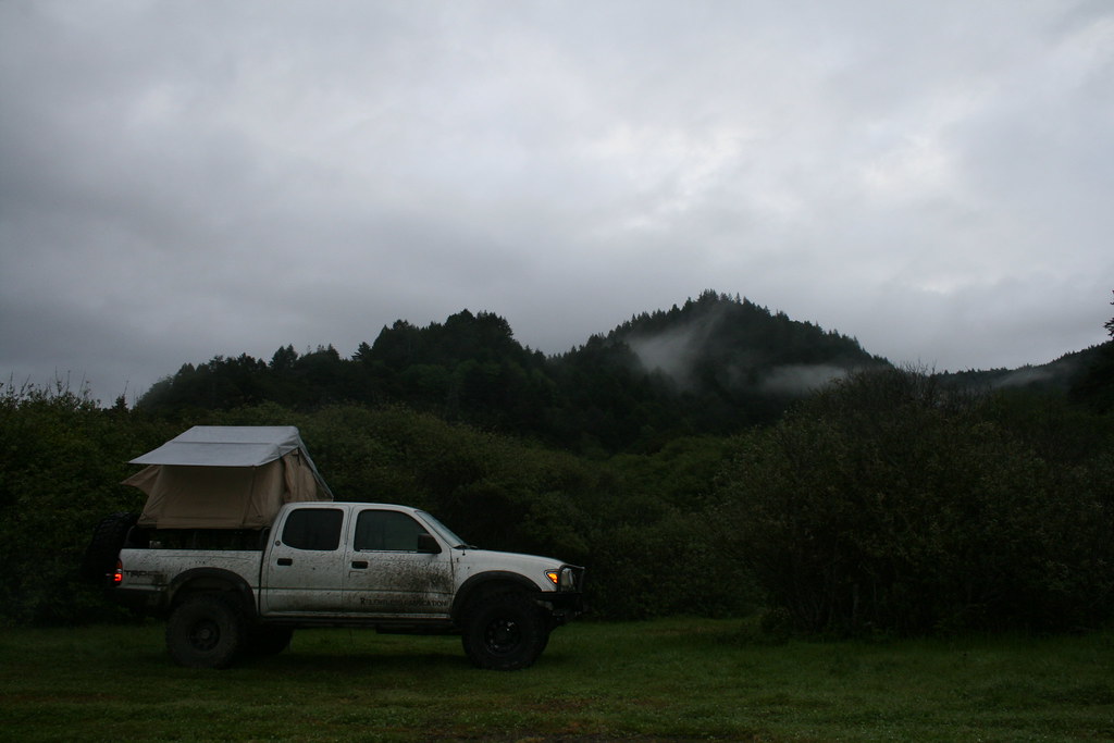

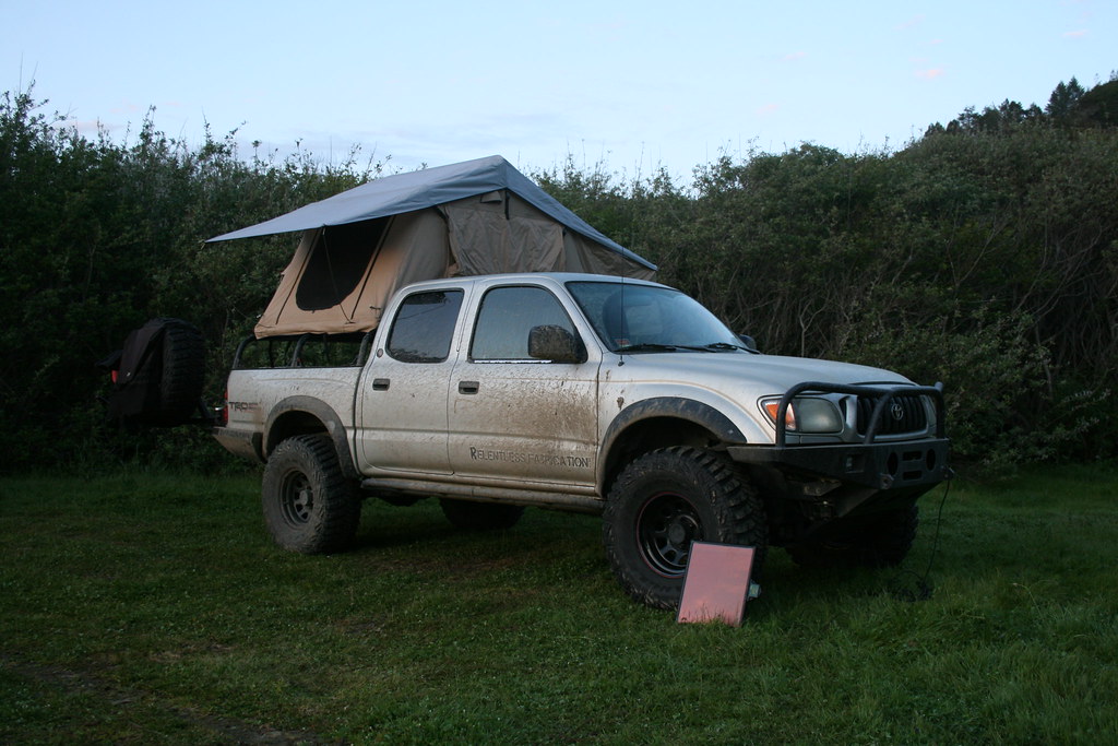

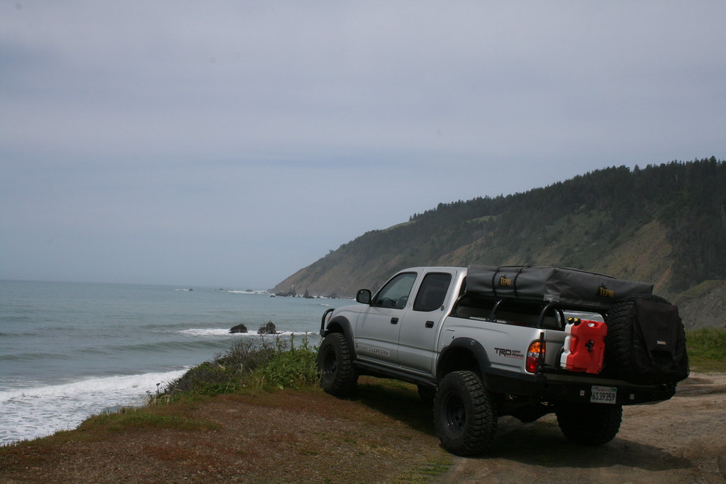

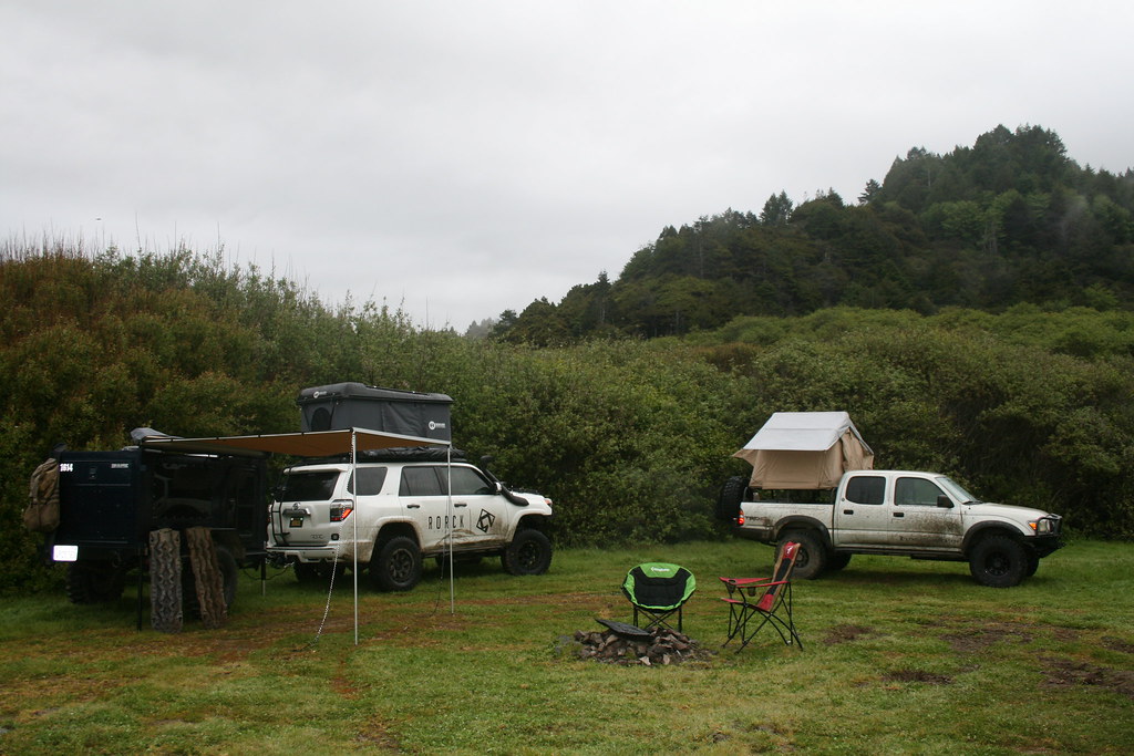

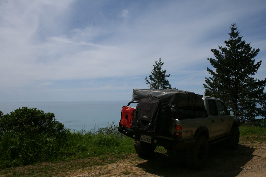

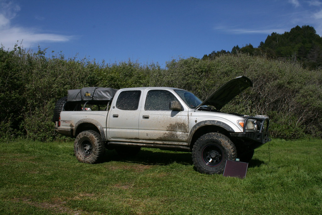

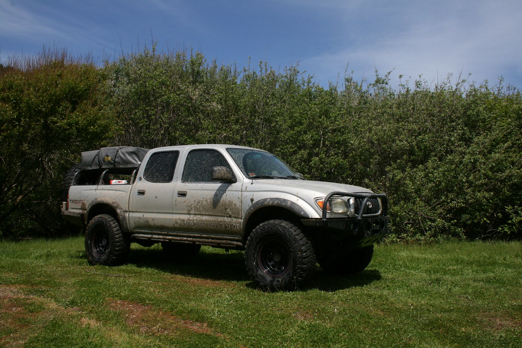

Did an overnight trip to Usal Beach with a member off Tacoma World. Usal Beach was beautiful and is definitely an area I'll be heading back to when it warms up.
