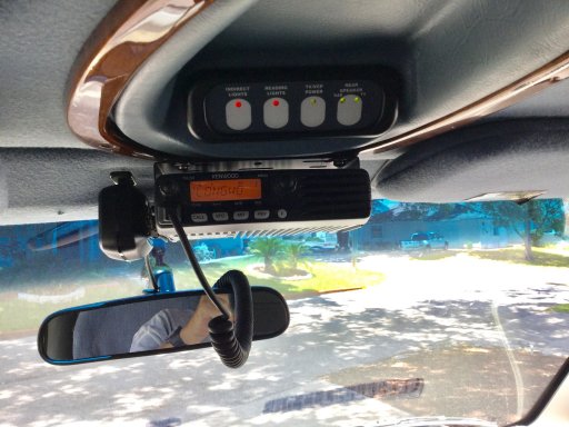

I would suggest any location where it is easy to operate and not a distraction while driving, I mounted my radio between my visors and above the rear view mirror on the cab ceiling. That way I can keep my eyes on the road while changing channels or what ever. I used to have it mounted under the dash and it would really pi**off my Wife when I would be looking down instead of watching the road or trail.

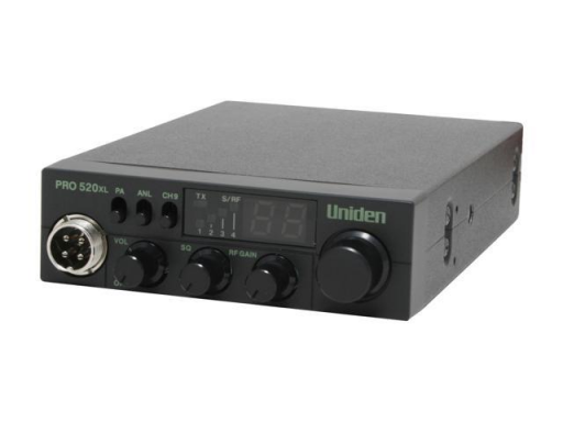

My truck CB is this size. It does not interfere with a passengers leg room.97683I have the Uniden PRO 520 XL, but the step-down model 510, is just slightly shorter. Both work well also in fitting without much interference between the console and seat. On my setup, it is tight, and a little care when moving the seat fully forward is necessary.
97687
EDIT: You do need a external speaker, as these 2 units have a bottom firing speaker!

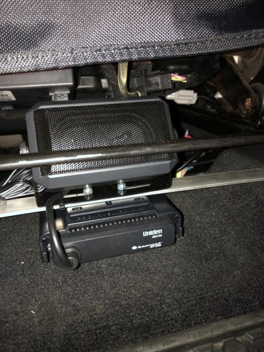

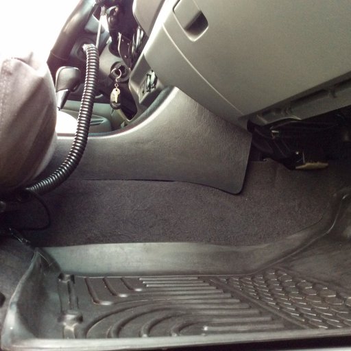

I run a uniden cmx760. There’s the main radio that gets mounted under the seat or under the dash or somewhere out of sight. The microphone gets plugged into the front of the radio with an Ethernet type of plug and the handheld mic has all your buttons and screen in it. It comes with a cable extension with a little square on the end so you can plug the mic in. It’s the most concealable radio I’ve found. The first picture you can see my setup under the passenger seat. The top is an external speaker. The bottom is the radio. The wire coming out of the front is the mic cord.
(I’m realizing now that I don’t have a picture of the mic itself. I can take some pictures if you’d like)

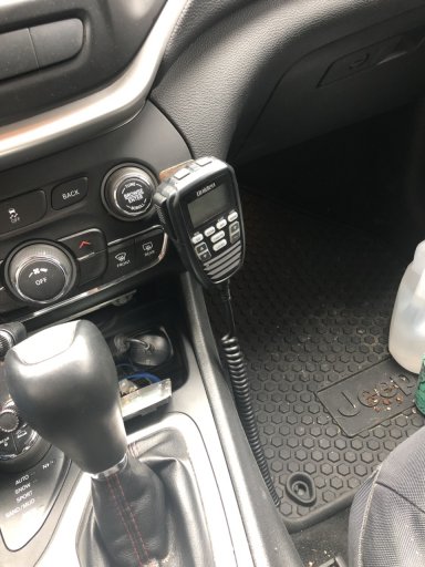

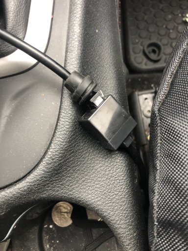

Checked the manual really quick. The squelch goes from 0-7. I’m usually at 2 . And the mic Audio is pretty terrible. It needs an external speaker. From what the manufacture claims, it will put out a full 4 watts. No one Iv ever talked to has mentioned bad audio quality over the air.
I ran outside and too some pictures. You’ll see a little black cube. That usually lives between the passenger seat and the center console. The mic just plugs into that when it’s needed

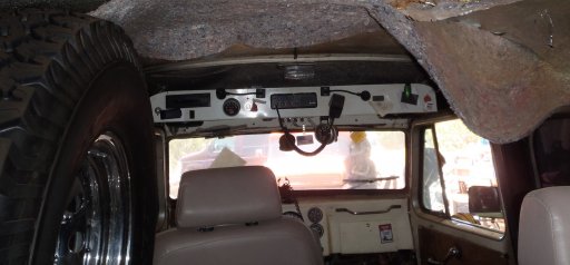

I made an overhead console to put reading/map lights, switches and radios in my Willys. The blank spot on the right is where my FT-2900 2 meter Yeasu ham radio is now.
Sorry for the poor photo, I'm trying to figure out how to glue/attach some insulation to the roof.
