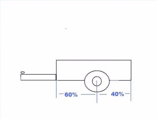

Depends on how you load it but for an even load, on a 10' "living / cargo" area, the standard is the axle centerline 4' in from the trailer end or 6' back from the trailer front.
The biggest factor is, how will you load it, where will heavy items be placed.....
ie, tools, battery, cooler, water, spare? But you want 60% of the weight in front of the axle.
