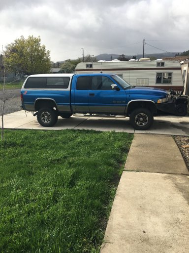

Personal input... my old 2000 Dodge Ram 2500 Extra cab with a 6.5’ bed is about as large as I would want to go. It was almost too big, hence I bought the Bronco.

My Old Ram 2500 is about the size of the F-350 you propose (6.5 bed instead of ait was an all around good rig... just too heavy for deep snow, which is where I like to be. I lived out of the back for almost a year comfortably.
I don’t think I would have wanted an 8’ bed... I was able to have 25 gallons of onboard water, heat, kitchen, and 3500 kw generator to operate my microwave and top off house batteries when I was parked for several days.
