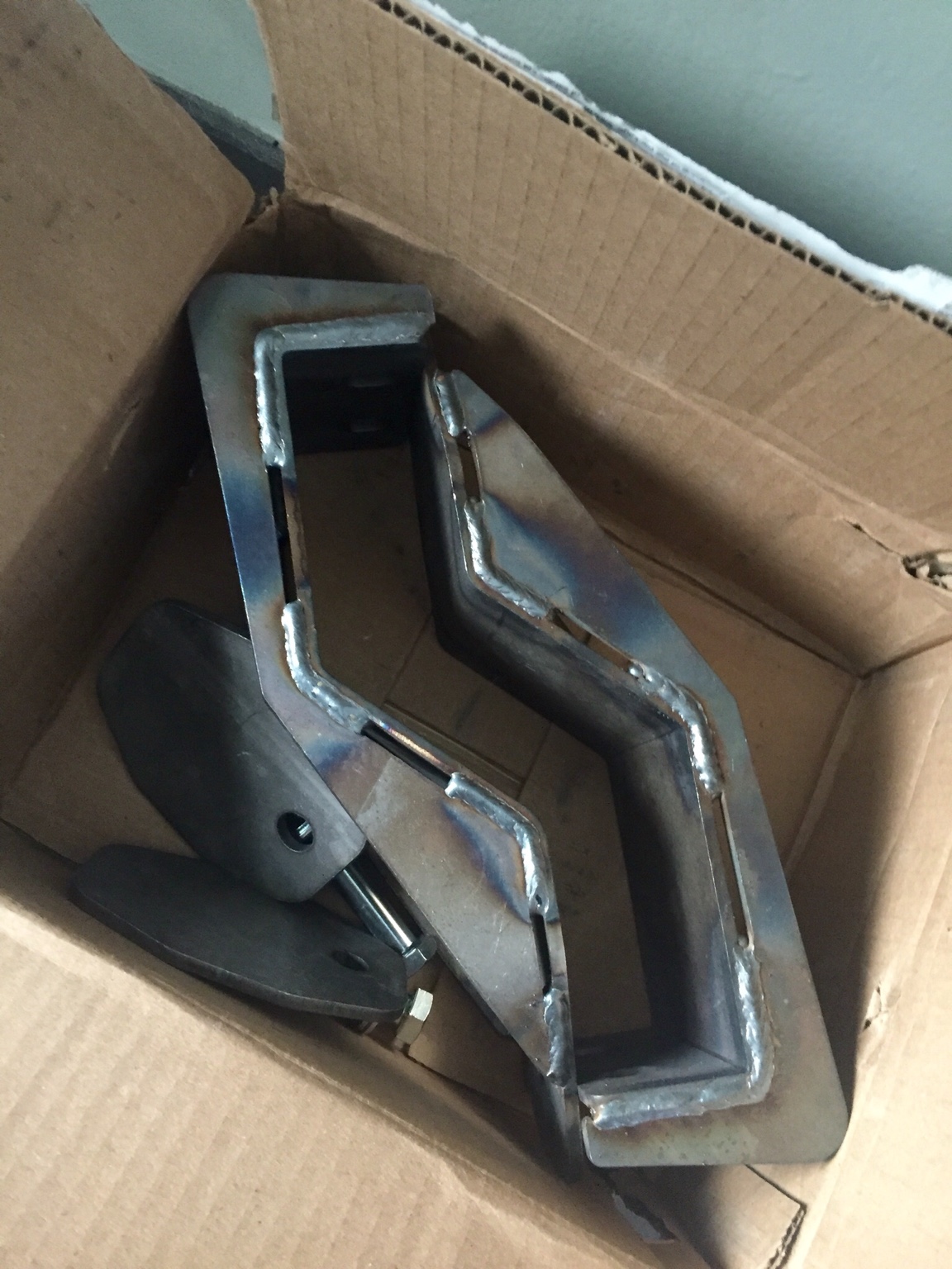

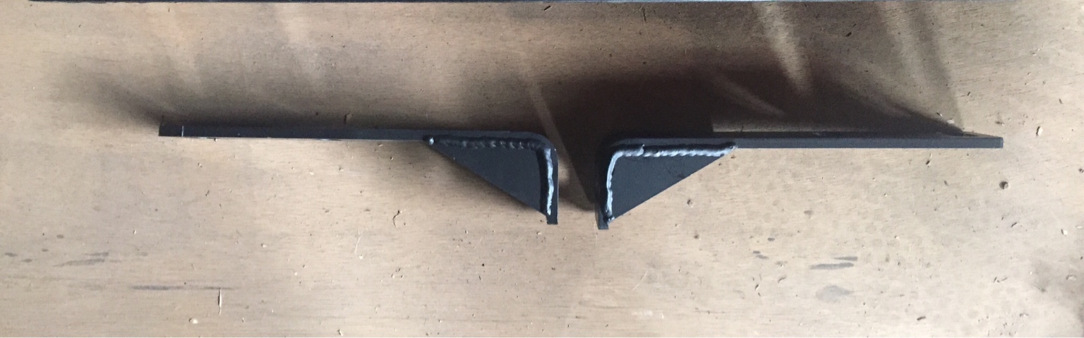

geekhouse23
0270
On the front, I went with aluminum as that what was available to me locally (local TW member was selling his pelfreybilt at a price I couldn't refuse).
Just make sure you go with some solid bumper support brackets so that what you are making recoveries, you don't rip off your bumper; regardless if it is steel or aluminum. I upgraded from the pelfreybilt support brackets to much beefier and gusseted Brute Force fab:
Pelfreybilt -
Brute force fab -
Needless to say, my rear bumper will definitely be steel.
