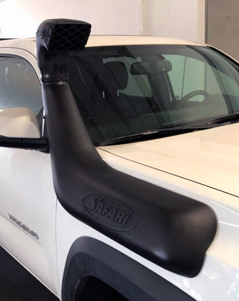

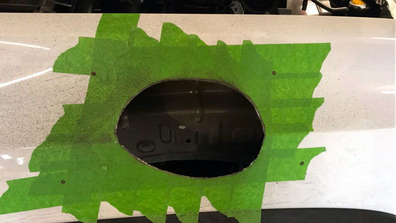

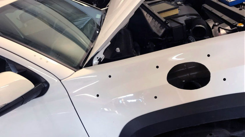

Next we moved on to the Safari Snorkel from ARB. I gotta admit - the gen 3 Tacoma snorkel is big. Like real big. But as with most of the Safari snorkels we've dealt with it's also designed to fit the Tacoma perfectly. Install as a normal 2-3 hours, including the mandatory last 5th measurement before cutting a giant hole in a brand new $40,000 truck. We've seen a couple of A-pillar leaks before so the only additional step we add to snorkel installs is some seam sealant over those mounting holes and on the threads of those bolts.

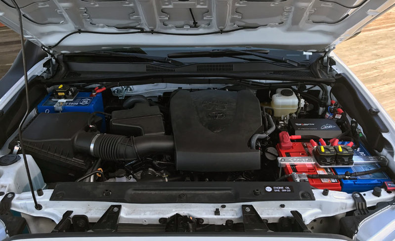

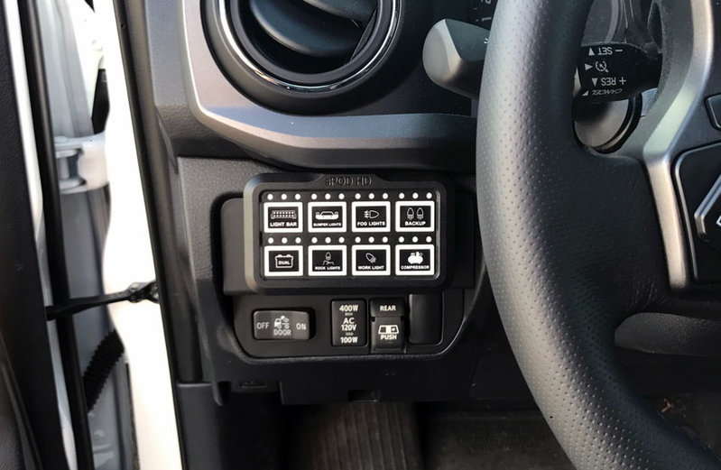

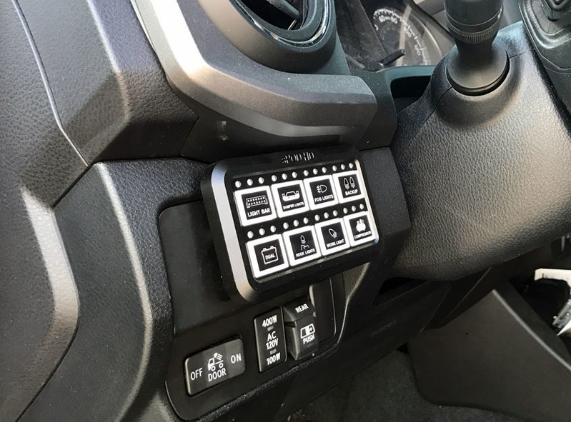

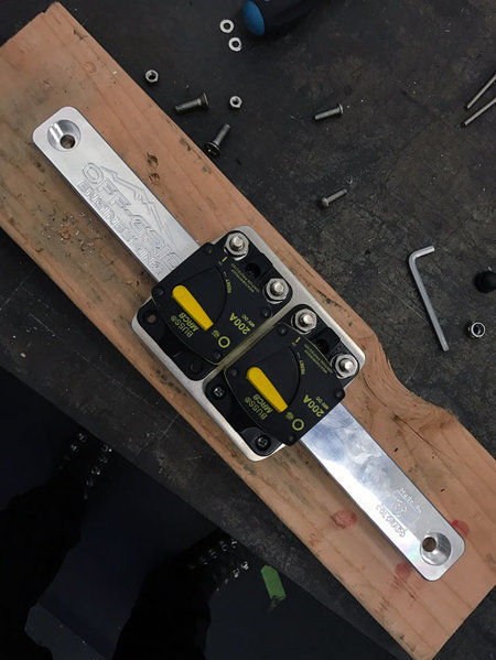

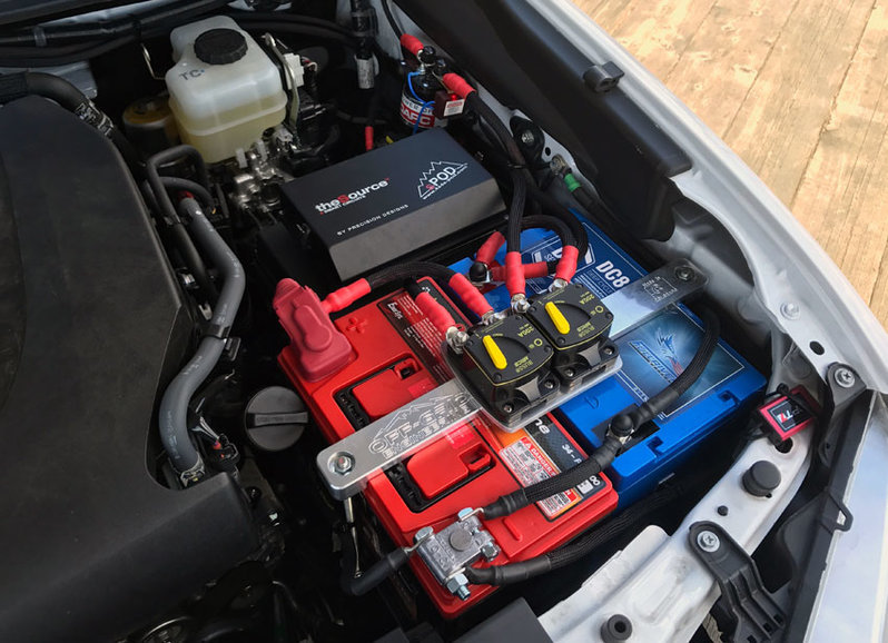

Next up is electrical, and we've got some pretty cool stuff going in this truck. If you follow us on social media or read our blog you'll probably see that we do A LOT of electrical work at the shop. It's kind of our specialty. Here's a sneak preview - more to come soon...
