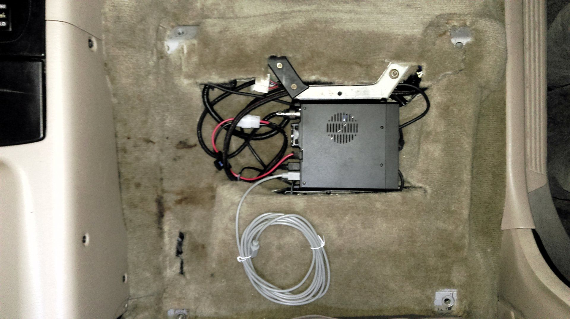

  • Installed Kenwood TM-71A ham radio

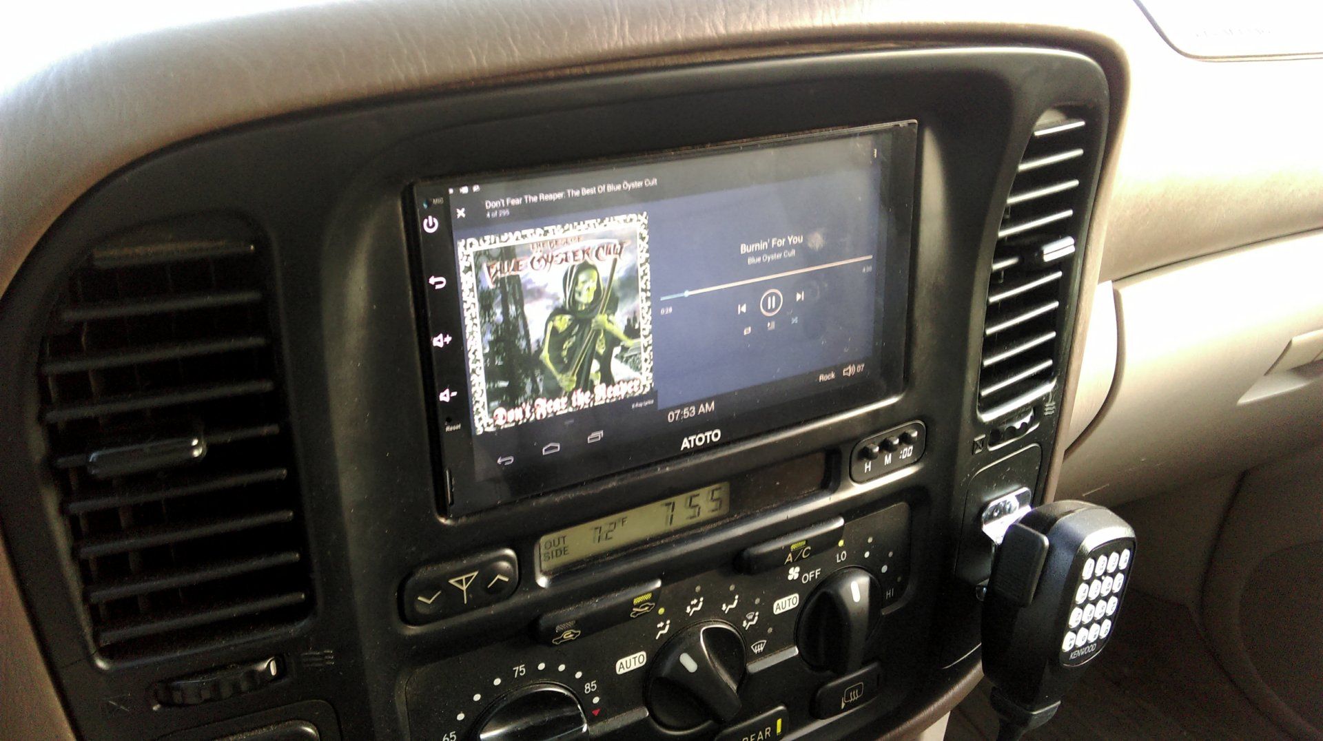

  • Installed a 32g ATOTO Android Radio to replace the JVC radio

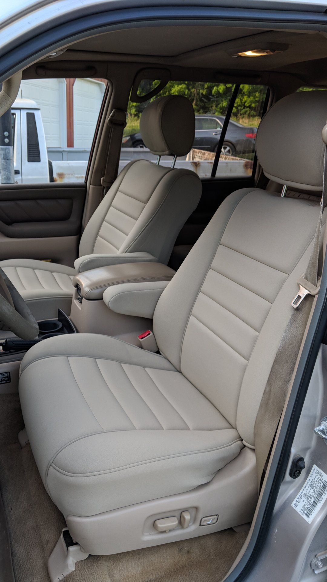

  • Installed a set of Wet Okole seat covers over the cracking leather on the front seats

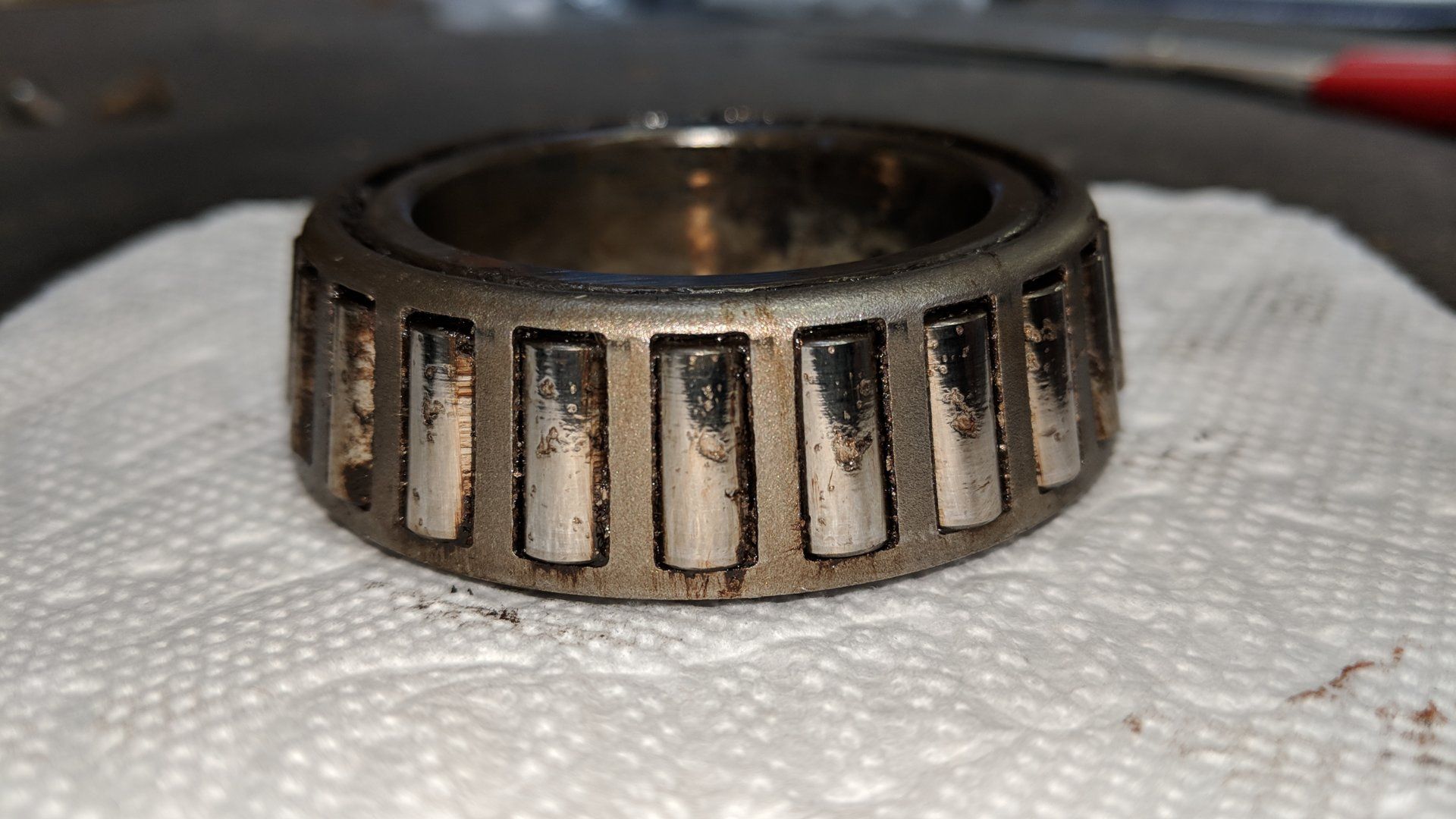

  • Rebuilt the front hub assembly with new Timken and Koyo wheel bearings

Wet Okole covers fit great!
Wheel bearings were making some noise

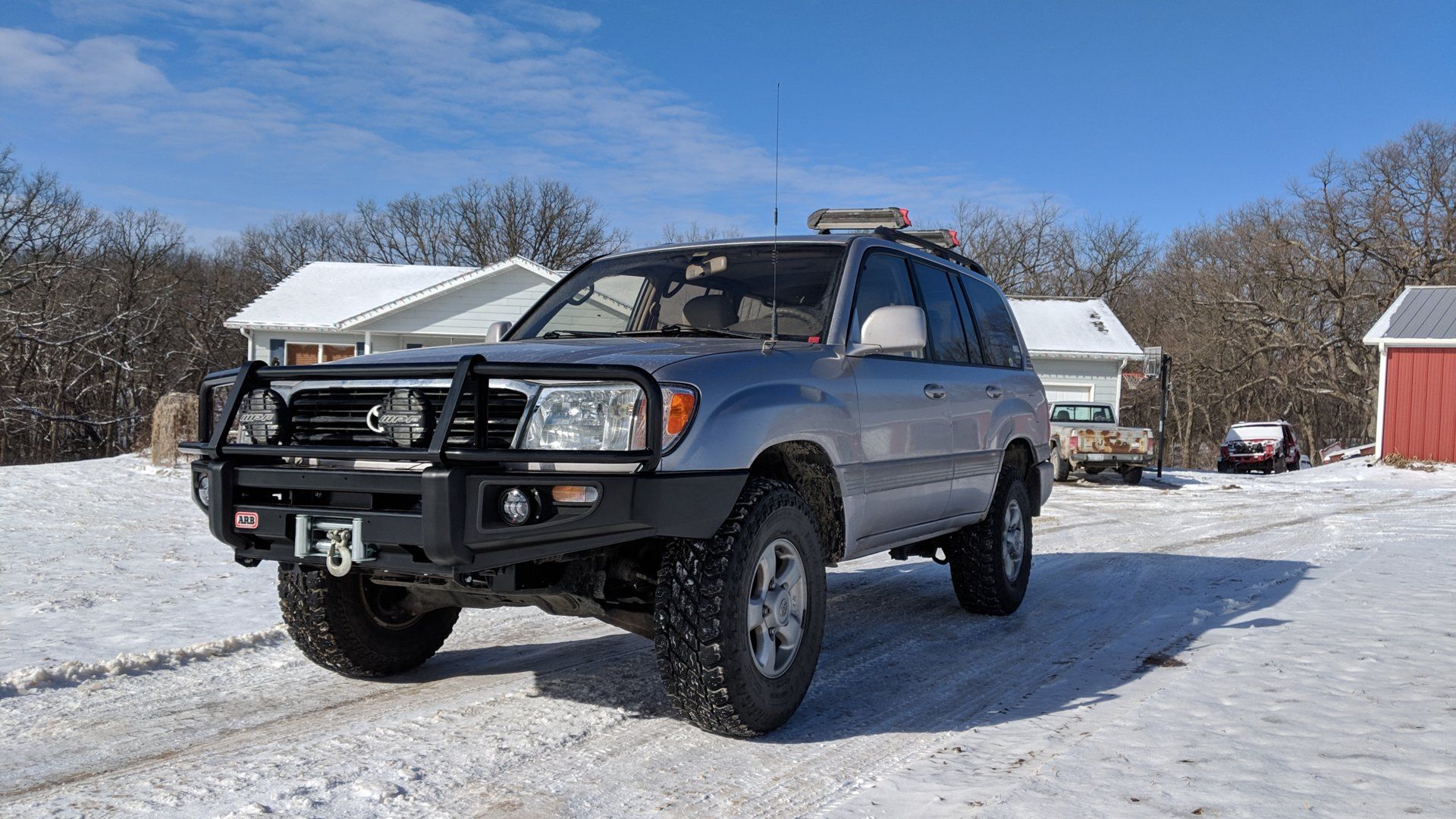

  • Install +03 ARB Deluxe front bumper with amber Xprite JK fog lights

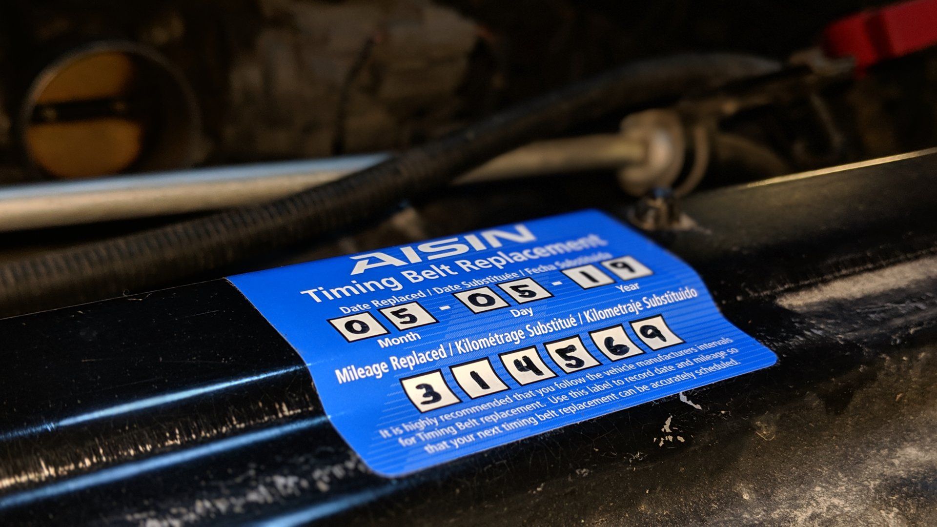

  • Replace Timing Belt with Aisin kit

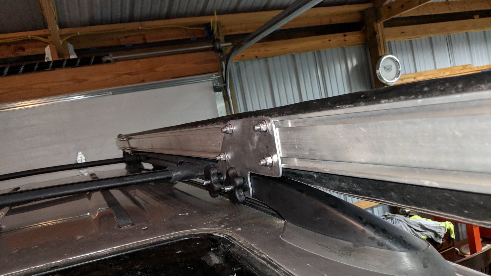

  • Upgrade roof rack crossbars with 80/20 for ARB RTT

Fresh ARB Deluxe bumper installed
Timing Belt service completed!
80/20 roof rack cross bars installed
