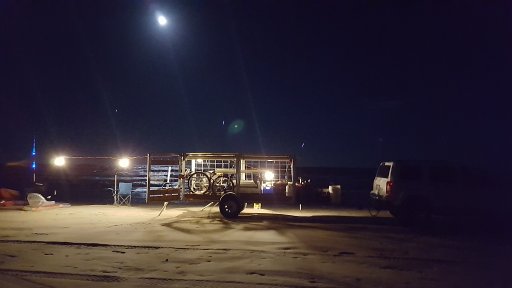

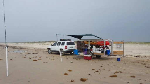

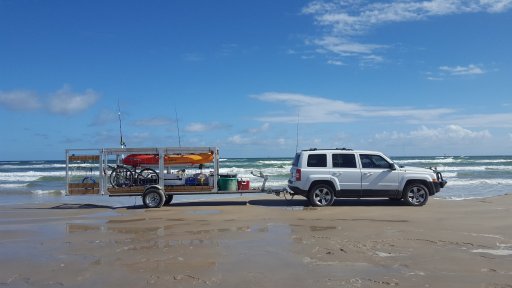

Sounds similar to what I built a few years ago for surf fishing trips.
Edit, here's a good picture. By using a shade with 3 points, it is easier to catch the wind and have the wind hold it up like a kite

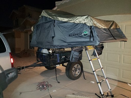

I've got a trailer that started out as a lowes 3.5'x5' utility trailer. I had a local shop box in the frame, weld in a new extended tongue, and weld mounts on a 3500lb axle. It's now running on 33" AT tires and has an RTT mounted on top.
Not the fanciest trailer by any means and it still needs a lot of work but I'm very happy and its cost a lot less than a commercial trailer. Next on the list is to widen the fenders and get the electrical started.
I'll have to take some better pictures next time i take it out.
I’m looking at this trailer for a DIY rig. Definitely update us on your upgrades as you go!
Will do! Its going to be slow for a little while. Next up is widening the trailer and in doing that creating fenders that will actually cover the tires.
Following that will be power. Probably a large battery pack on the trailer and a solar charger. The current plan is to charge it off 120v at the house and top it off with solar. Eventually I may link it so the xterra can charge it when driving, maybe not.
