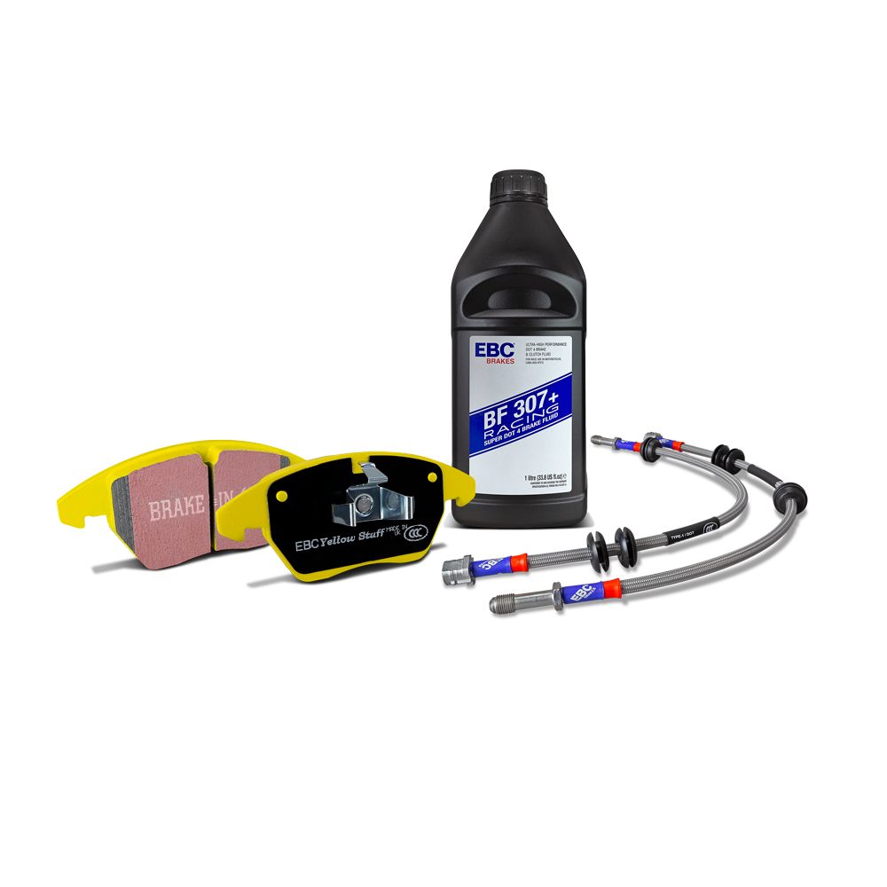

Brake size isn't the issue, if that Tundra is similar to the ones I'm thinking of. Ford F550 brakes are big, but not indy car big.
EBC yellow pads will help. Your Rubber hoses ain't helping, EBC might have braided hoses for your truck as well.
And replace all of your fluid and bleed properly.
Before you drop coin on a complete big brake kit, consider if that's expensive enough to just upgrade to a 3/4 ton truck instead.
