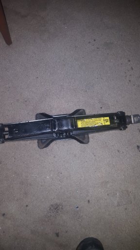

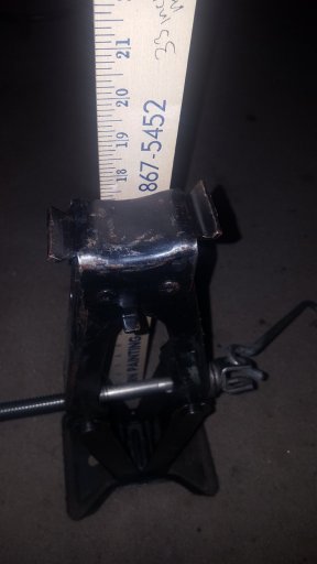

I saw that, but all of those jacks are simple hydraulic systems that have to be quite bulky to get the height I need - and that doesn't address the challenge of getting a large jack under a vehicle with a flat on uneven ground. I have a HF jack that I thought would be sufficient and ended up using it a few weeks ago. The jack topped out before the tire was sufficiently raised to get the spare on and we ended up resorting to the scissor OEM jack.
That's why I'm interested in a jack more like the Toyota OEM, it has two lifting pistons compared to one, it doesn't leak, and it doesn't rely on o-ring seals.
Sorry for the poor quality, this is the best I could find to show how much extension a mechanical bottle jack has. I can't find a hydraulic one with this much lift in this small a package.
