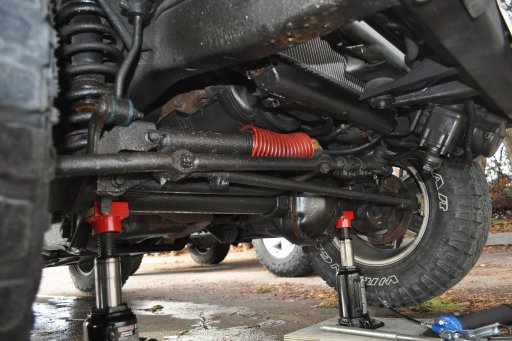

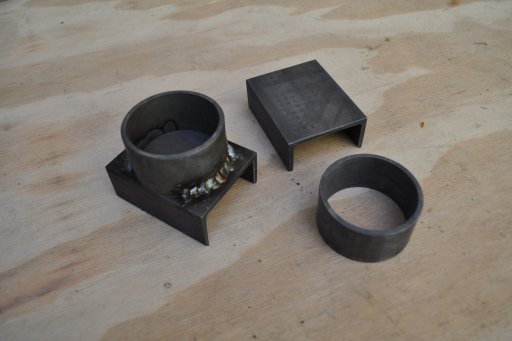

I use a pair of MotoMaster 6 ton bottle jacks for my Jeeps. That's Canadian Tire's house brand so I'm not sure want brand they "really" are. I made a couple of caps that make lifting the front end for lubing and removing the wheels much easier. I don't like lifting the front end with a floor jack under the off centre differential.
