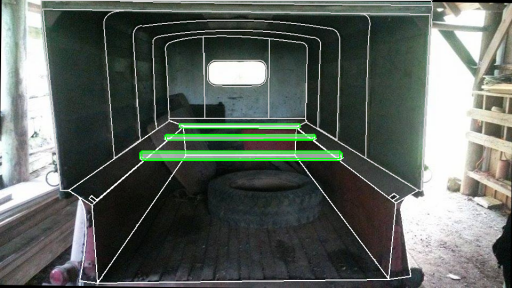

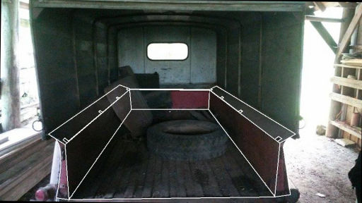

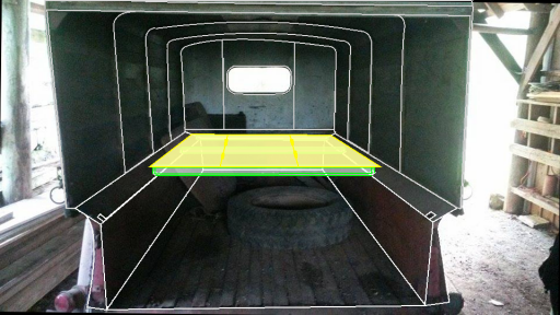

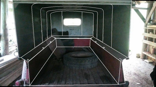

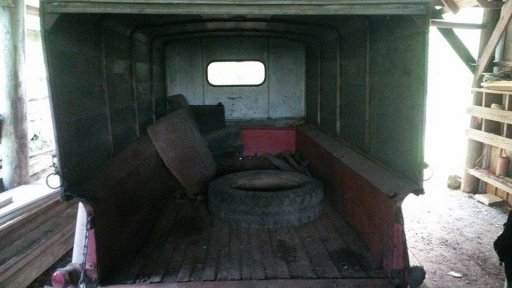

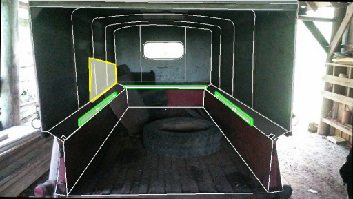

Using an old picture from when I picked up the truck, here is my basic plan for a modular bed platform for the camper. Let me know what you all think!
1. FC-170 - Hooking it up: Inside the camper.jpg 2. FC-170 pickup wire frame.png 3. FC-170 pickup & camper wire frame.png 4. FC-170 frame for bed.png 5. FC-170 bed floor.png 6. FC-170 bed frame and floor stored.png
