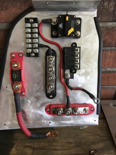

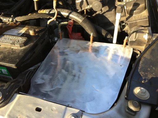

A week ago I was finishing a winch install on my F250. I fabricated a nice little distribution panel for the winch wiring, and a small fuse box for some lights and other accessories. I had the truck battery disconnected while doing all this work as I've learned over the years things happen, sometimes bad things.
When I finished, I connected the positive cable to the positive battery post, and then the negative battery cable to the negative battery post. The under-hood light came on which was my signal we had power to the vehicle.

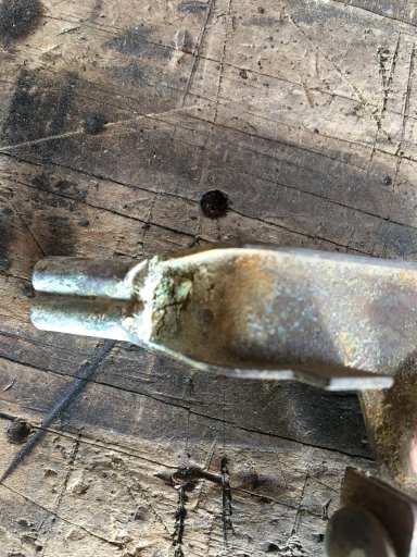

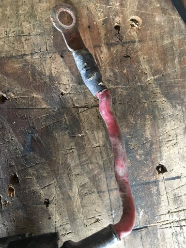

Then I discovered this.
BATTERY CREEP!!!!!!!...............NOOOOOOOOOOOOOOOOOOOOOOOOOOOOOOOOOOOOOOOOOOO!!!!!!!!!!!!!!!!!!!!!!!!!!!!!!!!!!!!!!!!!!!!!!!!!!!!!!!!!!!!!!!!!!!!!!!!!!!

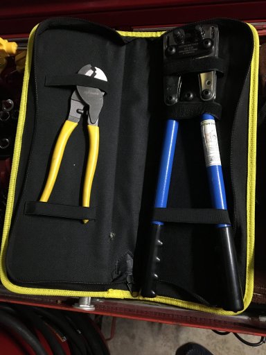

So no big deal, cut off the positive terminal, get out the tools and reconstruct the positive side of the harness going to the alternator/starter and power distribution box or "fuse box"

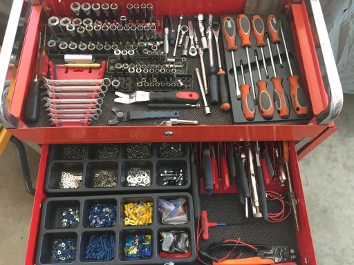

The tools required to do this..................all of them.
Are we excited yet???

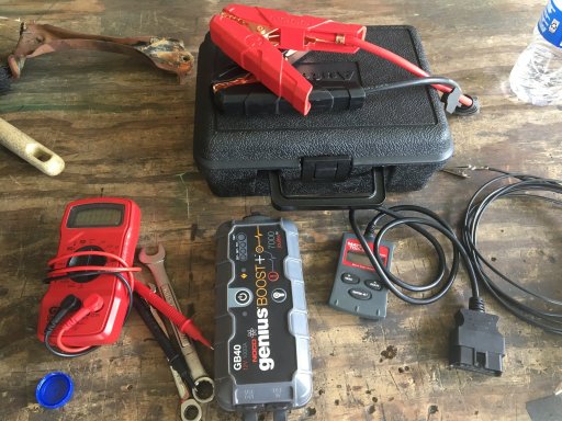

I was not. So rebuilt the the two pos leads and reconnected and still nothing. I start thinking I need to check resistance from the battery to the starter and alternator.
So that happens
Everything was good.

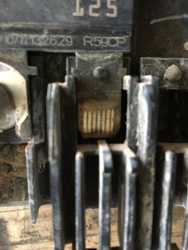

I went back and checked the circuit breaker/master fuse below the battery and it looked like garbage so I completely disassembled the part and cleaned all the contact surfaces and put it back together. This time I bypassed the silly twisted up wire that would send panic attacks to my power probe and ohm meter. It looked like ass too.
IMG-1910.JPG 67356442491--141F2538-8775-4C58-AAB1-25652F5A998A.JPG IMG-1909.JPG
Reconnected the entire system and nothing.
Not a damn thing.
I am convinced its my circuit breaker that is bad. Power is not getting from the battery to the good parts.

Battery creep is corrosion that may not be visible at the terminal end of a cable, but can be present at the middle of a cable unseen by the eye because it's wrapped in an insulator.

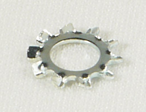

Put snow flake washers under grounds. Grounds suck even when put on at the factory. Ten years later they will suck even more.

At KIA we fixed most of the sensor problems with those snowflake washers. My boss hated warranty part jobs and we all knew the grounds sucked.
