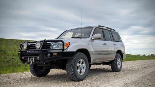

I had a swing away tire carrier with fuel storage on an old Jeep in the past. I loathed accessing anything in the back since it required opening that darn carrier. When I started looking at fuel storage options for my Land Cruiser I immediately looked at options that did not involve a bumper with swing away carriers.
I chose to replace the stock 24 gallon tank with a 40 gallon LRA tank. This tank simply replaces the original tank with a larger one. There are no dual fill nozzles, transfer pumps or auxiliary fuel gauges to worry about... or expensive gas can walking off from somebody who thinks they need them more than you. The original fuel sender and pump assembly are modified to work with the factory gas gauge and the fuel is always available for you to use. With the fuel down low, I do not notice any difference in drive-ability. Maybe it feels like an adult riding in the back seat. The large tank does hang a little lower than the factory and would be a poor choice for somebody who spends most of their time skidding along rocks.
The best part? The tank has no bling factor (which might be a problem for some folks). It is even difficult to spot when you are looking for it.
In a fuel hungry Land Cruiser, range is always a problem. With the LRA fuel tank, range is no longer a concern. If I wanted to relocate my spare tire to a swing away carrier on a bumper (not likely), I could add the LRA auxiliary tank and add another 20 gallons of fuel.
As a bonus, the crew at Long Range America was super easy to work with. Ward handles the ordering and ordering questions while George quickly answers any technical questions you may have.
