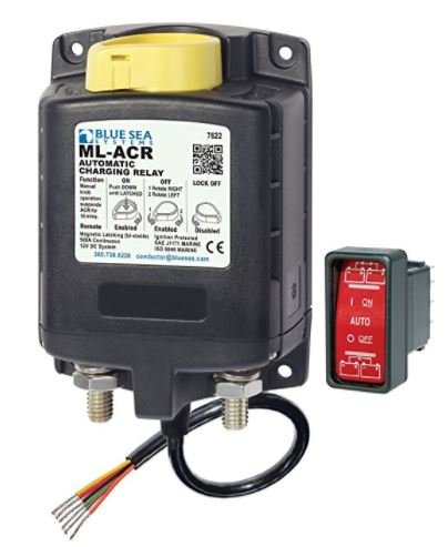

Battery wiring easy, don't let it freak you out.
Complete Option -
https://www.offgrid4x4.com/collections/dual-battery-systems offers a complete kit with the highly regarded Blue Sea's ACR - Pretty easy to wire - http://assets.bluesea.com/files/resources/wiring_diagram/ML-ACRs.jpg or http://assets.bluesea.com/files/resources/instructions/990180180.pdf ( I hope posting the vendor is okay)
But the price might make you blush.
Good alternative and it's what I am going to do on my next build.
CTEK offroad kit which also has a built in solar voltage regulator but no battery tray - http://bit.ly/2hWnzZZ
Puts you in the same ballpark and needs a mount made for the CTEK's too so although a more complete electrical solution it's not the easiest.
The DYI option is
Lastly you can source a battery tray from many vendors and do the battery solenoid from painless. The solenoid is commodity but they label everything and provide great wire and connections.
And search the google for outbackjoe 12v design guide for GREAT info.
