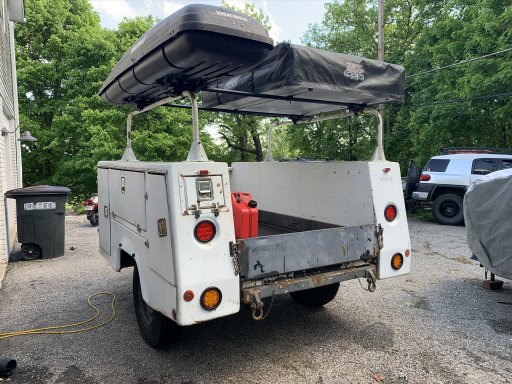

I first took the ute bed off the janky trailer. Even though the trailer is made out of fiberglass it is still a heavy beast of a thing. Since the trailer was made by the now defunked Astoria Company and it is a massive white beast that wants to fly I dubbed the build the Astoria Albatross. I had to free the bed from the trailer by taking off the lag bolts that held it to the frame. (yes that's right lag bolts...) Then I built 2x3 risers to put under the bed and a 4x4 post across the front two so that the trailer could be lifted off.
Not it was time to lift the bed so I did what any good Hoosier would do. I pulled out The Pride of Bloomfield Indiana....The Hi Lift Jack.

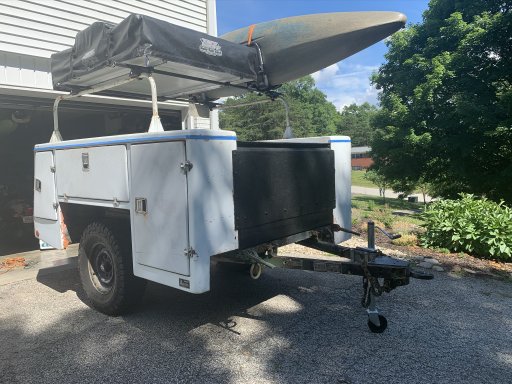

With the help of my friend Gene we got the ute bed up in the air and the trailer pulled out. Now to slide the the M116A3 under it. I thought I had measured everything correctly but the tires hit the underside of the bed so I used an old trick I learned from somewhere and deflated the tires. It work and we then jacked the bed back up and lowered onto it's new home. I promptly put the old trailer up on the KYTLCA Facebook page and it was snatched up by one of the members.
Lining up the bed to the frame was a give and take situation. If I had lined up the bed directly over the wheel it would have left a the trailer frame expose in the front and the frame not lined up with the rear of the frame. I may still change that later...

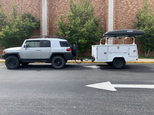

Now the M116A3 trailer is a beast. It come equip with a surge break and a 3 inch pintle hitch that weighs a ton. I decided to ditch the breaks. The weight of the trailer is of primary concern and the brakes seem like overkill for this project. I may change my mind on this once I get it into operation but for now it will stand as is.
Gone is the heavy front nonadjustable jack, replaced with a lighter unit. It also comes with two emergence brakes, one for each wheel which eliminates the need for chocking the wheels, a very nice feature.
The trailer also as a dump feature. While the trailer is hooked up the rig, if you pull two pins on the front and engage the e brakes then back up, the trailer tilts backwards. This will eliminate the need for ramps when loading motorcycles.
The plan is to put a winch onto the front of the trailer and winch the bikes up the slope, strap them down and then lower the trailer. We will see how this works out.

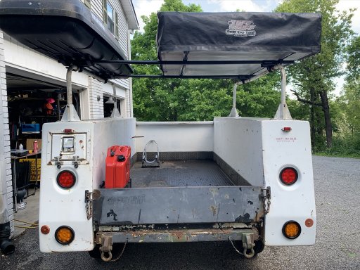

The plan is to put a roof top tent onto the ladder racks. I am re-purposing the racks sideways so that I can put Yakima load bars on the trailer and a Rocket Box. The load bars are as wide as the trailer and will give me lots of room for all the stuff needed.
The doors will hold all the kitchen supplies as well as adventure gear and electrical systems that will be on the trailer. The plan is to put a heated shower on it as well as a 270 degree awning. Check back for updates as I finish this build.
