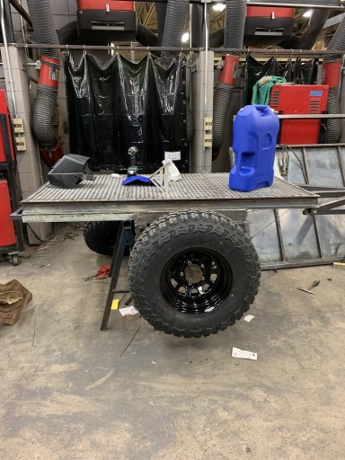

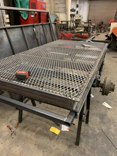

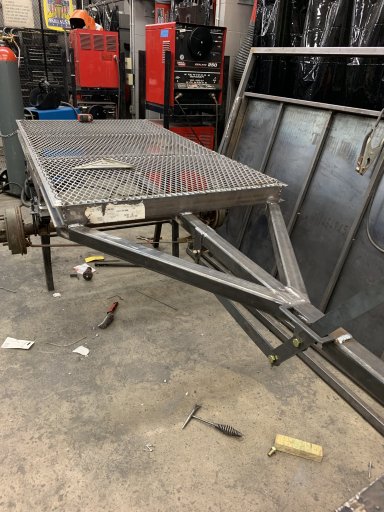

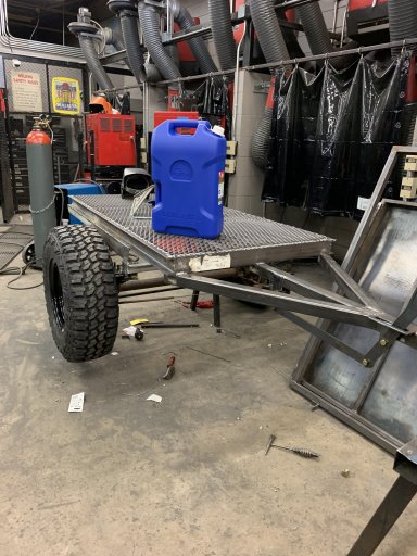

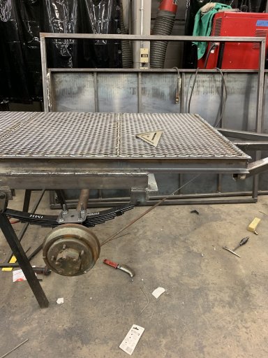

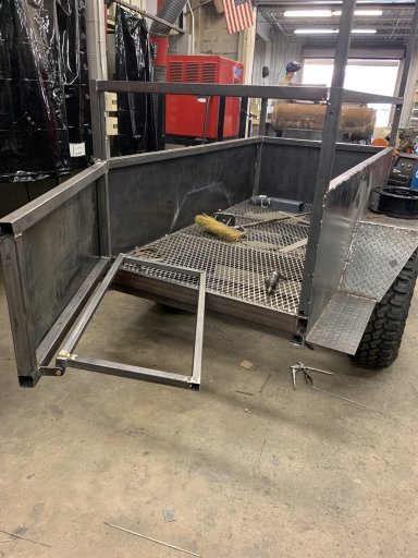

trying to go as light as possible with building everything out of steel, we went with a mesh floor in the bottom. I carry most of my gear in Pelican Cases so an open top is perfect for me. The axle is on and the springs along with the floor

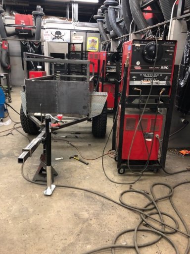

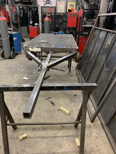

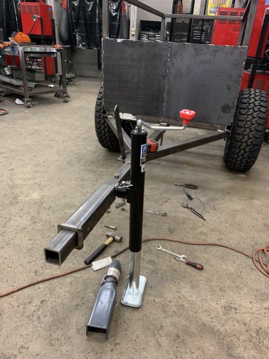

Tongue is one and they came up with an actual good way to use the parking brake that was on the axle. Crazy how it works after 70 years.

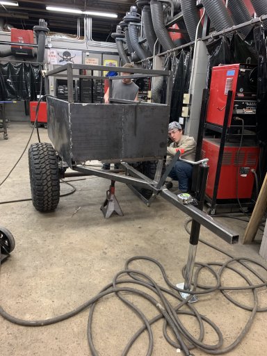

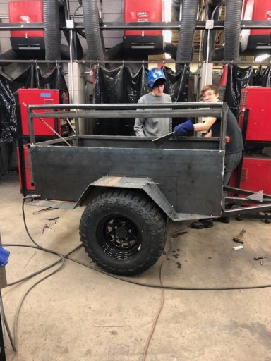

Starting to come together. Great start to what I think will be an awesome trailer.
They came up with a hidden table on the back that will be up under the rear end. It slides out for use on the back where I told them I wanted a kitchen area.

Another poster here said the expanded sheet metal rubbed holes in his plastic cases, so he bought a rubber stall mat from a farm store. I think that cured his issues.
James
Yeah I plan to get a rubber mat. Spotted a nice one at Tractor Supply the other day that should fit perfectly. Plus I love rubber. Keeps rattling and noises down.

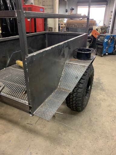

One thing I definitely wanted on this trailer was for the rear of the trailer to be my kitchen area. So they are making me a swingout door with a fold down table. I have asked for one on the other side as well. This should be very nice since I love to cook and be camp chef.
SLPNBG
2,026
Mechanicsville, Va
11700
You should/ I would have the outer table swing up. You'd have two separate working surfaces from one side of the tailgate.

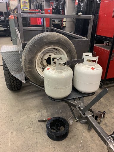

A few times the wife and i have been out camping and have ran out of propane for heat/cooking and several other times we have been very close. Having an FJ Cruiser we don't have a ton of room and when we adopted out Bulldog the usable space got even smaller. We carried a 5lb propane bottle for a long time and then we just decided on trips for more than 1-2 nights we definitely need more. So on this trailer I had then put me a holder for 2 20lb bottles. May be a little overkill but in my book, if you really go out and do a week-10 days at a time and your heat, cooking, lights etc are all ran off propane you can't have too much.

Now this is AWESOME!!!!!!
