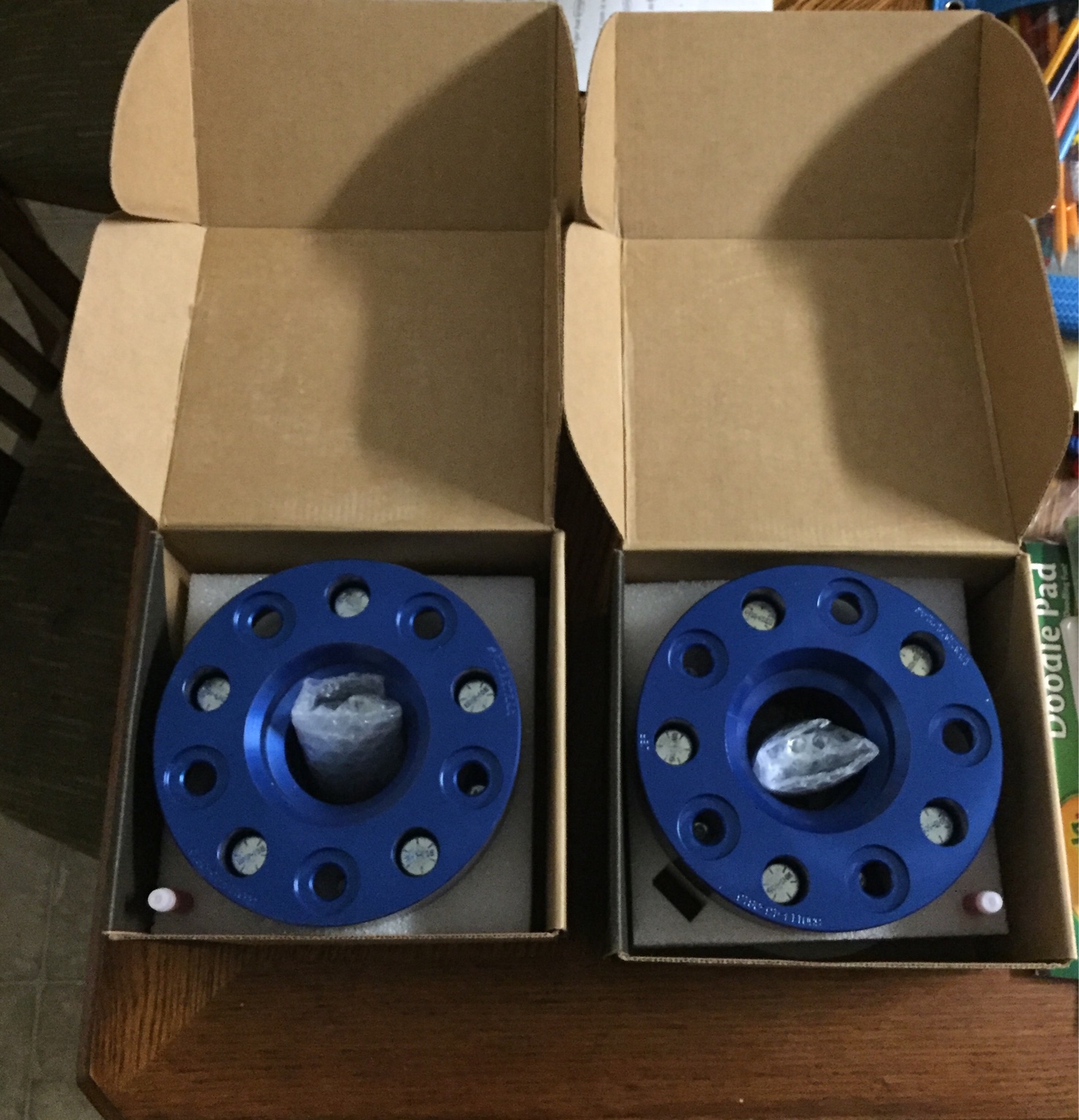

Jose
2,566
Peoria, AZ
Jose
Martinez
1945
Nice!! Guys. Just got confirmation that the Spydertrax spacers will be here tomorrow. So glad for this cause I was leaving to Miami next week and wouldn't want them just hanging out on my front porch. Lol
