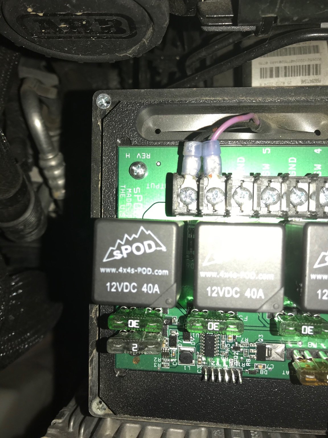

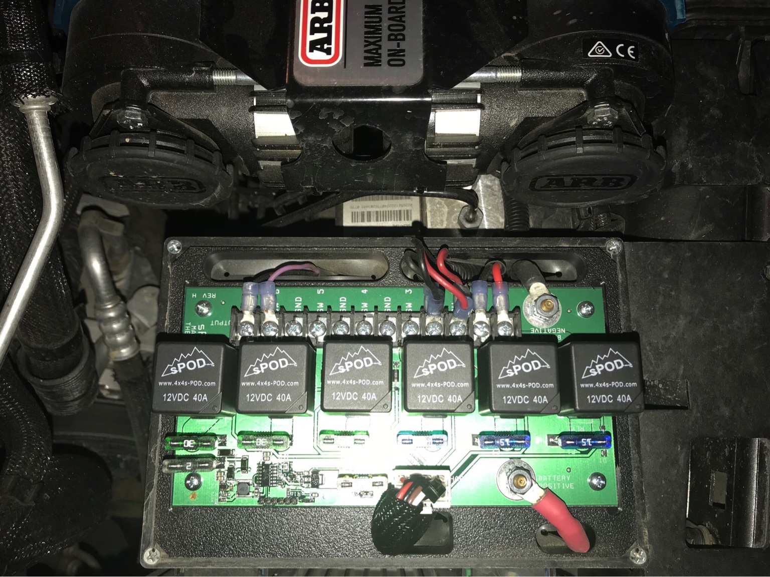

Awesome info shoredreamer thanks for that!! Here is how my set up is under the hood. I’ll definitely look into all this info. But you would think that they would supply the right size wire harness and fuses with the electrical prints that they supply. You can see that the Spod has 12vlt 40amp relays also and switch #6 is where the ARB is hooked up too. I think the harness is a 6 footer that they supply. Also the switch on which the compressor is hooked up to has a 30 amp fixes as well. I emailed ARB and waiting on there response as well. Again thanks for this info very much appreciated. [emoji106][emoji106]

Thanks for the info brother. That’s exactly how I installed the wires . The 40amp fuse are coming from the battery side and the compressor is hooked up to the Spod! [emoji121]️The positive and negative wires of the compressor is hooked up to the battery and you can see that the purple and black wires is the leads cables that is connected to the Spod switch #6

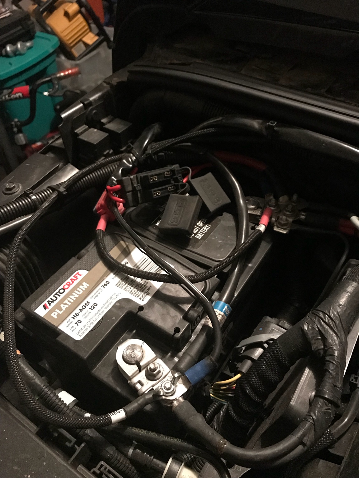

The compressor negative connection at the battery looks like it's got some heat discoloration on the insulation. You might check to make sure that connection is tight. If it's loose you'll be able to feel the wire getting hot pretty quickly. Since it's a wing nut (which are usually only finger tight) you may want to change to a standard hex nut so you can get a wrench on it.
Let us know what you find.

I had to look at the pic real quick to see what you were talking about then I went to the jeep and checked the negative cable and saw what you saw. But that was me with the heat Shrink connector and kind of burned it a bit that I installed cause the one that came with the wire was to small so that’s the discoloration that you see in the pic lol. I had to double check cause I was like damn I didn’t tighten it enough. Also I’m definitely taking your advice on changing the wing but to a standard hex nut!![emoji106][emoji106]
