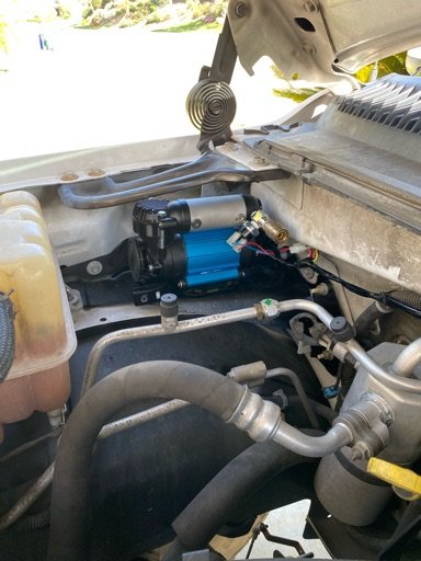

Went with the single motor compressor- the biggest tires I’ll be running are 33’s. It might be a little slower but for the cost savings over the twin right now, I’ll gladly wait another minute!
AW man, you took the battery tray. Now where does the fridge get power?
Looks like the CKMA12?

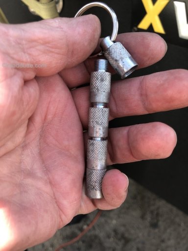

It's a terrific air compressor. I've had one in my trailer going on four years, and at first wanted to get the twin for faster air-up times. "Nah," I thought, "I'll use this one, then upgrade later if I really need it and sell this or put it in my van."
Then found that even with as much as I use mine for six tires, and for helping others air up, I haven't once minded the time it takes. Certainly not worth the extra $600 smackeroos, at least in my case. If you're in a convoy or group with others and folks are waiting on you, maybe, though I rarely am. When I'm out camping and adventuring, I'm rarely in a rush for anything, much less worrying about time it takes to air up. Those pesos are better spent--again, in my case--on staying out longer and adventuring more.
I did find that I needed more air hose to stretch from the trailer to the front tires of my van (20' long) when hitched up, or when helping others air up, so got an additional 18' ARB hose to connect to my existing 18' one. I may switch the CKMA12 to the van at some point for when I'm not hauling the trailer and don't want to dig out my old Viair 90P I keep as backup.
A note on hoses, for those wanting to switch to, or add, a longer one. The ARB hose is a high-heat pressure hose which, in my understanding, is far better and longer lasting for the ARB compressors than a lighter-weight one may be.
I've also found over time that I reach for my simple TeraFlex Deflator instead of the other more expensive deflators I have from ARB and Boulder Tools. Comes apart into four deflators. I've used it enough I can set one van tire to deflate, go to the next and set it too, all the way around, and by the time I get back to the first, it's down where I want it. This little thing is always right there on the console or my key-ring and I don't go looking for the others. It's just as quick for me as it would be to hunker at each tire with the other deflators. There is one from Boulder Tools with four deflators you can preset to desired pressure and walk away. I have it, too, though still go for the TeraFlex because of it's simplicity and that it is one piece when stored.
Good luck with you compressor; hope it does what you want.

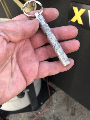

View attachment 194294View attachment 194295
Thanks. That’s a cool deflator tool you have there!
I deflated and aired up my tires in nothing flat yesterday, just to practice and try out the new gear. Worked great. If it lasts- I’ll be happy.

Have also the ARB CKMA 12 on board since some years now. It supplies the air locker and two air supplies (left and right side of the cabin). I am running 255/85 16, which is about 33s. For me, this compressor is absolutely sufficient for overlanding purposes. I have fitted a 9.5 liter or 2.5 gallon air pressure tank in addition. However, I only use it when I really need a lot of air, e.g. in the rally biwack when servicing at race events or supllying air for more than one rig.
From a photo I can't judge your installation situation exactly. But often there is a fair amount of dirt getting under the hood. Maybe it's a good idea to think about a kind of protection for the compressor?
Easy to undo if I choose to go dual battery route, however, living in earthquake and fire country, I like the idea of a Jackery solar battery for dual use in house and truck. (Plus, I have the space in a big truck)

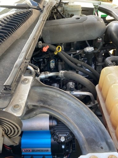

It’s all the way back against the firewall behind the radiator overflow. I don’t want it inside the rig if I font have to -we’ll see how it goes.
