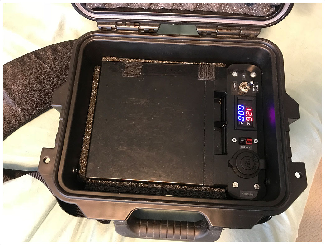

I took the humidifier off my CPAP and got a lightly used Goal Zero Yeti 150 off of Ebay. I also picked up a cable to run the CPAP off the 12 volt plug on the GZ and don't use the AC adapter. If I unplug the CPAP during the day so it doesn't pull ANY juice out of the Yeti150 I can get 3 or 4 solid nights out of it depending on temps. I just got a 50W solar panel to charge it during the day, so I could probably stay out until my food runs out now! :tonguewink: There are a few Youtube vids showing the setup.

Hey guys, just curious who else uses their CPAP machine while overlanding and how you have it setup. I was thinking about an inverter to my Jeep battery (single system) but I obviously don't want to drain my battery. Another thought was a Honda suitcase, but honestly, not my favorite idea. How do you power yours?
Check out my post where I show my build of a power supply. Search for DIY 12V Power Supply with schematic.
