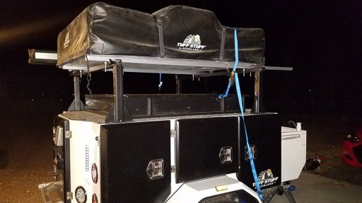

Finally got my new tent mounting rails today and got the tent off my FJ. (I cut the originals to fit my FJ)
Still have to drill and trim the rails, but getting closer to being able to use the trailer. Stove regulator should be here tomorrow.
I've also been testing my diesel air heater. It's a beast. Still not sure how to make it fully portable, but pretty sure it will keep the annex and tent warm. :)
Also got the rv7 on the truck. Still no lights. I'm thinking it must be a grounding issue. Ill dig into the wiring on the traler next.
Still have to install the brake controller.
And i bought some vent line and a valve for the water tank. Im hoping to prevent fuelfish's bumpy road draining issue.

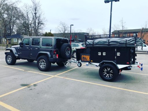

Bought a Crux earlier, basically the same trailer. I'm pretty sure the 1600 is identical to the Tuff Stuff, my 1610 is a little different, shorter and wider I think, with less features on the interior.
ovrlnd_escape
2,822
DeSoto County, Mississippi, United States
Matt
Kephart
13669
Navy
I have the 1600. It’s definitely the same. They are all made in China

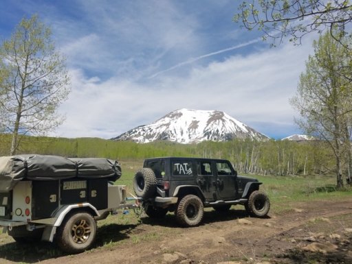

hello all
just stumbled onto this tread. i have the tuff stuff base camp as well. so far have about 4000 miles on it in the last year. several long highway trips with some pretty decent off road trails as well. for the price it can't be beat. but for the price there are a few items to work. BIGGEST issue was this last weekend going to hook up and found 2 of the 4 bolts holding the hitch to tounge of trailer missing the lock nuts and other 2 bolts loose. all 4 bolts were bent as well. lucky we weren't to far from a hardware store and was able to find replacement hardware. these will forever be a pre use item i check. have slowly been replacing all hardware with aircraft grade hardware (perk of the job). did add silicone when replaced the hardware on the rack rails to help with water intrusion / rust inside the cabinets. i also had to replace grease fittings on the hitch due to them stripping out when removing the grease gun. on first use i did have a water pump issue the folks at TS were awesome in helping get this fixed. they shipped me a whole pump assembly in super fast time. turns out it was a spit in the water line at the pump fitting so at that point i started replacing stock water lines as well. i did have a leak at the water tank where the water pump line connects which took some creative part installations to fix. i also found out the wheel bearings seem to be an odd size which would follow with the above wheel stud issue. i did also relocate one of the 28vdc plugs in the fridge area to the door due to when plugged in the model fridge we went with would not slide past the fridge. for the price i feel its a great trailer had i paid the $30k plus i would be furious having to tweak on it. still not thrilled having to tweak on a $13k trailer but makes it easier to swallow. TS was super helpful and ever sent me a few goodies for my troubles with the water pump so customer service always goes far.
