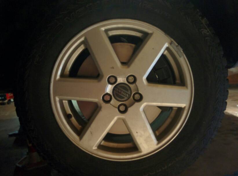

I assume any overland vehicle should start with the basics, big tires. The stock tire size for the XC70 is 215/65R16, the vehicle came with a worn and old set of Pirelli Scorpion STR and General Altimax Arctic, I was able to squeeze some life out of them. With the new set I kept to a summer and winter setup, but for this post I’ll only focus on my Winter/Trail tire. The tire I chose is Kumho Road Venture AT51 in 235/65R17, the size is original fit for an XC90. Normally this tire size wouldn’t fit an XC70, but with a little hammer and heat gun action I was able to get enough room in the rear wheel wells. The fronts will rub a bit at full lock, but I just ignore that.
Tire and Wheel
Flexing
Snow
Trail Shots
I quite like the AT51s. They handle the snow and ice well, loose surfaces and rough roads perfectly, and they have acceptable road manners. I may just run them year round when my summer tires wear out.

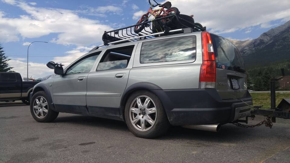

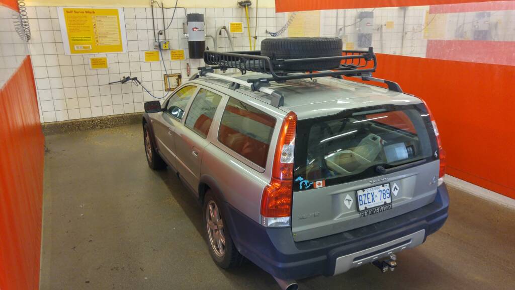

With the kids getting bigger, and our pack getting larger it's time to expand the cargo capacity of the XC, so I purchased and installed a Yakima Loadwarrior with Extension. A few things I like right off the bat, it's stable, it's mounted higher so the hatch can open, and I'm able to load the basket up under the canoe.
The cross bars on the rack are 1" diameter and can accept any rack accessories available. I purchased and installed a set of Yakima Load Stops to keep the canoe centered. Also, paddles are a PITA to store in a loaded vehicle, with a set of Quick Fists I'm able to mount 4 of them to the rack.
The Quick Fists are setup quite crudely using ½” insulated clips and SS hardware.
Ha, and yes, the canoe is quite beat up, but it's solid. I do plan on refinishing the clear to show off the battle scars [emoji48]. The patches are from taking over a waterfall then getting it wrapped around a rock after a swift, thank **** I had duct tape [emoji23] .

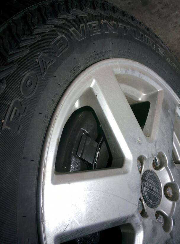

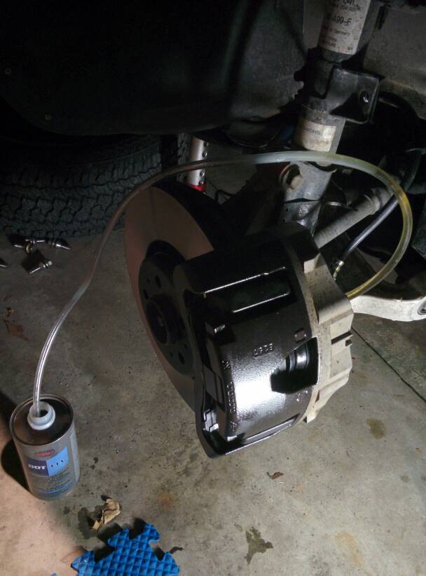

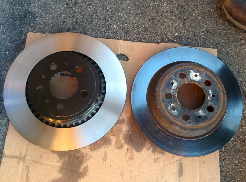

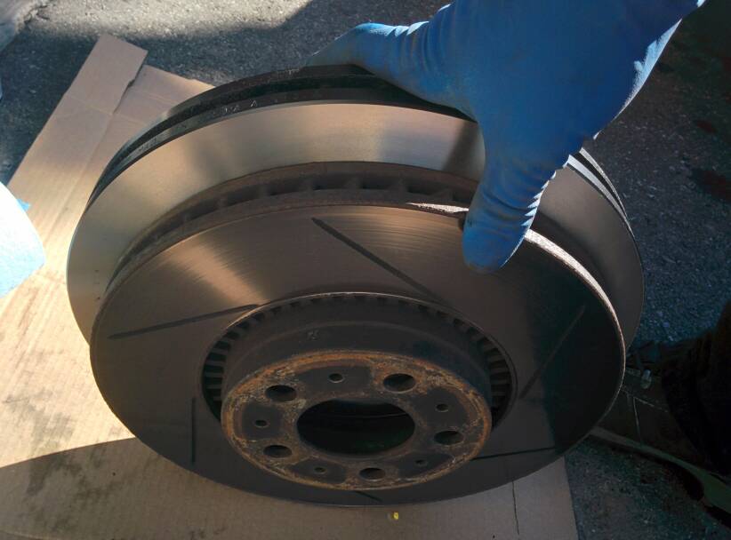

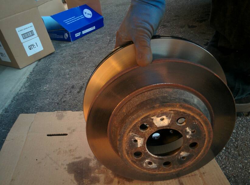

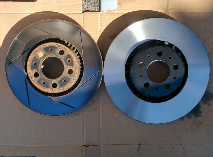

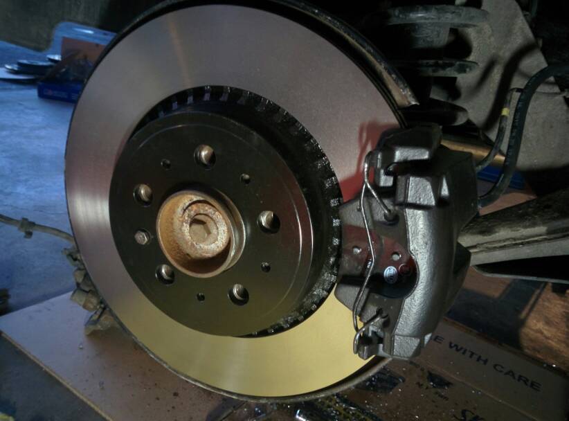

Brake Conversion/Upgrade

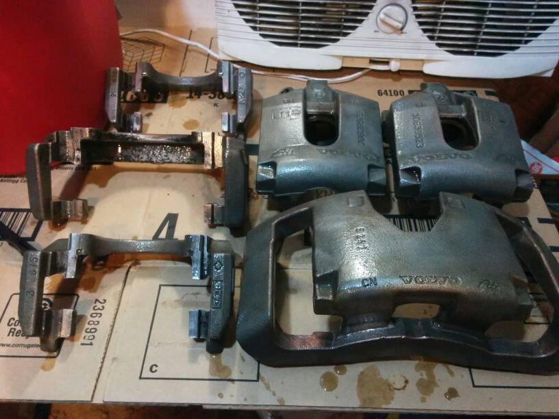

That's right folks. XC90 front and rear brakes. [emoji16] [emoji108]
Rotors are Wagner Premium E-Coated, Pads are Pagid.

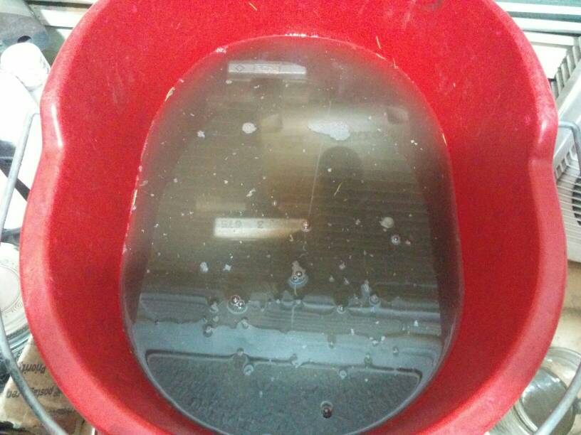

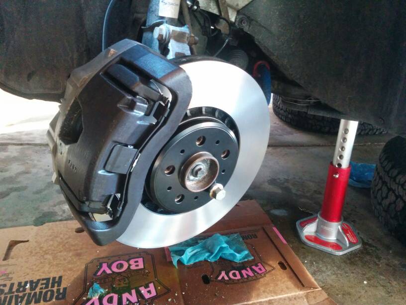

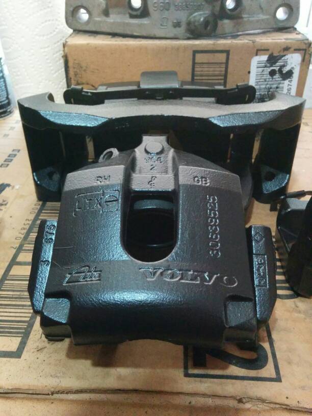

The calipers were a generous donation from a friend and fellow SS member [emoji8], they were well used and were in need of a spa treatment. Once fully disassembled and the pistons ejected they went for a nice vinegar/brine soak to melt the rust away.
... much better.
Now some people at this point would decide on some radical colour to paint their fresh caliper for that ultimate effect behind the wheel. Me being me, I went with the best... Tremclad High Heat Enamel in Flat Black [emoji23] [emoji23] [emoji23]
Also rebuilt the calipers with new boots, seals, pin guides, and hoses.

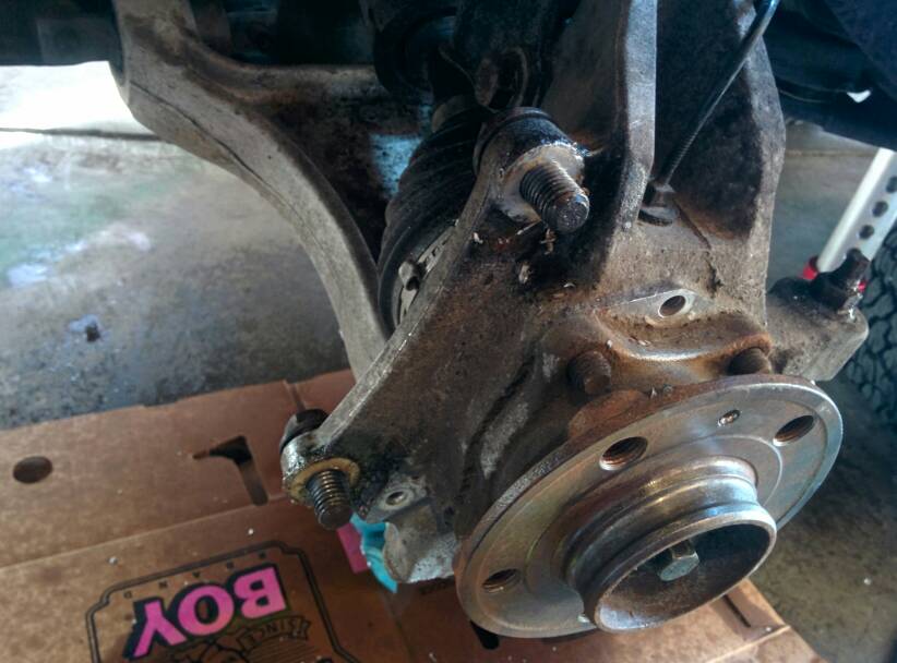

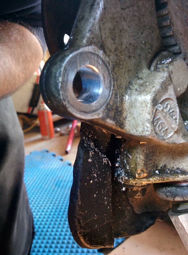

Install was straight forward like any brake job with the exception of the larger caliper mounting bolts for the fronts, and the dust shield for the rears. To mount the front calipers to the spindle the bolt holes had to be enlarged enough for the M14 bolt. I used a 13.5mm or 17/32" drill bit then reamed out the hole to 14mm finish with an adjustable reamer.
[emoji8] [emoji108]
Bleed it.
Slap the wheels on.
...and take it for a spin.
Initial thoughts, they are not as grabby as the old performance brakes but there is a noticeable difference in brake force. I can also feel the additional weight of the calipers/rotors in the steering wheel.
Cheers [emoji482]

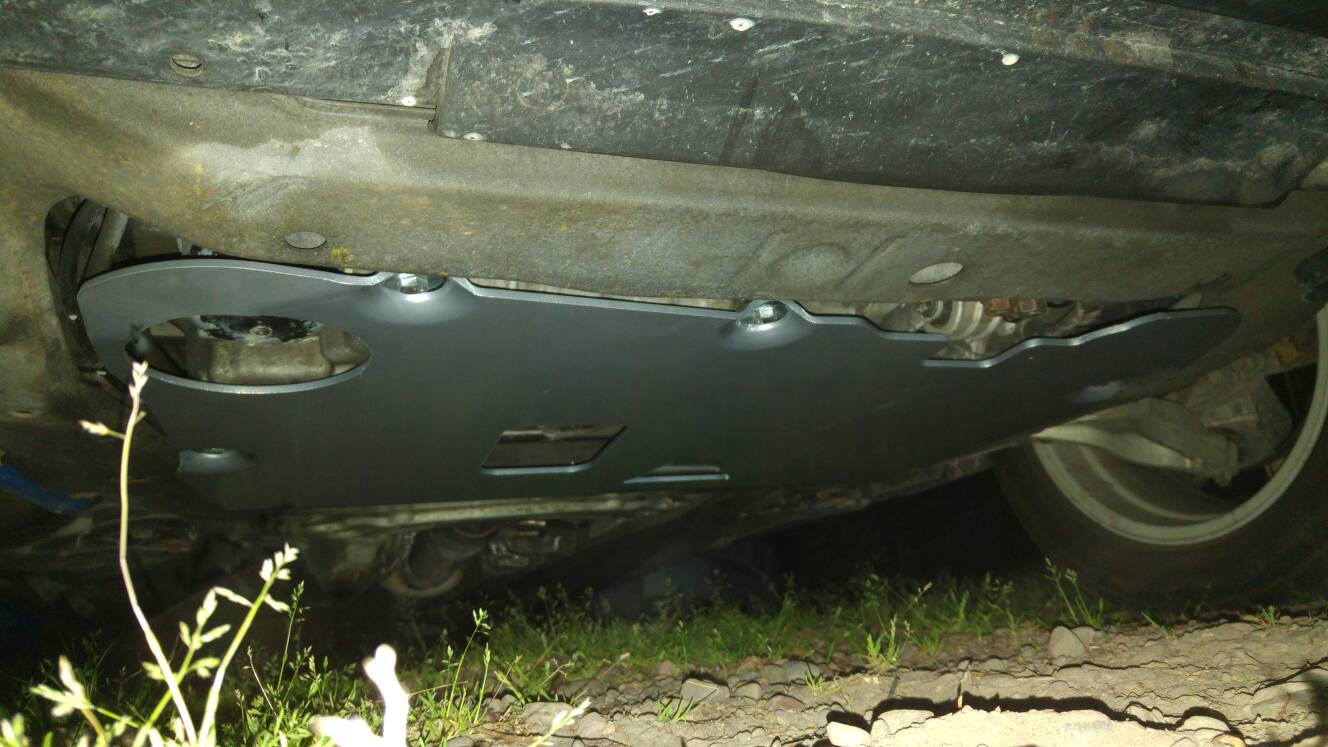

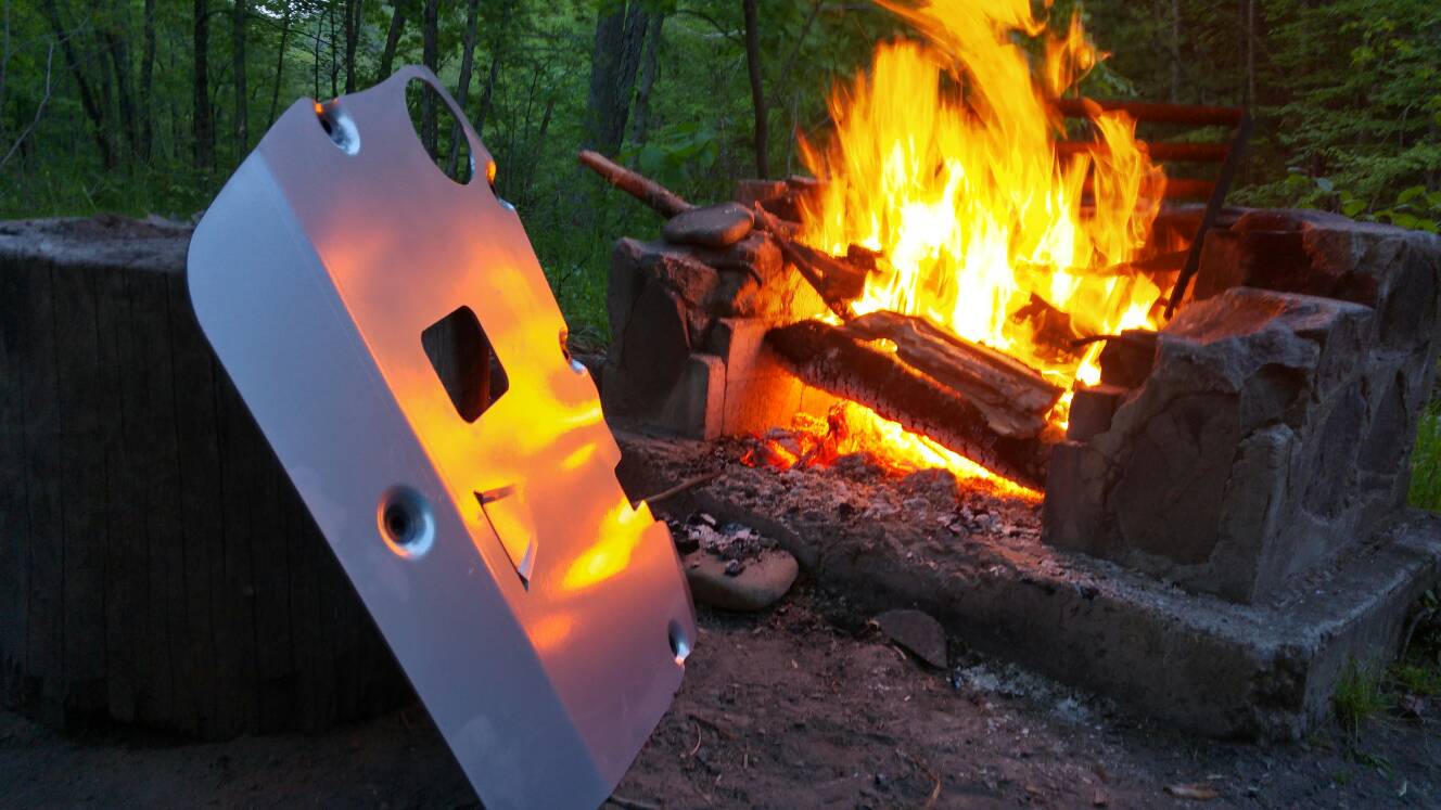

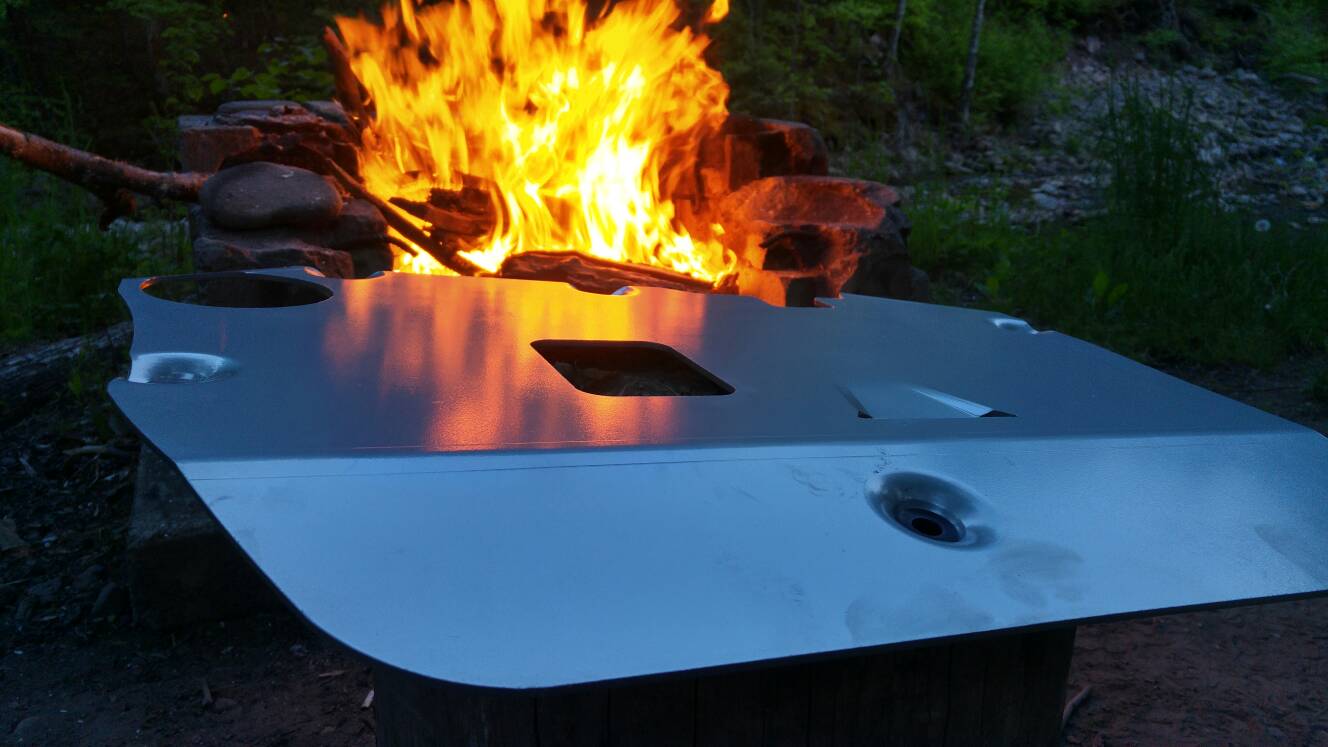

Fire side install of the IPD Skid plate
It has already proven it’s worth saving my oil pan.

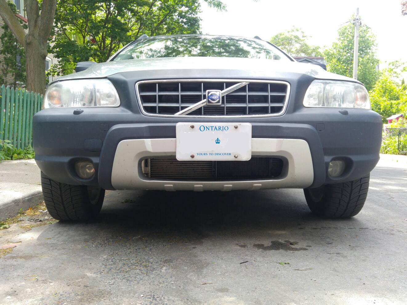

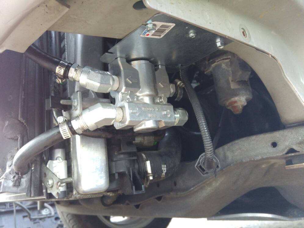

Transmission Cooler and Thermostat.
Cooler is a Hayden 679…ain’t no kill like overkill. Thermostat is mounted firmly in place using an 4-11/16 electrical box cover, 1/4" 20 bolts to mount the thermostat, and self drilling screws in the frame. All hoses and the thermostat clear the splash guard very nicely.

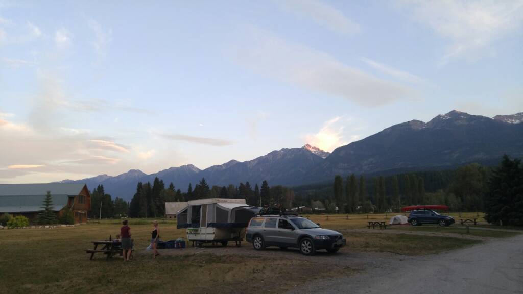

Toronto ON to Kaslo BC 2017
This is our most recent road trip.
Trip Total ended up being 8830km or 5519mi and 110h driving. I did the first leg of the trip solo to Winnipeg, picked up a family member, then drove the rest of the way to Calgary to meet the family who flew in from Toronto. Met up with a few Volvo enthusiasts in Minneapolis on my way through at 1am.
Left Toronto Friday morning, made it to our first camp spot in Golden BC Sunday Night, that’s 4000km/2500mi in 2 and a half days!
She was loaded down!
When the mountain gets in the way...
Camp
The next day set out for Kaslo for a few days.
Our original plan was to leave the tent trailer in Winnipeg and stay with family in Kaslo, but there was a bit of a misunderstanding. So instead of staying in a Hotel we camped out in Kaslo for a few days. Nothing spectacular so I’ll save the pictures. We enjoyed some lazy days with family in Kaslo. Spent a lot of time on the beach.

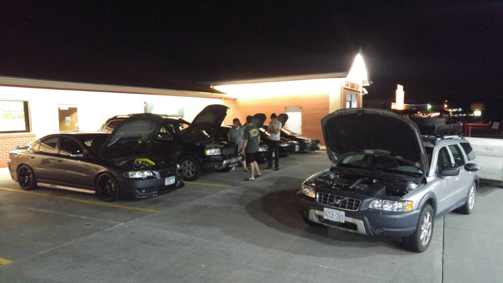

A quick cleaning of the interior to get all the apple cores, spilled drinks, and gummy bears unstuck from the seats [emoji23], and exterior to wash off the pounds of deceased insect carcasses. Also treated the XC to an oil change at The Great Canadian Oil Change. She got a fresh fill of Valvoline SynPower 5w40 and a Valvoline VO66 filter [emoji108].
With the XC cared for, and the wife and kids keeping up appearances with the old folks, I took to the roads for a solo trip to Saskatoon, sans-kiddos and sans-Dutchman to meet a few Volvo enthusiasts.
