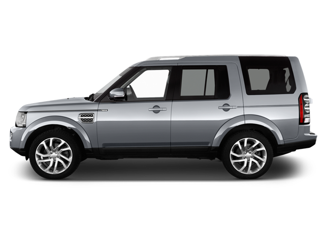

I am looking for advice on a modification I am looking into.

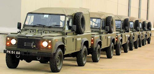

Years ago I was a vehicle tester for Land Rover military vehicles. In 96-98 i was testing the Land Rover Wolf 90 and 110. On these vehicles they moved the wheel from the bonnet (Hood) to the side of the vehicle (See Picture)
So I was thinking on a Land Rover LR4 to replace the driver side rear 7th seat window which is useless for a driver, with a metal plate and wheel mounting studs.
What problems do see beside it killing the resale value?

Well the obvious is that you catch and hit stuff with it. Possibly shear it off the side of your rig. You also create a pretty good blind spot with it directly down the side. Depending on how big and how heavy, the reinforcement needed may be more than just adding a sheet of steel in place of window. All just my opinion but I think there are better mounting solutions for your rig.

Thanks for your reply,
With the Wolf, it didn't make a blind spot but its a good idea to put a mock cardboard tyre up to see if that's an issue. as for hitting things, the only time I hit anything is when off-roading and I was in a deep rut. the tyre was touching the ground on the wall of the rut. Good point.
I was looking at the swing arm on the back but i was just thinking of other ideas as I may want to use the back for fuel and water Jerry cans on a double swing arm.

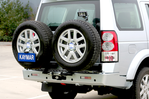

CBI makes a great dual swing arm, tire carrier, fuel/water, and high lift jack. Also small fold out table top.

I replaced the rear driver's side glass on my Rover with a little door, probably similar in shape to the plate you'd want for mounting a spare onto. Main thing I'd be concerned with is the material that part of the body is made of: Aluminum. Pretty sure yours has the same panels in aluminum as my Disco. Not that it can't carry the weight! But what I'd be afraid of is cracking, since aluminum has a tendency to fracture rather than bend when put thru cyclic stress. The weight of the wheel+tire going thru the usual vibration a vehicle has (even more so offroad) would make me nervous. I think quite a bit of the skin of those Wolf's were still aluminum... so maybe the spares have something backing them up, or that area it's mounted to is steel, not sure.
Your idea would certainly look interesting! But there are some nice rear carrier options if you decide to go that direction. Some even offer dual swing-outs:

I am digging the double rear, and I still think you would have plenty of room on the back for other things plus the tire.

Yes as I have looked into what everyone is saying. I’m going to look at getting a double back wheel
