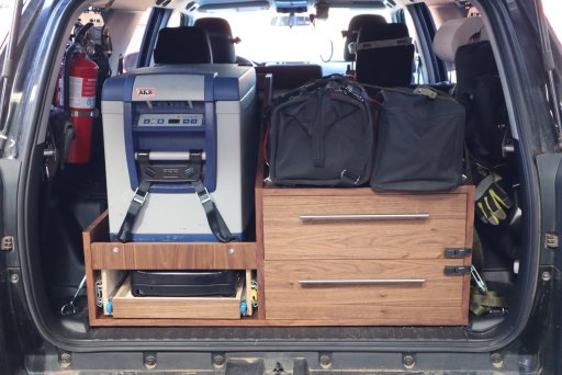

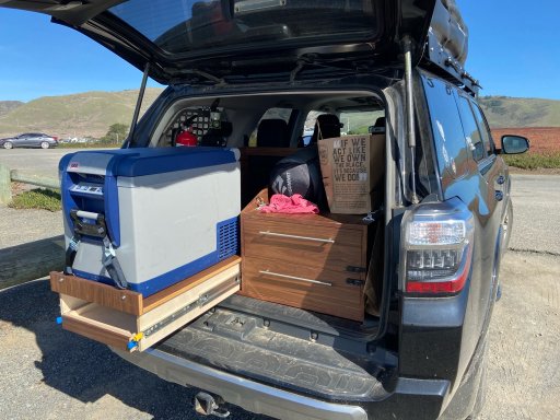

Just like backpacking, making things efficient is still important. When I was building out my 4Runner, if it didn’t add capability or make things easier, it can go to the bottom of the list. I made my kitchen module to fit behind the rear seat. This allows me to use the 4Runner as a daily driver and use all the seating intact. At the same time, all the camping gear is in the truck. For an overlanding trip, I add food to the frig and my bag of clothes and I’m ready.
For my kitchen I wanted space for the stove, frig and storage. Soooo original I know. Things I would change. My frig is 35qt I could easily do the 20qt. i have done a 2week trip with my daughter and the 35 was larger than we needed. I made mine out of plywood because that is what I knew. My next design will be from an 80-20 style To save weight.
here is what I came up with. Over all,it works very well.

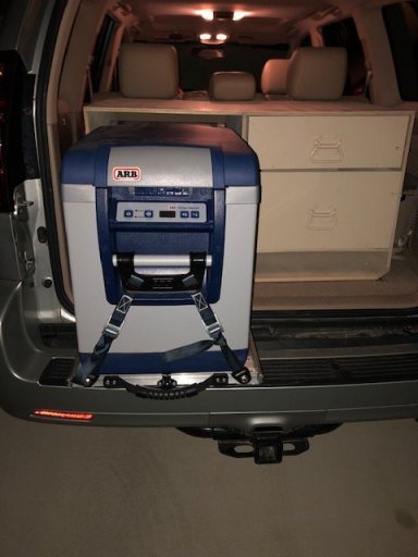

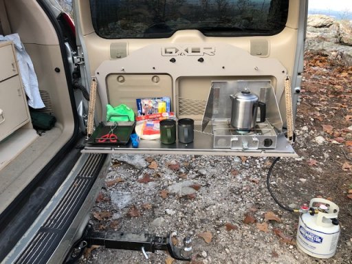

very simple amateurish plywood build. The tailgate table is most excellent. There are severable different ones available for the Wrangler and at good prices. Only option for the GX is high quality but spendy. We use a single burner Cook Partner stove to conserve space but a backpacker Pocket Rocket stove would take even less space. Here again, we use a 5lb propane tank vs. a 20lb to save space. Gas One makes a single burner stove close in size to the Cook Partner but at a fraction of the cost.

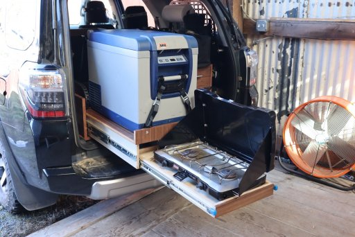

For example, this is what I currently have in the X:
Kitchen is the drivers side drawer (though I may switch that to the passenger side drawer).
Fridge is on a diy tilt slide on the driver's side of the platform. In the drawer, is my gas one dual fuel single burner stove. I don't even take the stove out to cook. Just open the drawer, hook up my 5lb tank (or use butane), and get cooking.
The other drawer contains a family sized cook set, utensils, dishes, cleaning stuff, etc.
I'll be switching to a smaller cook set for solo trips this year, as I really don't need the big family set for just myself. Just a pot for things like soup, and a frying pan. Also a collapsible kettle for boiling water for coffee.
That looks amazing. What do you use to power the fridge when you are in camp? Is there a particular one that is recommended?

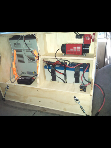

The front side of the kitchen has (2) 35ah batterie, air compressor and base for the ham radio(ftm400). If you don’t think you need 35qt I have been looking at the drawer style dometic frig.
also have an inverter back there.
