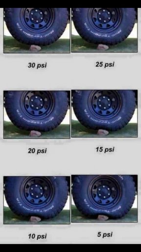

It's pretty amazing how much an aired down tire can fold when going through obstacles. You need a strong sidewall to avoid damage. This is an LT285/70/17 Wildpeak A/T3W at 15psi on a slanted rock. Times like this I wish they were a true 3ply sidewall. lol
Same pressure but on a flat surface. Tires move around a lot more than we usually think. :)

Very well illustrated and explained.
Your tire cross section is definitely wider than your tread width. The tires I just bought are the same width on tread as the cross section. I dont know about rocks but they are supposed to be excellent in sand, water and snow, which is what I encounter the most.
For sure. When at street pressure the cross section is closer to the tread width but since most of us air down off-road I think it's important to point out how different they look and will interact with the trail. :) Which brings up another point Shaun was making. These Wildpeaks appear way larger than the BFG KO2 in the same size and ratings. They spec out larger as well so when someone ways they fit a KO2 without rub, that doesn't mean a Wildpeak or Duratrac in the same size won't rub.
