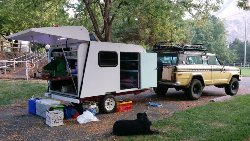

Some people said the Foamie would not make it down the freeway. Well we have proved them wrong. Now it is time to venture into the overlanding scene.
This is what I call the Bug Out. It is economical to build and super light. Working out the "BUG's" to get it to be a capable overlanding/off road trailer now. Took it out on my last trip and it did great!

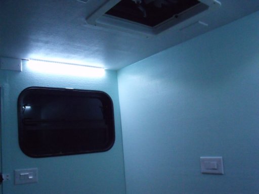

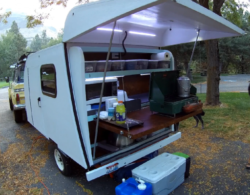

They can be cheap and in general a budget build over a traditional built trailer. Design is in the eye of the beholder for sure. A foamie can be simple, but it can be so much more too. This is my first build as proof of concept. This one came in under $1500.00 and weighs 510lbs.
My wires are not exposed. I channeled the foam to accept the wires and then laid the foam back on top of the wires.
No wood in the galley except the swing down counter. Read my build it's 50 pages with little deviation from topic http://tnttt.com/viewtopic.php?f=55&t=54099 .

In the case of the box style trailer in the video it would be hard for trees to hit it since the body is only 4' wide and my Jeep is 6' wide plus it is about the same height.
I would put a foamie up against a non-back supported aluminum skinned trailer anytime. A backed aluminum skinned trailer would probably fair better against tree branches depending on how hard it hits. Foam absorbs a lot of the impact and keeps that damage localized even on hard hits, usually a easy fix. Traditional builds, at a point, can transmit the damage through the entire structure making for expensive repairs.
A lot of times a foamie will repair itself if left alone. The foam has a memory and will want to return to it's original shape. I have had fairly large dents pop out over a few weeks.
This is why I am fixing this foamie up for Overlanding/4x4 use to see just how durable it can be and to see what mods will need to be made to make it more capable.
You would be surprised just how strong a foamie is.
