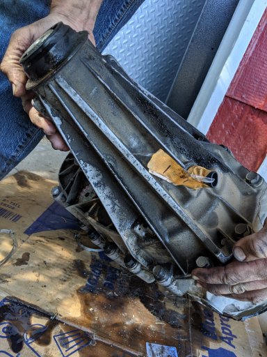

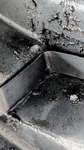

Here's the old Transfer case. You can see the hole in it on the little notch in the case toward the bottom of this photo.

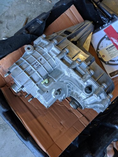

And the new case is up and in. Took a couple days and I had a buddy helping me pull the old one out. Putting the new one in is doable solo, but definitely not taking one out. Holy smokes! Thanks for the help, Alex.

Good ol' GM pump rub claims another t-case. Back in July I took the risk of tearing my t-case apart and putting in the Merchant Automotive pump housing. I could tell that it had been "fixed" before and this one was also on it's way out
Reactions: kilby
kilby
646
Rox Park Colorado
Joel
Kilby
20682
Ugh. Was it also fixed with Black RTV that had clogged up the pump? :grinning:
You caught it before it blew out the side though. That's cool. For mine we were driving back home, and about an hour out we were creeping along in traffic and we started hearing this scraping rattle. First I thought maybe u joints. Then it kept getting worse. And when I got home I found no fluid in the T Case. Pretty sure the gears in the old case are done. So I just went with a complete new unit with Aluminum tail housing.

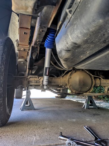

I took some time this afternoon and installed some new rear shocks. I searched around and found the AC Delco Premium monotube shocks. Specs looked a lot like some of the other mono's out there from Skyjacker and Rancho specifically. But about $30 cheaper per piece. I got these on Amazon for about $65 each. ACD part number: 540-5043.
I have not test driven them yet, but they HAVE to be better than the old original worn out paper weights they're replacing. We'll see.

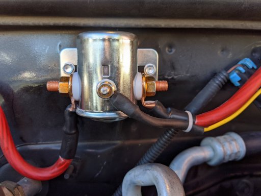

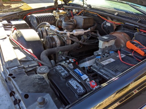

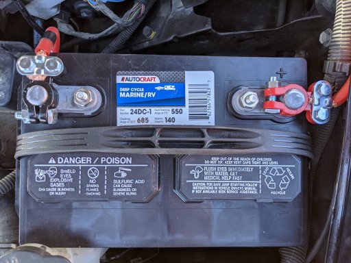

This weekend I wired up dual batteries in the Suburban. I went with the wicked simple, hopefully effective Expedition Portal $50 dual battery idea. Definitely is NOT $50 anymore. But what the hey. It's a simple setup, and pretty easy to fit into the 'Burb. I used the Cole Hersee solenoid to isolate batteries. It's not manually switched; just wired to an ignition-on circuit. And I snagged that Marine deep cycle from Advance for about $120 (It'd be $90 if you have a core to return). Thought about running black 4g for the ground, but decided to just use what I got. So... that's a lot of red wire. I SWEAR I'm not trying to look like a "tuner". lol
Right now I'm just planning on hooking up a big inverter for some general camp/roadtrip items, aux lights, and such. Nothing major, but definitely need to power stuff without having to run the truck.
