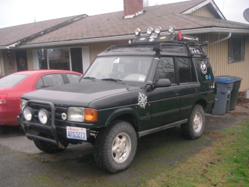

If you're not going to rock crawl...then upgrade your suspension, but DO NOT lift. These vehicles are designed to drive sideways at a 45 degree angle without tipping. Once you lift it you raise the center of gravity, and you will roll...lol. Same with bigger tires. These vehicles are prone to power steering and ABS issues...but I love 'em! I am running 30x9.50 Goodyear Dura Trac's....Stock size but aggressive tread. Alpine rated and imo better than the Goodyear MTR's as I have used both. In total stock form, this vehicle is amazing. Learning to drive and use your vehicle as well as familiarity with your vehicle and it's limitations...is very important. I've known people who buy an offroad vehicle, put thousands into a build....and they're always stuck in a friggin' ditch...because they have no offroad driving skills. I've known people in a bone stock S-10 or Subaru who have driving skills that have negotiated near impossible obstacles. So knowledge is as important as the build itself. Mine is a 1999 Series I Discovery SD. I have built and designed 90% of my upgrades, including the snorkel kit...Here's a pic of mine...DSCF5033.JPG my name's Alan, nice to meet you, Welcome to Overland bound!
