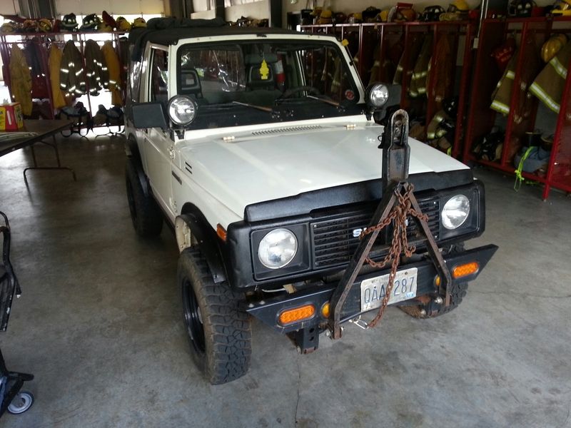

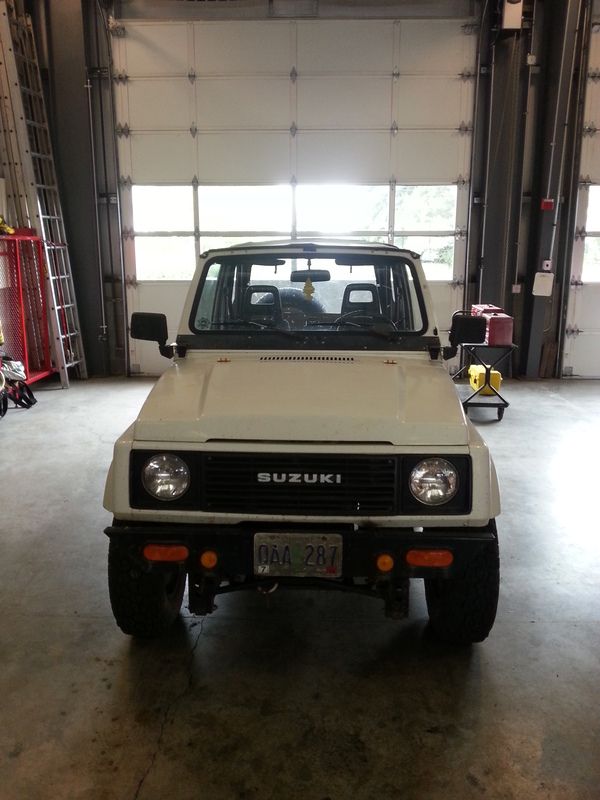

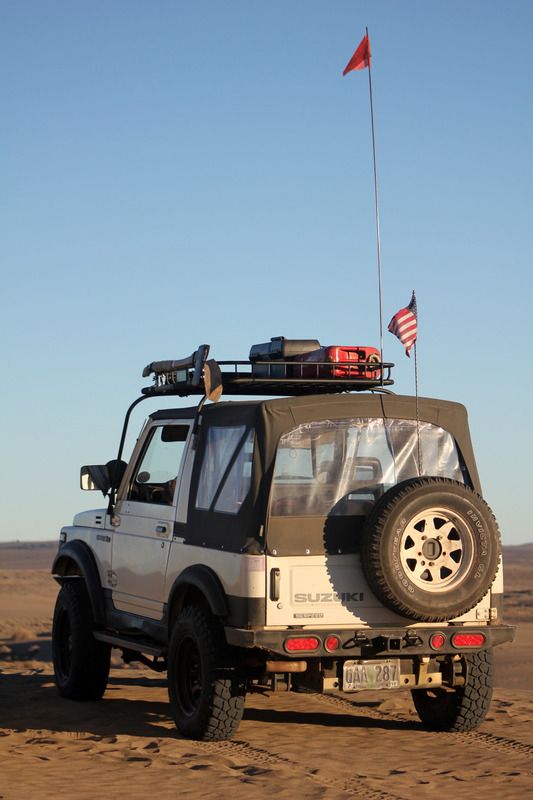

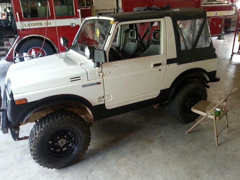

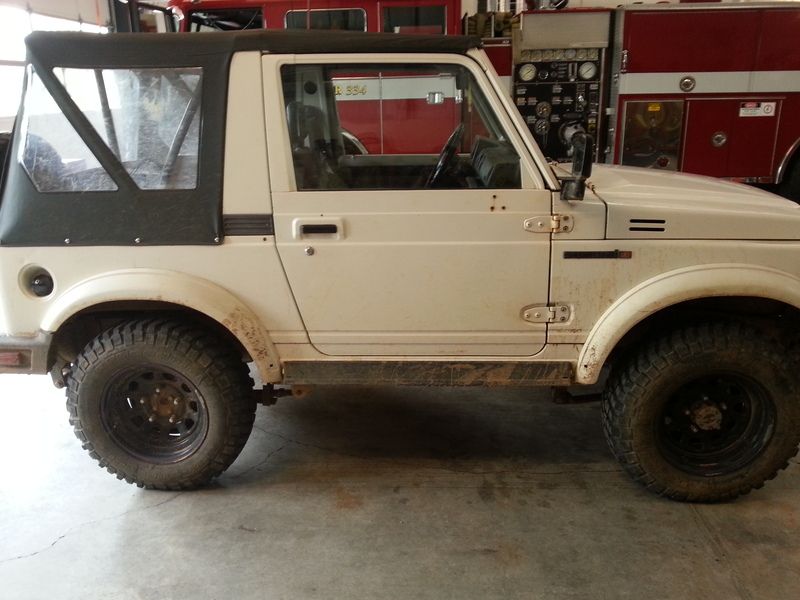

I got my little sammi, Rosie as she is so named, about 3 years ago and she has been a work in progress ever since. I am sure that she will always be a work in progress, which is fine by me!
It had a few modifications done to it when I got it, the PO used it as his hunting rig occasionally, but not much else:
-15 Gallon gas tank upgrade
-2" Calmini shackle reverse lift
-1.6 8v Sidekick engine
-Homemade rear cage-ish thing
Then I started working on it, and making improvements where I saw the greatest need and where the funds were available:

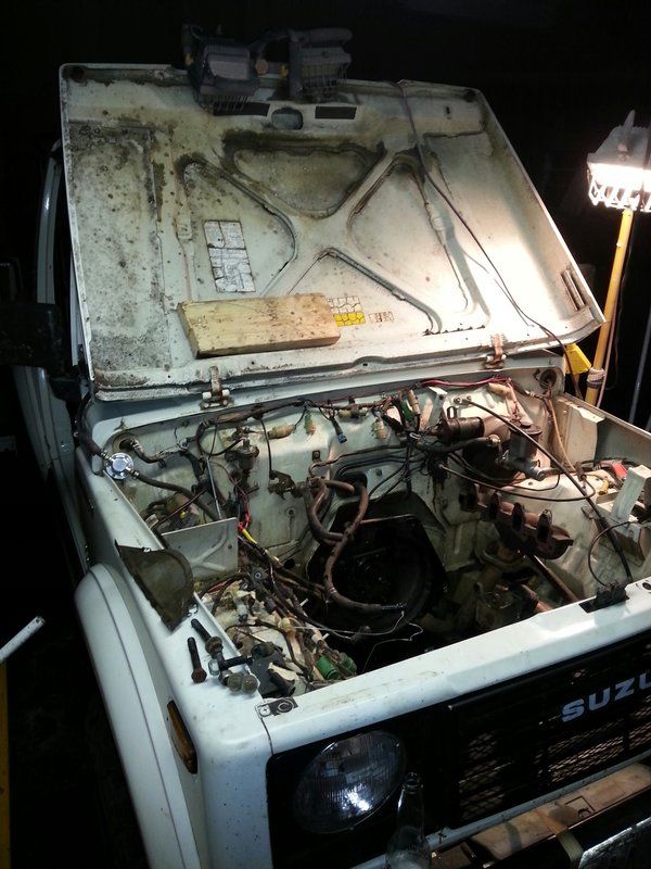

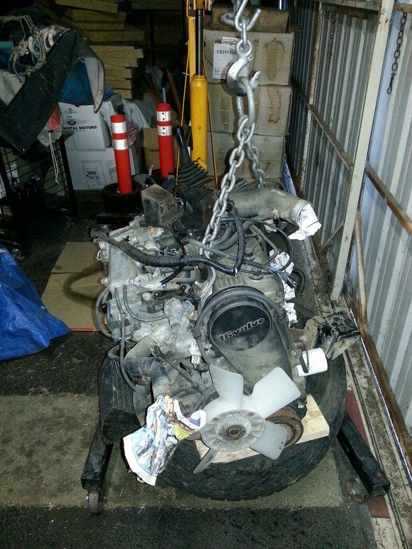

-The 8v blew, so I scored on a 16v Tracker engine with wiring harness and everything else needed. I got a new Petrowerks mount kit for the engine and transmission to lower everything to make the engine fit
-1" body lift to help the engine fit

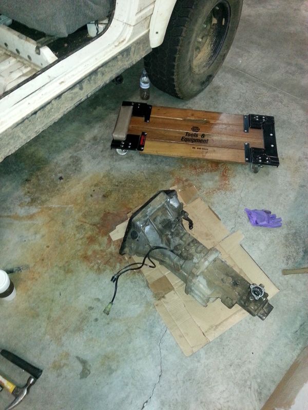

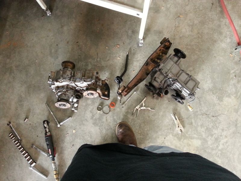

-Replaced the Transmission and Transfer case, both of which had not been rebuilt properly and blew up on me.

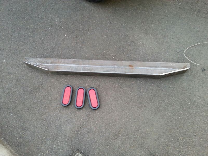

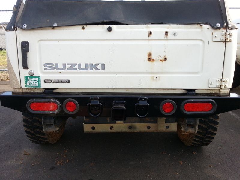

-I made a new rear bumper and rock sliders
-Spartan auto locker in the rear
-Stereo, most important improvement so far!
-Roof Rack
-100amp GM alternator
-Electric radiator fan
-Bedlined the outside
Everything has run great since the changes that I have made for about 2 years now, been driving every single day!
As for the future, these are some ideas I have:
-I will make a new front bumper with a winch on it
-All LED lighting
-Spring over lift (soon!)
-Spartan locker in front
-Dual battery setup
-The list will probably be added to!
And here she is today!

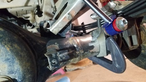

Then came the axle.
I cleaned it off where the perches and shock mounts were going and welded the perches on.
I mounted it to figure out where exactly I wanted the shock mounts.
Everything was then welded on and tonight it paint night!
To be continued...
darthyota
Looks good so far, but just so you know mount the shocks like this / \ is not very good for vehicle stability especially if you plan on carrying heavier loads or towing a trailer
