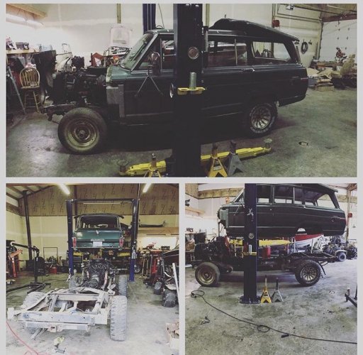

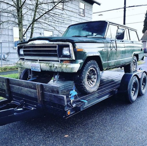

86 Jeep wagoneer ex forest service build. W/ diesel swap
Natecr

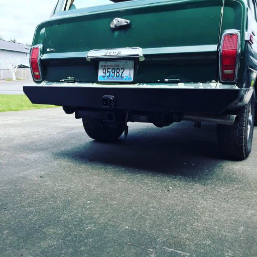

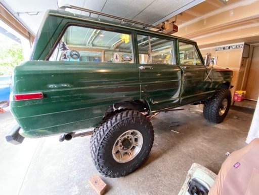

Hey there! Some details on my build
Originally bought about two years ago. Had a cracked frame separated tires and a 360 that “ran” and a 727 that appeared to have motor oil in it. [emoji15]
Got the 6.5 diesel test fitted,
Ended up finding a mv4500 and np241c set up. Little did I know the 241c was gonna require plenty of mods to get the mechanical speedo to work as well as a front drive shaft, the Chevy has a odd front output that requires milling out 1/4” of splines to get a dodge flange to work.
Current mods
3” rough country lift
1”body lift
Crappy 31” hankook at’s
Gm 6.5 diesel
Nv4500
Modded 241c
Dual battries
Dana 44’s w/2.72

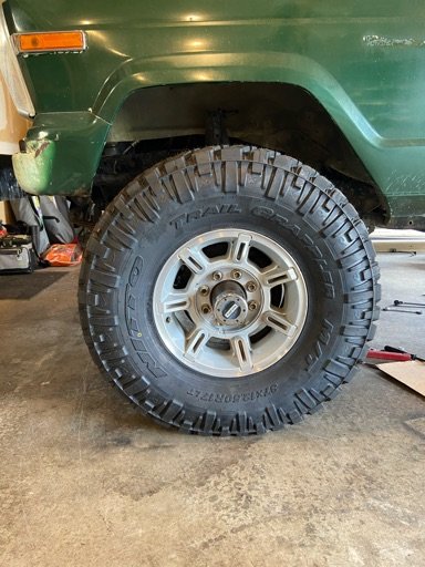

Next up:
33x10.50’s
4.10’s
Locker(s)

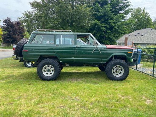

Took it out in the snow after thanksgiving
Natecr

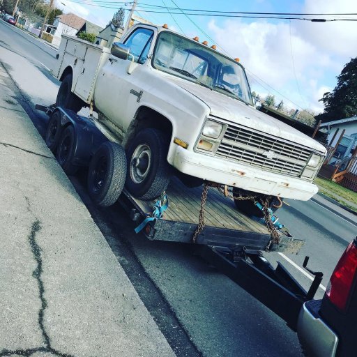

Welp I picked up this Chevy k30 for 600$
Has a sbc
Th400
No205
Dana 60 front
14bolt rear
So now I’m debating on how I’m approaching my build.
Do I install my gears and lockers I’ve acquired and buy/install 33’s
Or for a wash in money (after I part the truck and my axles lift, lockers ect) do I adapt the 205 install the one tons and put 37’s on this?
Billiebob
2,835
earth
Bill
William
18893
As an overlander I'd go the 33s route.
The bigger the tire the worse the gas milage, shorter the range.
Gorgeous truck tho.
Wheres the Wagoneer ?
