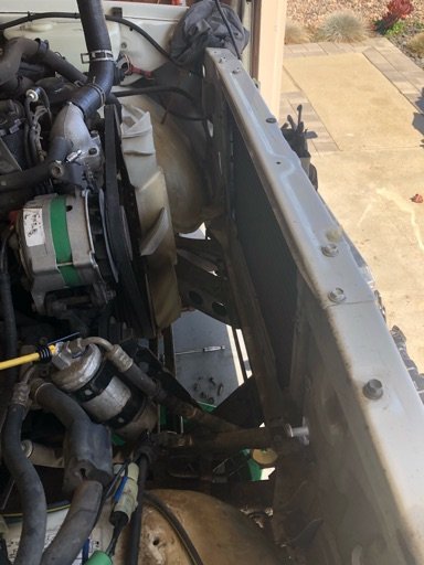

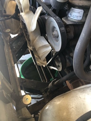

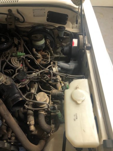

Pulled the old radiator today. Had to remove the grill to get to two bolts behind the AC condenser, battery tray, fan shroud and lower skid plate. Pretty straight forward, took about an hour. New radiator fit is very good. Not completely installed going to replace belts and hoses now that I have more room with the radiator removed.
cool, I’m sure as you continue with baselining your Cruiser you’ve come to understand how over built they are.

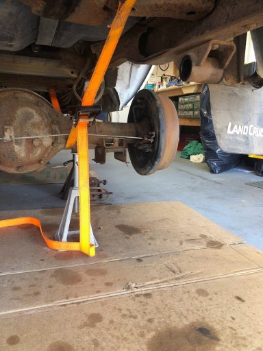

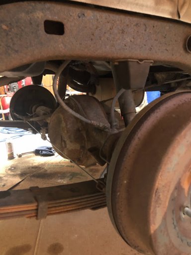

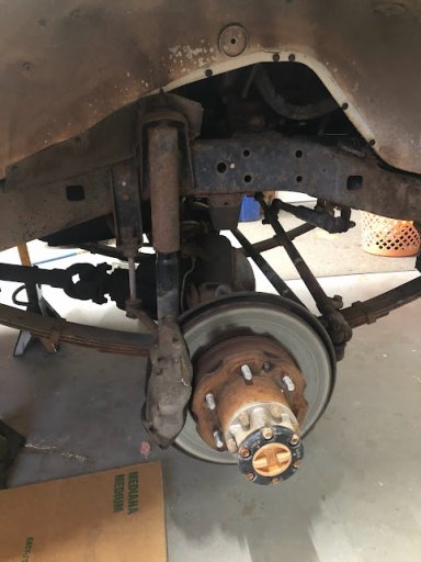

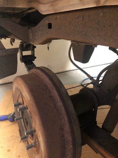

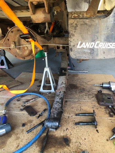

My lift kit is in route so I thought I would put the rig up on jack stands and spray all the bolts with penetrating oil. With the axle being on top of the spring I will put stands under the axle then drop the leaf springs leaving the axle on the stands. IMG_1951.jpgIMG_1952.jpgIMG_1953.jpgIMG_1954.jpgIMG_1955.jpgIMG_1956.jpg

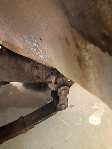

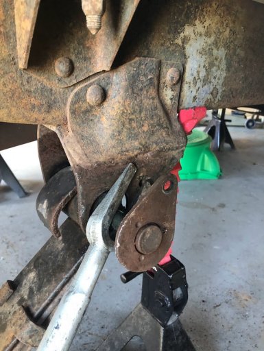

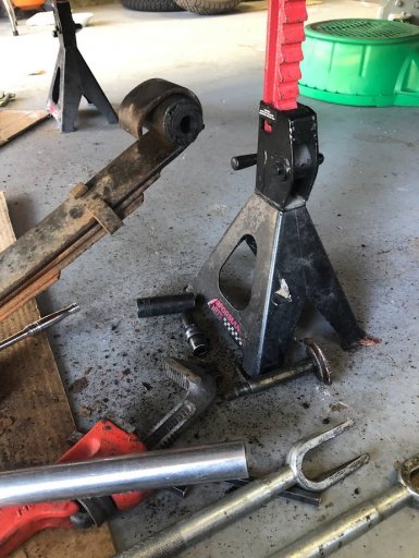

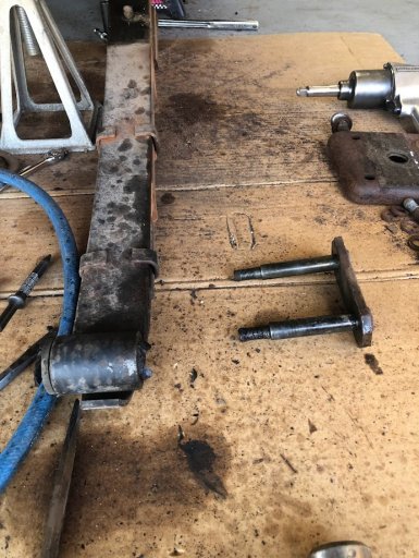

Busy weekend! Pulled off one leaf spring, not exactly setting any records. So the nuts all came off with no hassles but the forward pin and rear shackle whole different story. The rubber bushings did not want to let go. Took lots of PJ Blaster and every method of prying I could think of. Air hammer was useless as the rubber just absorbed the shock. So prying and twisting was the battle plan. Four hours later one spring out. I used a cargo strap and a trailer stabilizer jack to support the axle while the spring is out. IMG_1961.jpgIMG_1962.jpgIMG_1963.jpgIMG_1965.jpgIMG_1966.jpgIMG_1967.jpgOther springs will be next weekend. Once all the springs are removed I will paint the frame with POR-15.

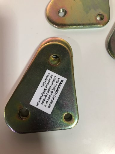

Well after seven weeks of waiting my lift kit finally arrived! I am happy with the quality of the parts but disappointed that one box has the wrong parts. What a bummer the rear shackle kit has mismatched side plates. On another note Leaf spring lifts are so simple compared to coil lifts. No control arms, track bars, drop brackets, etc. With leafs all you need is springs, shocks, u-bolts maybe brake lines if needed and your done.

Good to know! Unfortunately the the company I bought the kit from (Cruiser Corps) is in no hurry to make things right but I have rear shackles ordered from Cruiser Outfitters and they have been great to deal with. They will be my on line source going forward on this build.
My suspension install has resumed. No thanks to Cruiser Corps after two weeks still no answer on how they intend to replace or refund me for the rear shackles. However made a call to Cruiser Outfitters and three days later had the parts I needed to continue my project. Hope to make some progress this weekend with some pics.

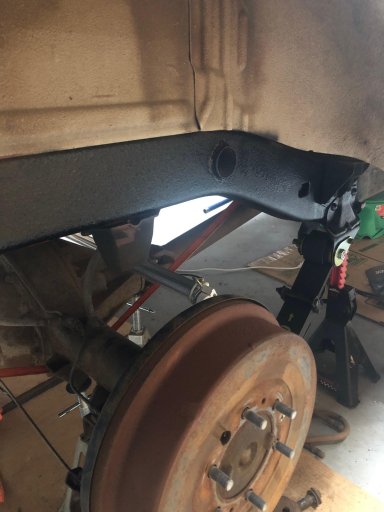

Spent the weekend wire brushing and painting the rear frame and installing new rear leaf springs, bushings and shackles. This kit has greaseable shackle bolts with zerk fittings. Makes it easy to maintain. Next up is replacing brake hose with a longer hose and longer diff vent hose.

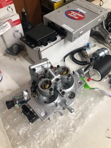

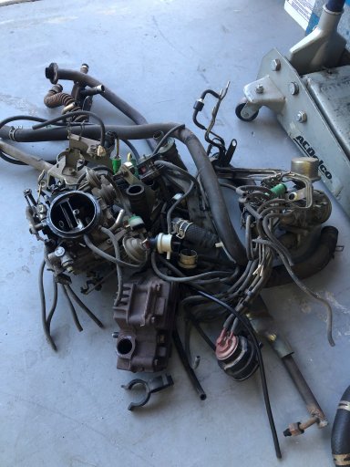

Now that the suspension has been installed, I have started doing a de-smog in preparation for fuel injection. What a ton of garbage! Removed at least 40 pounds of tubes, valves, switches and brackets. Will install a EGR block off plate and install plugs where the air injection manifold used to be. Then need to re-install vacuum lines for timing advance, Fuel vapor canister and PVC system. Once I get the fuel injection installed I think this will run cleaner then it did with 35 year old technology. The fuel injection will use an O2 sensor in the exhaust to control fuel mixture. Way cleaner then trying to re-burn exhaust with un-burn fuel. The cat is still and functional. Top picture is after removing all the EGR control system.
Step 2 My fuel injection is here!!
