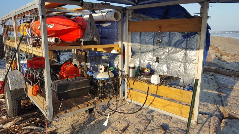

Scrap 2x4s can keep things from sliding around.
Here's mine, but I'm undecided on enclosing. At the beach I put a tarp on the front to keep the truck from kicking up sand and just deal with the rest. When not traveling I throw a heavy tarp over it and tie the corners.
Note the fold out cook top made from some heavy expanded metal. It hangs on the cattle panel using some threaded quick links and held level with a loop of light weight chain.

Sand finds its way into everything so I didn't bother to try, at least here most of it blows away. This way I still have a level of security but can also reach through and move stuff around.
I've been considering building the expedition box but I just haven't seen it as being worth the investment in materials. The kayak rack can be removed easily to turn it into an open utility trailer if I wanted. I already have an idea for panels to fit on the outside to enclose it but then I get to the space that stuff takes up and the money to build it, too little gain to be worthwhile for me.
