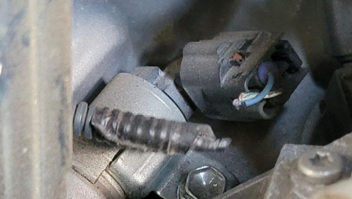

So I went to fire up my truck this morning and it seemed rough. Immediately the CEL came on, along with the TRAC light and a message thar Multi-Terrain was not available. Found my ODB reader and an app and got these three codes:

Under the hood I found a broken cable going into what I can only assume is Cylinder 3 (per the code above). See attached photo:
4RunnerTRDOR2018_cylinder.jpge
Apart from the fact that the cable seems to be originally very short and that it looks suspiciously cut (I don't suspect any foul play though), how easy is this to fix? I obviously don't want to move the car 60 miles to the nearest dealer.
Anyone know the part numbers? I have someone driving up from Atlanta that could bring any needed replacements, if reattaching the cables somehow doesn't work.
Thanks in advance for any help or advice.
Cheers!

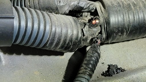

So, fixed that and same codes kept coming up. Did more looking into the engine bay and found an entire chunk of cable missing on the other side. Hypothesis now is some kind of rodent feasted on my harness last night.
Oh well, time to get some more work done.

So, to wrap this up... my 4Runner is back up and running. The local (one hour away) Toyota dealership (Milton Martin Toyota) did a wonderful job and had my car ready in a day. Total cost of repairs was $395, mostly labor. Now I know which extra spares I need to carry with me just in case this happens again (or in the field!).
One weird thing... before this happened, whenever I filled my tank, the display would show 300 miles range (which wasn't necessarily accurate, as I get almost 400 miles on the highway). But now, after this, when I fill up it reads 419 miles. I'm assuming something is a bit off with all the electric work that went on. I'm due for a service when I return home anyway.

They had to put in new sections (and new terminals) as in some areas the rodent chewed off the entire wire (I actually found the entire wire chunk stuffed behind the battery).
And yes, battery was disconnected for this. However, since I bought this car (new) I've only seen one number when I fill my tank (it never seems to learn). I'll see what happens now.
