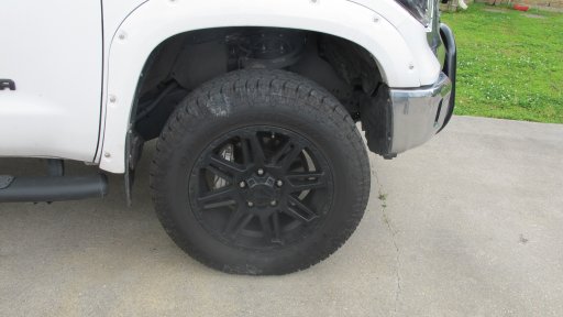

I have Toyo 275/65/R20 tires which are right at 34" and ride great with no rubbing with a 3" leveling kit. I think the stock Tundra is a tad bit low, but the leveling kit was enough to put these tires on it and gain a few inches of clearance without spending a lot or doing a lot of mods.

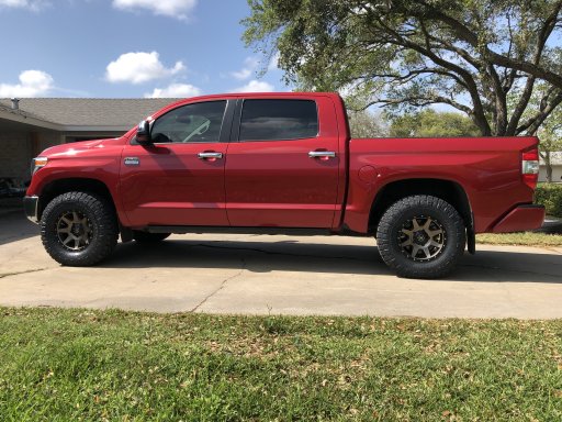

I have bilstein 5100’s on middle setting which gives about 1.5” of lift. Rear is stock. I went with the same Icon rebounds wrapped in Nitto RG in 285/75/17 (about 34”)
There is a noticeable change in braking and acceleration. It’s more sluggish. It’s worth it in my opinion but I’m glad I didn’t go larger.
35” you might be looking at a body mount chop as well.6B6AE784-FCAF-4AC0-B770-4FC87F8E813A.jpeg

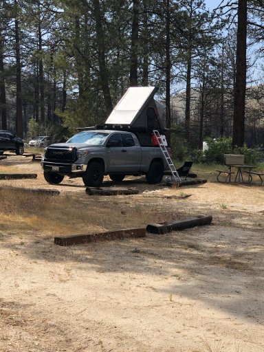

Went with 35's from vendors suggestion. Lost 2-3 miles per gallon. Run 70+ mile per hour and RPM's are low. For me it keeps me more modest in regards to being an aggressive driver. No issues that I can account for. Running Icon stage 6 and the ride is great. I felt if I don't like the 35" tires I can go back, whereas if I went with 33" and no mods I would still have to mod if I wan to go bigger. Still in the learning stage and the consensus seems to be 35" over 33". This is a Tundra, not a tacoma. If you are going to start mods, then you better be ready to spend money. It's a hobby...have fun and if you fail make adjustments. Seems everyone has an opinion on what is right or wrong...pick what fits in your world. I just went through a discussion on compressor vs power tank. Well power tank work for me cause I work in IT and can use it to blow out computers.
