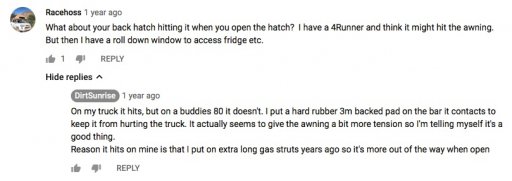

Here's a link to a video review of an Alu Cab Shadow awning on a Land Cruiser.
The lift gate is shown extended at about the 45 second mark during the video and the question is addressed in the comments (see below).

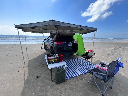

I have a Body Armor 4X4 270 awning on my rav4 and have this issue. I have my fridge on sliders in the back and can barely get to it with the awning deployed. I was just in my garage messing with it and found that I could just detach the awning from the brace and swing the brace out of the way and let the hatch hold up the fabric. Of course I didn’t take a picture . I need to do some more messing with it to see how well this will work in the real world but in the meantime I thought I’d throw in my $0.02

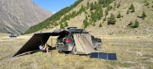

In the UK Direct 4x4, ARB or Bush Company all do a awning that self supports.. the challenge is the rig and how high you need to mount it.. On the Grand Cherokee its impossible.
Not impossible but not practical although as long as there isnt a beam that passes over the tailgate you could drape the end over it with a pole off to one side, the Disco tailgate is quite flat and doesn't lift so high .

Quince
17393
The problem on the GC is you would have to move the whole awning about 18" further towards the front to be able to accommodate the cross over bar on the 270. The best actual option is to have 2x 180.. That is then a whole different game.

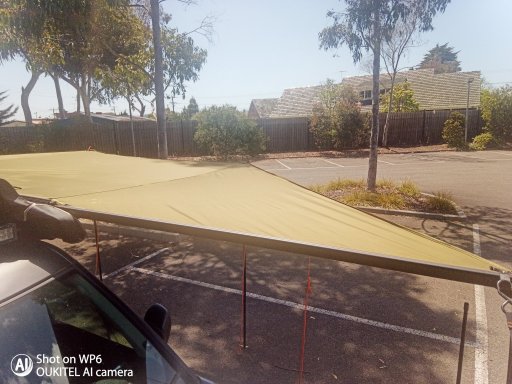

Bought a 23Zero Falcon 270 awning last week and had a quite day at work so opened it right up in the carpark, my tailgate lifts to a pretty much horizontal position and back of the awning fits over it nicely.
Also sits low on my Rhino platform rack which helps for clearance in carparks and drive thrus.
