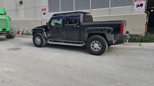

I run Falkens on almost everything. Wildpeak AT3W on the Samurai, Suburban, and H3T. I run Falken Rubitrek A/Ts on the Touareg.
In the past, I have run Goodyear, General, BFG, and Firestone A/T tires. The Falkens are better tires in every way.

The AT4W is right at 10 pounds heavier per tire than the AT3W in a 35" size. I just mounted the AT3Ws on my H3T because I didn't want the extra 40 pounds of rotating mass.
