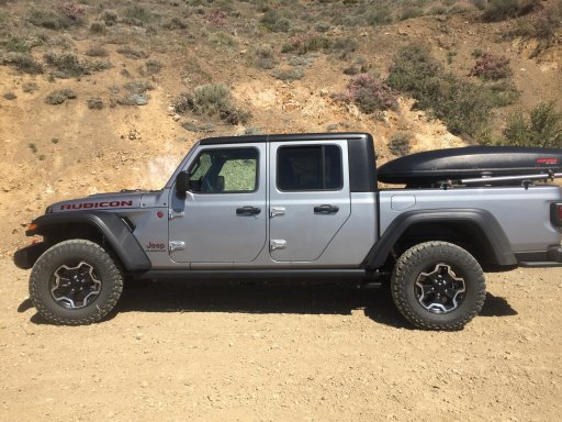

So I'll begin by an introduction. It is a 2021 Jeep Gladiator Rubicon powered by a 3.0L Turbo EcoDiesel engine, and Jeep's 8 speed automatic transmission. The stock suspension on the Rubicon model is slightly taller than the the basic model, and it comes with Fox 2.0 shocks front and rear. Heavy Duty Dana 44 wide axle front and rear. Wildpeak 33" mud terrain tires.
There are steel "rock rails" running along the cab and the corners of the bed.
It has the leather interior complete with heated seats (and a heated steering wheel - a first for me).
There is the customary USB connectors on the back of the center console, but there is also a regular plug with a 400w inverter as well.
Many of the JT/JL's were spec'd out with the 7" touch screen, but that model uses the Apple/Android CarPlay for it's navigation. I wanted the actual satellite navigation, and luckily this one was outfitted with the 8.4" radio and premium audio system.
You also might notice in this picture that there is a selector switch for factory front and rear lockers (the red panel). Just beside that is an electronic sway bar disconnect for additional articulation, and an "Off-Road Plus" selector for certain terrain situations.

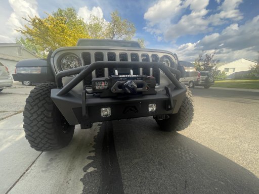

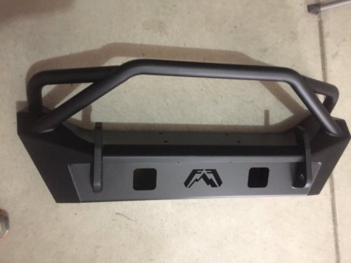

I spent quite a bit of time looking at the various bumpers out on the market. My JT came with the basic factory plastic front bumper. I kept my Smittybilt X2O 10K winch from my Toyota, so I needed to get a bumper that was winch ready. I had always liked the FabFours stuff, and I decided on their stubby bumper. About $550
It uses the factory fog lights, you could upgrade to a square/round LED aftermarket light later down the road. For my purposes I decided the factory ones will do for now.

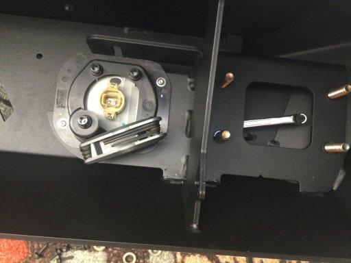

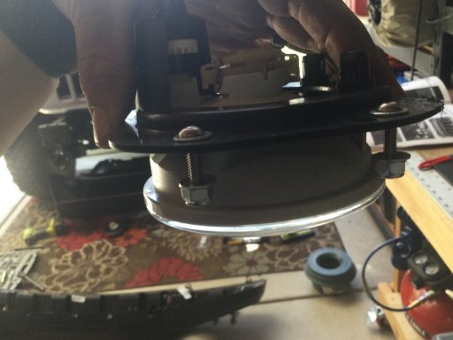

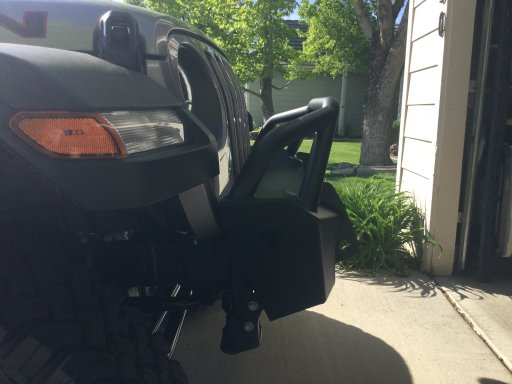

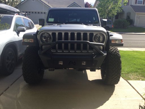

The removal of the factory bumper is pretty straight forward. A few bolts on either side, and disconnect the fog light harness, and the bumper comes right off. The fog lights come out fairly simple, and there are several panels you need to remove to get to the harness, but, again, pretty easy.

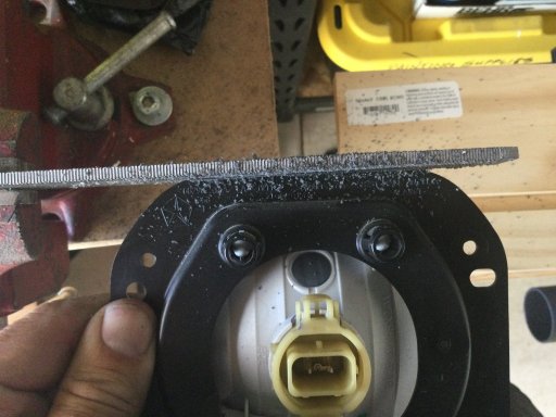

The FabFours instructions are easy to follow (pictures mostly), and there's not really much to it. I did run into a couple things I thought were worth mentioning. First, they tell you to remove the factory skid plate, but it neglects to say you need to remove the bracket as well since it interferes with the bottom of their bumper. As such you cannot re-use the factory skid plate (which sucks because the Rubicon one was a nice steel one). FabFours offers a bolt on lower protection for an additional $200. I have one on order, but it hasn't arrived. The second item deals with the installation of the fog lights.
First, I found the upper portion of the plastic frame for the fog lights interferes with being able to line up the holes on the mounting brackets built into the bumper. I clamped a file into my vise and ran the housing back and forth until the holes lined up. Again, not hard, just a little time consuming.

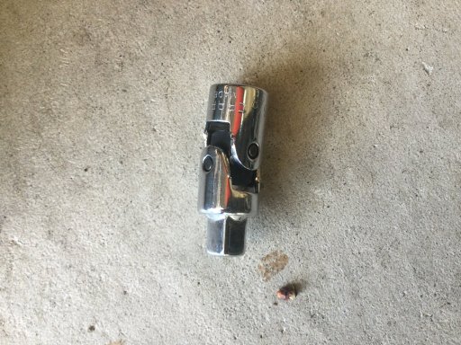

Second was tightening down the bolts was a little tricky as you had to blindly come in from the side and kind of feel around until you could get the wrench on the nut. I found an offset wrench worked best for the task.
Lastly, getting your hands in to place the nuts and washers on the main bolts was tight to say the least. I was able to get the washers on by hand, but I had to place the nut in the socket and use and extension to get them threaded on by hand. When it came time to get them tightened down it helped to have an articulating socket extension, a couple different sized extensions and an impact wrench to snug them down.
I'd say it was around an hour from start to finish. I like how it turned out.

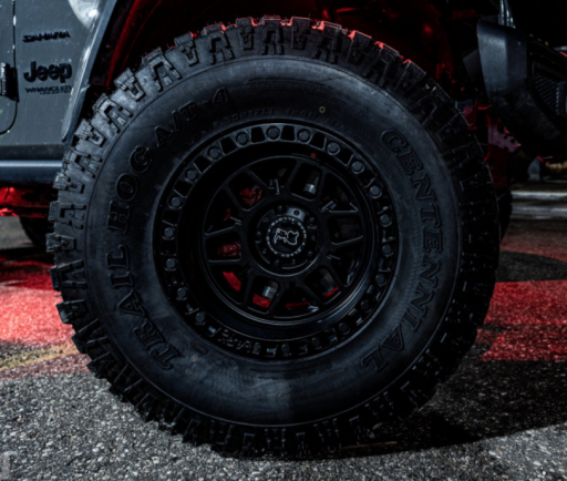

Today I ordered up a set of Black Rhino Kelso 17x9 wheels with a 0 offset. It should move the wheels out a little, but not too far. Eventually I'd like to go to a 315x70x17 - basically a 34x12.4 - but we'll give these 33" Wildpeaks a go for the time being.

Got the Smittybilt winch installed today. There’s not much room in the engine bay with the diesel, but I was able to run the wires up the passenger side of the grill and engine compartment. The positive wire was just long enough to reach the terminal.

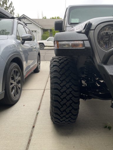

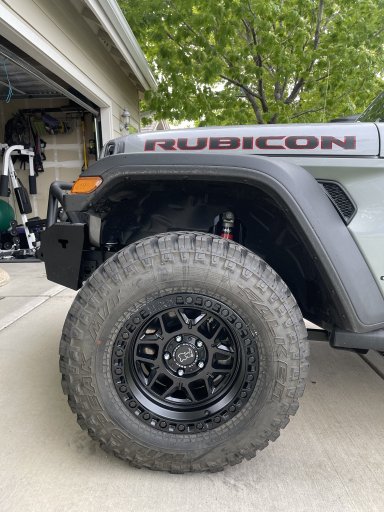

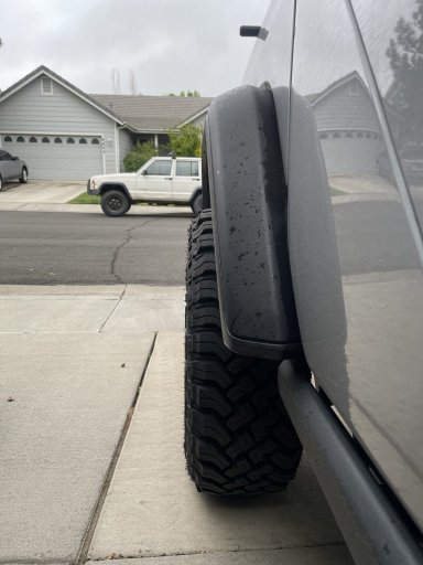

Got the Black Rhino Kelso wheels installed today.
The stock Jeep wheels were 17x7.5's with a +44.45 offset. The new wheels are 17x9.5 with a 0 offset. The tires sit just slightly outside the fenders giving it a little wider stance.
My plan is to upgrade to either a 35.12.5, or a 315x70 (both about a 34.5), at some point. Even on stock suspension I think there would be no problem with rubbing, but my plan is to go around a 2" lift later this year.

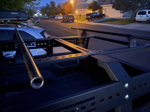

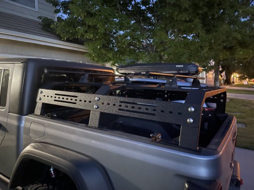

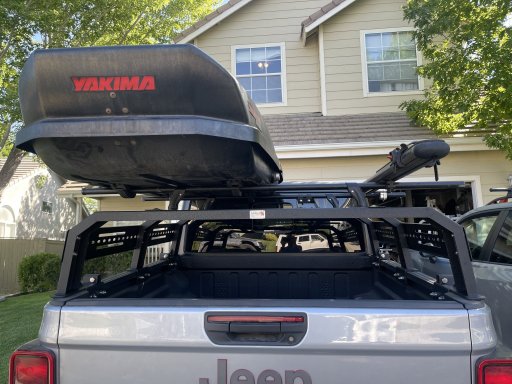

Seeing as my shell won't be done until the end of Summer, I had to make a decision. My Yakima bedrack was functional, and since I already had it, I have made it work. I did have some issues of trying to fit a few larger items in the bed of the truck without having to take the rack (or just the top box) off. I decided to get a bed half rack. I liked the Fishbone Off-road rack as it came with the side mounts that some of the other companies only offer at an additional cost. Took a few days to get, but the Fed Ex guy finally arrived...

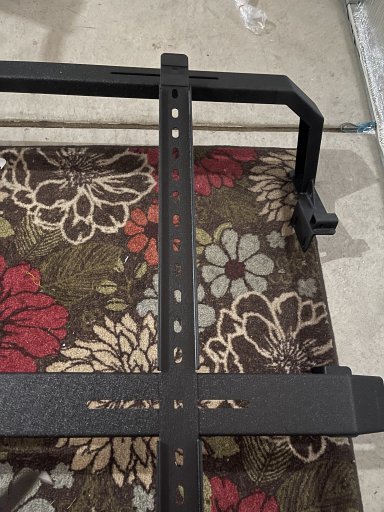

The packaging from the company is top notch, and I didn't find any damage that you sometimes encounter when shipping. The kit doesn't have instructions, but their website has a good PDF and a video for installation. The only thing is my included hardware had lock washers and nuts instead of the Nylock nuts you see in the pics/video. I think they could do a little better job on including some photos of the way the carriage bolts and carriage washers are supposed to be placed (and where), but it was pretty intuitive.

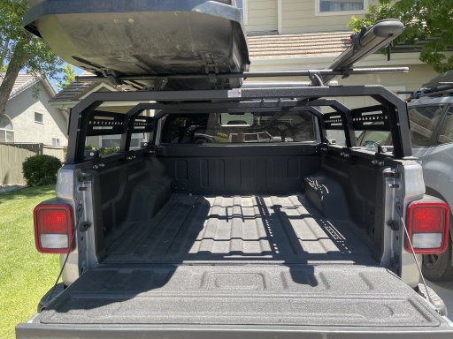

The system includes three cross members, two upper "flat" bars, and two side panels. I had previously watched a few install videos so I was fairly comfortable on what went where. I test fit the parts on the garage floor. In the photo the "flat" bar is actually sitting upside down as I was putting on the included padding where metal meets metal, but it gives and idea of how many potential mounting points there are. Additionally you can see the cross members have a slot so the upper bars can be adjusted depending on the width of what you have. You can also purchase additional upper bars which I would assume increase the rigidity of the system as well as having more places to attach things.
I didn't take photos of putting nuts and bolts together as it's pretty basic. It seemed to fit nice onto the Jeep.

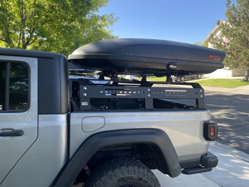

It might be hard to see, but I mounted my Yakima racks onto the upper bars. The holes on the upper bars allowed for the bolts on the Yakima base plates to mount without additional drilling. I made about 5" long plates for the underside of the upper bars from a 2" wide metal piece I had, and I used that as a sort of large "washer" for the base plates bolts to be mounted to.
At the front, and rear, of the bedrail you can see 1" square "mounting" points welded to the bases of the rack. The only thing it says in the videos is these are mounting points for future accessories. I'm assuming a bike mount along the side, or even something that goes into the bed. I could see using it for a mid level tray, or something similar.
At this point I've mounted my top box and one bike mount to the Yakima bars.
The top of the cargo box sits a little above the cab, but still aerodynamic.
The rack certainly gives me more useable cargo space, and it allows me to see out the back better than I could with the Yakima bed rack.

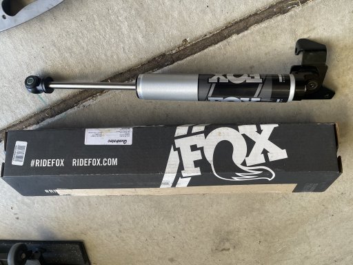

Game changer...That's really the first thing that comes to mind. Many - myself included - have experienced "loose" or a "wonder" in the steering of their Jeep. There have been posts about getting steering boxes replaced (some by a recall), or doing other more costly modifications, some with success, some not. I would have to say the introduction of this through shaft steering stabilizer has had an immediate improvement in the handling of the Gladiator.
The install was fairly easy. Tools needed were limited to a ratchet, 18mm socket, a 13mm ratcheting wrench, a hex head wrench and a torque wrench (I had one more tool that I'll discuss a little more in detail). The Fox stabilizer comes with a mount which replaces the factory mount. There are 3 - 13mm bolts. One of the bolts is easy to get to and the other two are a bit more tricky - partially blocked by the track bar. Adding to the adventure of getting tools in to the bolts (without removing the other suspension parts) is these two bolts have loctite so you need a little more leverage to break them free. I didn't have a long handle wrench, or a cheater bar, so I ended up tapping on the end of my ratcheting wrench a couple times which worked perfectly. Once they were spinning they came out fast just remember to stop using the ratcheting end and switch to the open end before you can't take the wrench off the bolt as it will get sandwiched against the bar. The 18mm bolt is a carriage bolt so all you need is to unscrew the nut (a tip - after you break the nut free you need to put a little pressure down on the top of the bolt as it liked to jump out of it's notch as you were unscrewing the nut). Prior to installation, the Fox mount attaches to the Fox stabilizer by two hex head bolts. Pretty simple. Installation of the Fox stabilizer took about 5 minutes, and most of that was just fiddling with the upper (passenger side) bolt as it was a little tricky holding on to everything with one hand and screwing the bolt in with the other. The final product looks good.
I did a quick lock to lock steering check to make sure the shaft didn't come into contact with any other parts. Afterwards, I did a short drive through the neighborhood, and I could already notice a "stiffer" feel to the steering.
Today, I did a mixed terrain 120 mile drive up into the mountains. The drive included 70mph freeway driving (some with considerable side winds), twisty paved mountain roads, and a short bit of mildly technical dirt roads. I have done this out and back (turn for turn) with the stock stabilizer (and with almost the same weather conditions), and I can say without a doubt the steering felt more planted to the road. Previously I experienced a slight "drifting", or "lightness", to the steering - especially in the side wind - and this was all but gone. I know part of the "drift" some experience can be attributed to the mud terrain tires/tire pressure, but I can say that all those factors were exactly the same with the stock stabilizer and the Fox stabilizer. I wasn't doing high speeds on the dirt/rocky roads, but, again, it was exactly the same with both stabilizers, and I found harder hits were minimized by the new stabilizer.
At $289, I think the results make this arguably the best bang for your buck upgrade. Of note: there is a "race series" Fox through shaft stabilizer with an external reservoir and a 24 click stiffness adjuster that is also a direct bolt on. At about $430 the cost is still pretty low, and it might work better for those who go a little more extreme than I plan on doing.
