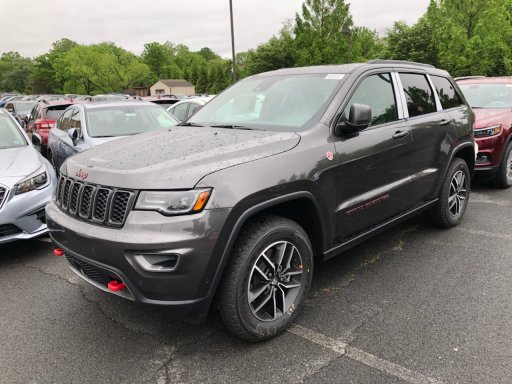

I am in much the same position, just picked up a 19 grand Cherokee trailhawk. I am looking at a gobi rack and tent as my first mods. Picture is from delivery day.
