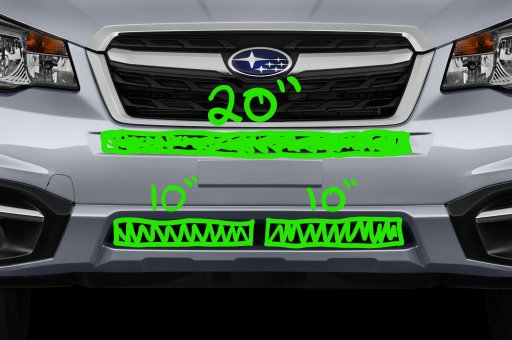

In case my intention wasn't entirely clear, this is what I'm hoping for :D
The reason I'm going with one 20" and two 10" bars is there is a vertical support bar in the center of the diffuser on the bottom of the grille (seen in the below pic).

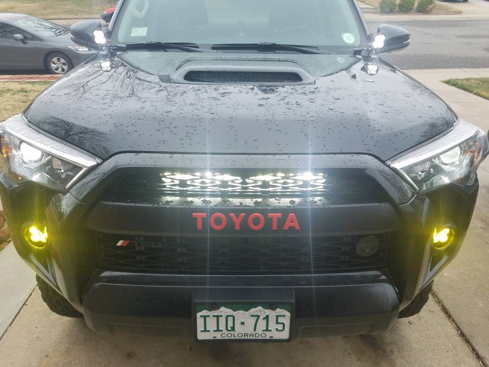

I just installed a 22 inch bar in the top grill, you can actually go as large as 24 with no issues in the top grill.
As for the bottom sections it still might be easier to go with a single long bar, the center divider will not really block out that much light.
Here is my current setup:

Awesome setup! A couple questions: Who makes your 22" bar? What were the outside dimensions of your grille opening (yours is an XT, correct?)
I'll have to take a look at the opening on mine and see whether I can mount the lights behind that center divider!

The top grill opening is around 26 inches. Not sure on the bottom one as it can't be used for light on the XT model due to an air sensor that XT has there.
The bar I got is http://a.co/21WKWiM One note when looking for a bar is to try and find a light bar with a single row of LEDS as you want to keep the height at under 2 inches otherwise a lot of will be blocked by the bumper.
