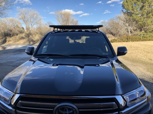

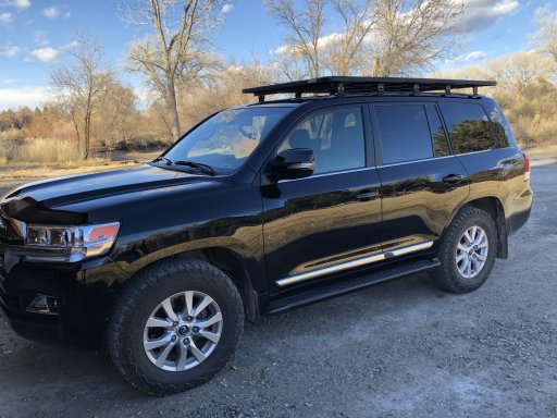

Next the rack.
Notice she has a haircut. That was an ordeal. BE VERY CAREFUL REMOVING THE STOCK RACK. SLOW EVEN PRESSURE ON THE TANDEM BOLTS . DO NOT GET AGGRESSIVE OR YOU ARE SCREWED. I.E. HEADLINER HAS TO COMES OUT TO REMOVE BRACKET ASSEMBLY IF YOU BREAK IT.
Those are the rails for the K9 rack. Ordered from Equipt1 from Paul May. I will post completion pics.
K9 2.2M x 1400mm Roof Rack System for Toyota Land Cruiser 200
First impressions
  • Its huge which I wanted. I have the Treeline Redwood RTT which is huge and will house a family of five. Those Pics and review to come.
  • Aluminum and rack is welded. Many threads on the K9 vs FrontRunner which is what I was torn between...
  • Had to bend the rails a bit to get to lay right. Dry fit first to be sure it will not bulge anywhere
  • Great build quality
  • Rock solid
  • Powder coat pretty good, not perfect but close
  • If you have OCD a bit of a pain to get it all centered and mounted
  • Wind noise is present at 70+. A slight whistle I am going to try and find...
  • All parts present, packaged well
  • Fits the 2017 LC200 perfect
  • OF NOTE, the little wing on the back roof does not allow for the table slide at this point. I think Paul is working on something for that but not sure... The frontrunner table slide I don't think would work either
I am not much of a writer so I will stop there. If questions let me know.

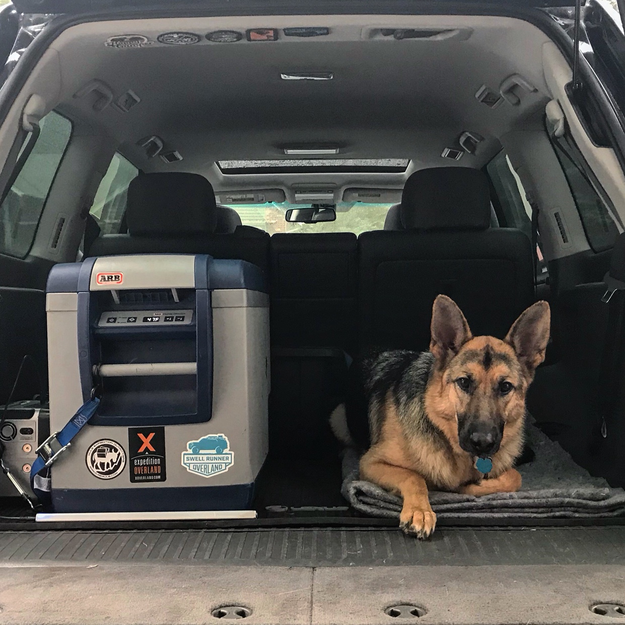

Will you be parked the whole time? If so, no. I’ve ran mine overnight (with the battery protection set to “high”) without issue.
I’ve since moved to a Goal Zero Yeti 400. If I’m driving a lot I’ll top off the yeti with the factory inverter. When parked I have a 100w solar panel on top.
You can see yeti tucked beside fridge
Panel mounted to factory cross bars
I ran an ARB 50 for 11 days continuously with this setup.

I'm curious why the rack needs 10 attachment points to the roof, seems like overkill. Is there increased wind noise without a deflector?
SWSteury
There is a deflector, solid aluminum. You can see it barely on the second picture. Yes there is some wind noise, but not as much as you think. Mainly hear it when get to 70+ mph. I wanted something super solid because of the size of the tent. May be overkill, but I like how rock solid it is. We'll see how it works out on the first trip.
