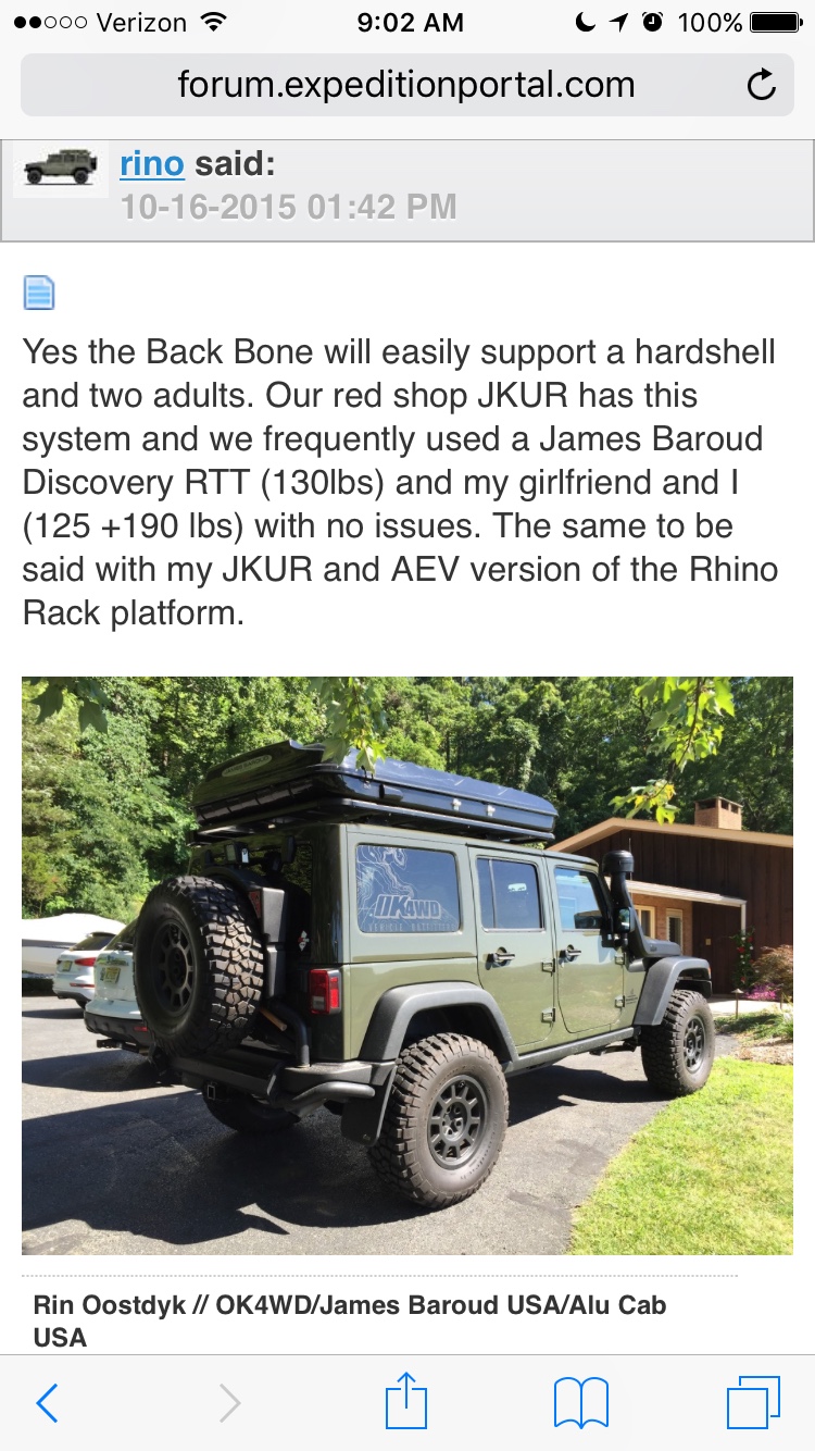

I have a rhino rack backbone kit with pioneer platform as you are considering. I have it mounted to a 2 door though rather than a jku. That being said the platform is very strong and able to support 800 lbs static to my understanding. From comparing the two it looks like the Maximus 3 rack uses their own mounting system, but borrows the rhino rack pioneer platform. AEV also has a rack where they mount a different way, but still use the rhino rack platform. I'm not as knowledgeable on the Maximus but on the rhino rack backbone kit the supports run down along the inside of the hardtop, I can post a photo or two if that would help as the rear mounts are the same. The disadvantage of this is if you decide to take the hardtop off, you can not mount the rack alone. The AEV has brackets that mount to the rollbar, and from what I've read on other forms it seems you can still mount the rack even if the hardtop is off. When looking at the photos of the Maximus 3 it appears similar to the AEV.
Now onto RTTs. The platform I have is smaller but I still plan to mount an RTT in the next few weeks. It's able to support it and many have done it before me. When I initially had this question I found answers on other forms that you can, and I believe all 3 of the tents you listed would work. I know some people said you may have to drill a hole or two I your platform to mount it but there are ways to avoid that. This is not my photo I found it on expedition portal, but it is an AEV rack with pioneer platform (looks almost identical to backbone set up from outside) with a James Baroud.
Appreciate the info! Done the research weight wise so I know both systems would support the weight without issue have seen how the frame sets up with the backbone and love that. Good info on the AEV/RR/Maximus differences will probably order the backbone and then snag a ladder from Maximus 3 as they have to mount up to the pioneer plat! Big thank you on the photo though! The discovery is 79" and doesn't seem to stick off the platform and look horrid or unevenly supported and that was my main concern with the RR.

I also have the backbone rack system and have had a a RTT mounted. When researching I found it to be the best for strength with a good low profile.
Have just hammered all 41 pages of this build after someone helped me out with the link on expedition portal. Man it is right up my alley as far as what I am looking to do and he even mounted the expedition 3 at one point for R&D so I am going to be getting ahold of Rin to discuss options and looks, as I do love his color matched JB and the shadowawn mount he is currently running. Initial buy might be modified now to be a RTT and roof rack with excess funds going to either the full 100% delete Goose Gear setup or full front bumper and winch. This will get me camping and able to stay on locations right off the bat and then the rest of the list I can pretty much purchase an item or two each month until the tire upgrade is ready and with that I think I will be going to the 4" OME lift now, Wheels and Tires, and the Poison Spyder fenders all in one go. Also considering going to the BP-51s now after reading Rins thread. I love the 3.5" on 35s look he has but he is also rocking stock fenders while I plan to go for the Poison Spyders and they are more of a high clearance look so the debate between 2" and 4" OME continues about as much as the RTT battle does.
