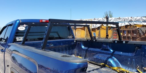

Haven't gotten a chance to start on my rocksliders yet, but I redid my bed rack. 1 5/8" superstrut from Lowes. Also started my DIY awning. Need to finish finishing touches and will post more pictures. Snapchat-943594839.jpgSnapchat-1090961274.jpg

Very nice, I want to make mine out of tube that ill have to bend and what hardware did you used to bolt it the bedsides
Currently its 3/8-18 x 1 1/4" ungraded hardware with a nylon lock nut on the inside. I was originally going to use nutcerts but the ones I have weren't long enough to grab the 3 layers of sheetmetal. The angle is 2x2 1/8th thick angle cut to 13 3/4" just cut what I had in half and thats what it ended up being. Can get you better pictures tomorrow if need be.
