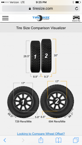

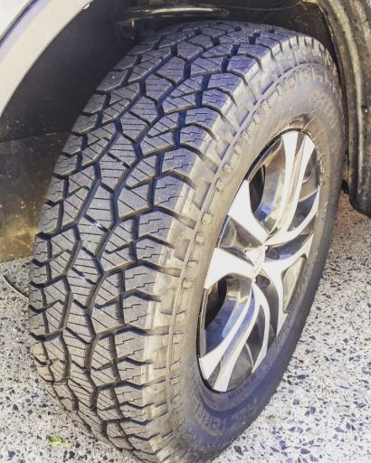

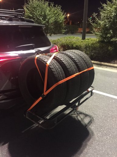

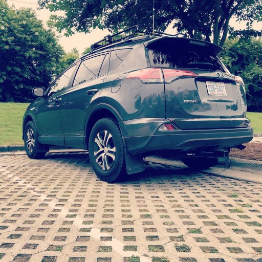

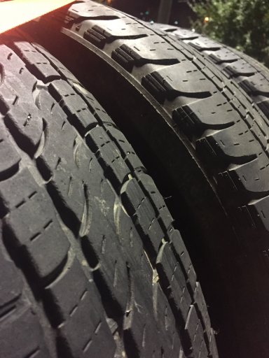

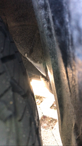

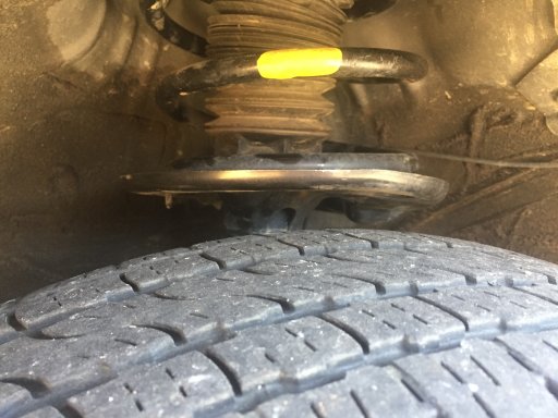

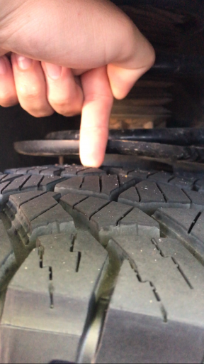

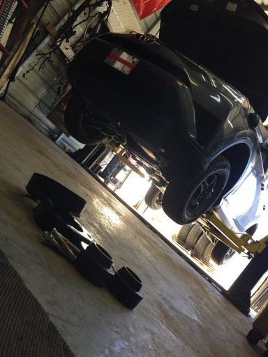

IMG_3010.JPG IMG_3017.PNG IMG_3008.JPG Picked up some tires tonight so after the lift I can install these and get a little bit more ground clearance. I didn't go to big and not with a aggressive tire than a A/T simply because I have to drive an hour to work 15 days out the month.

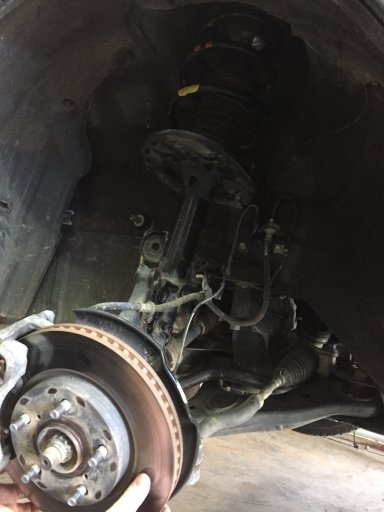

The lift is 40mm(1.5") in the front and 35mm(1") in the back. So total lift in the front will be 3" and in the back it will be 2.5" of lift. So nothing to extreme but inches can make a difference in many places will on the beach or trails. Plus I got a A/T vs a highway tire so that should help as well

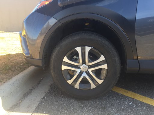

What size tires are those? I think I can fit 255/55/18 on mine without to much trouble. Trying to find a more aggressive tire but they don't make them in the stock size and I don't want to spring for different wheels. But I like where your going with this.
16rav4_project
1,163
Shelby,NC
the problem with running 18s is the ride. It won't ride the same as a 17s. The tires I bought the other night are 235/70/r17. Same rim size but a bigger tire. So the ride will be just as a good and I will have more ground clearance and a little bit of a wider tire. This 2018 RAV4 adventure they claim it rides higher but after I looked into it the rim size are 18s and the tires are actually smaller than my stock ones. Toyota still hasn't said what the ground clearance actually is. You can play it safe at 30.5 inch tall and 9.8 wide. No bigger or you will hit the strut. If you got any more questions. My phone is always by me and I get emails notifications. My Instagram is @j.rivenbark16 to see videos and pictures daily

Yes the car has to get an alignment done after the install. The caster will be off a little bit but it will be ok. The toe and camber will be fine though. Make sure you do not drive it to the alignment shop. Your camber and toe will be off too much and it will eat your tires up if you try
