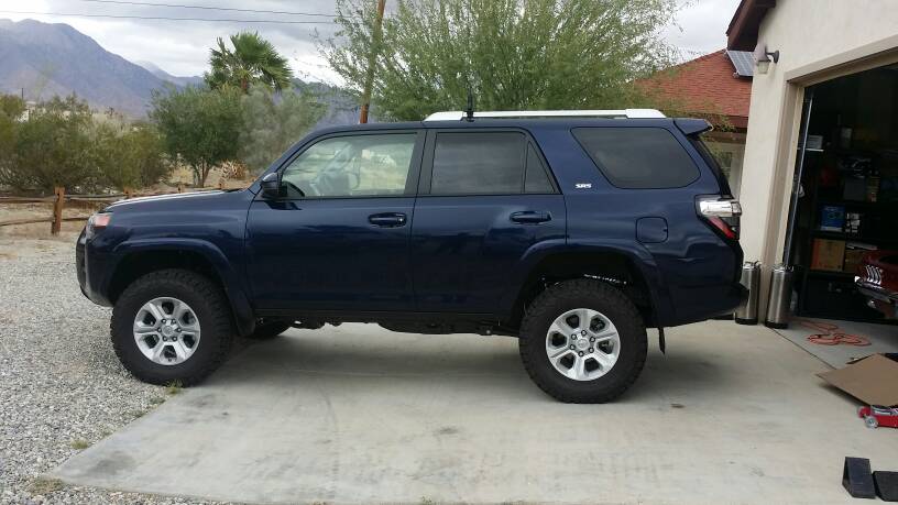

2016 trail no KDSS Bone stock 5th generation trail. Looking for lift and new tire setup. I don't want to do any cutting to body etc .
Thanks
Leo
I have some BFG Ko2, (275,70 R17) great traction and no rubbing. Bilsteins 5100 adjustable (2.5" lift) in the front and a 2" spacer in the rear. I plan on adding lots of weight in the rear (camping gear and sleeping platform) so in the end, it should sit pretty level.
Sent from my SAMSUNG-SM-N900A using OB Talk mobile app
Awesome!! Thank you for the information. Looks great .
